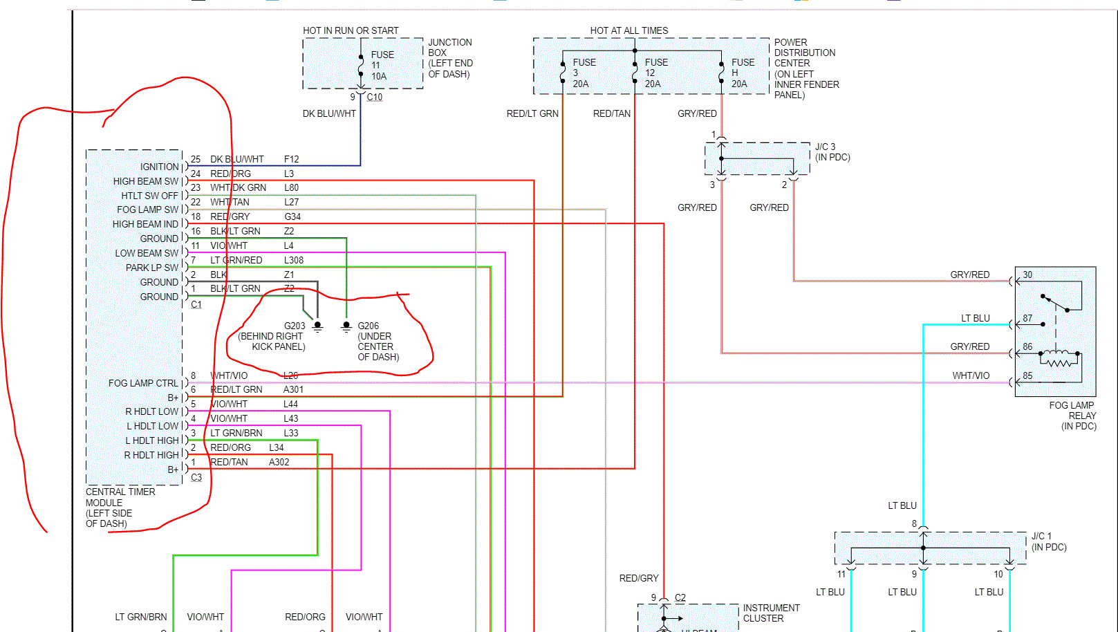

That's an interesting one. I read through the wiring schematic and the only thing I found that could be related is either a bad ground under the dash or the central timer module.

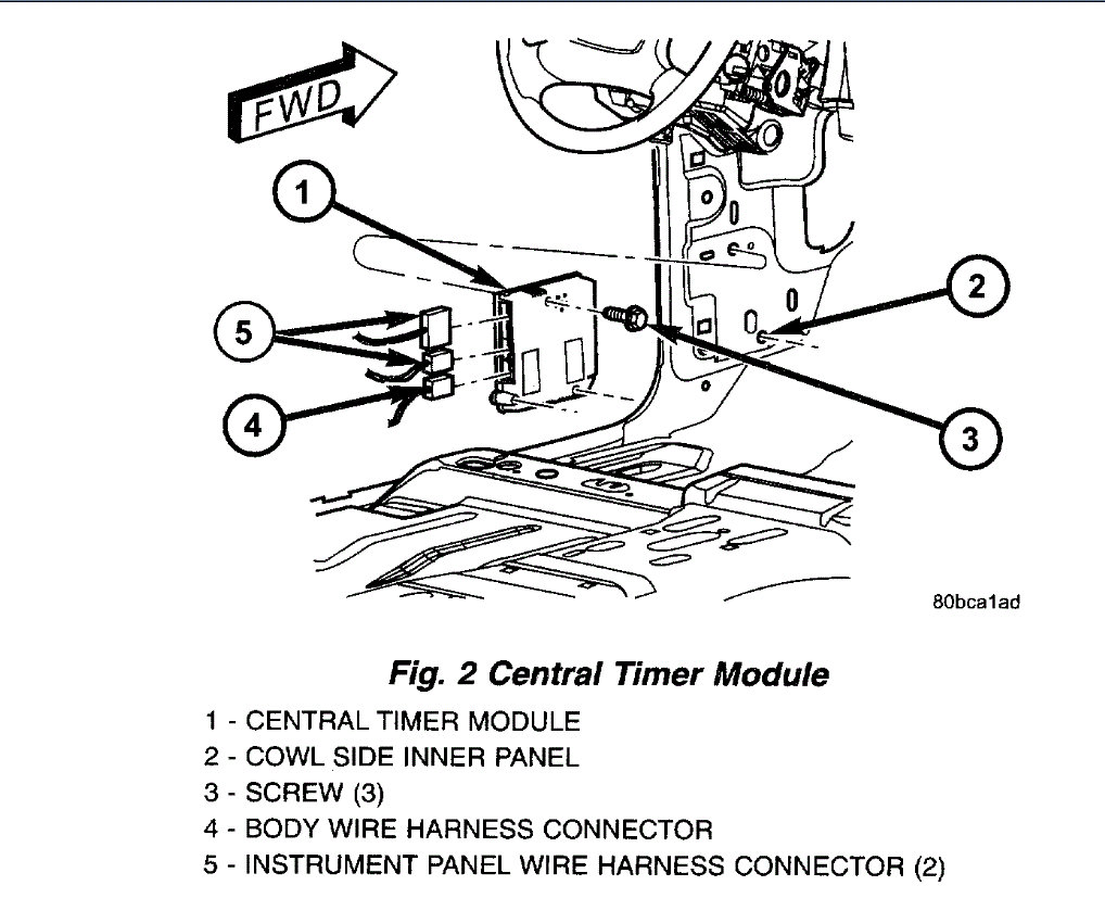

The module is under the dash on the driver's side. The grounds (three wires) are also under the dash. I attached a pic for you to see what I am referring to. First, make sure the connection at the module is tight and in good condition. If it is, confirm the grounds are good as well.
Also, picture 2 shows the location of the module. And yes, the door chime is tied into this module as well.
Let me know what you find.
