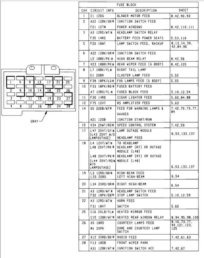

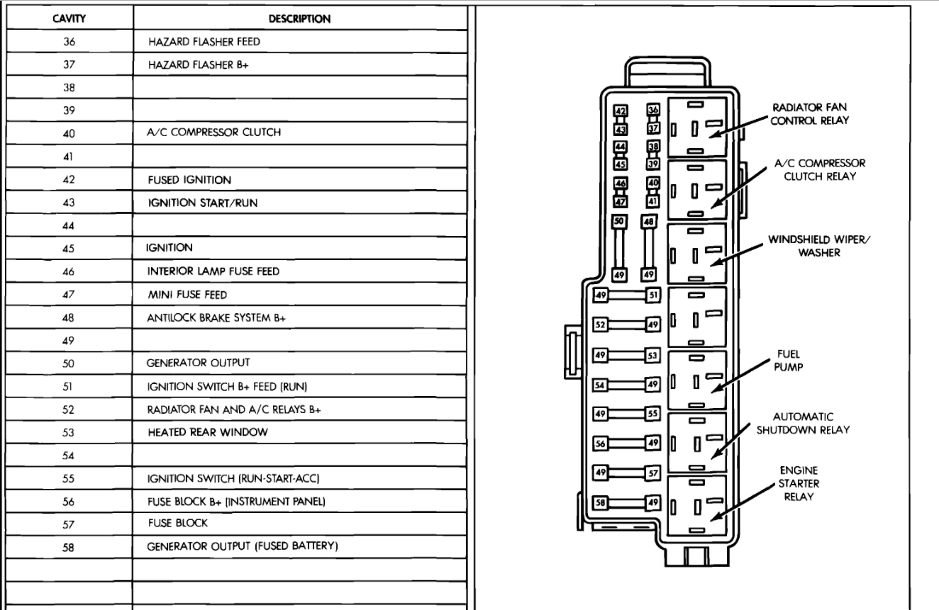

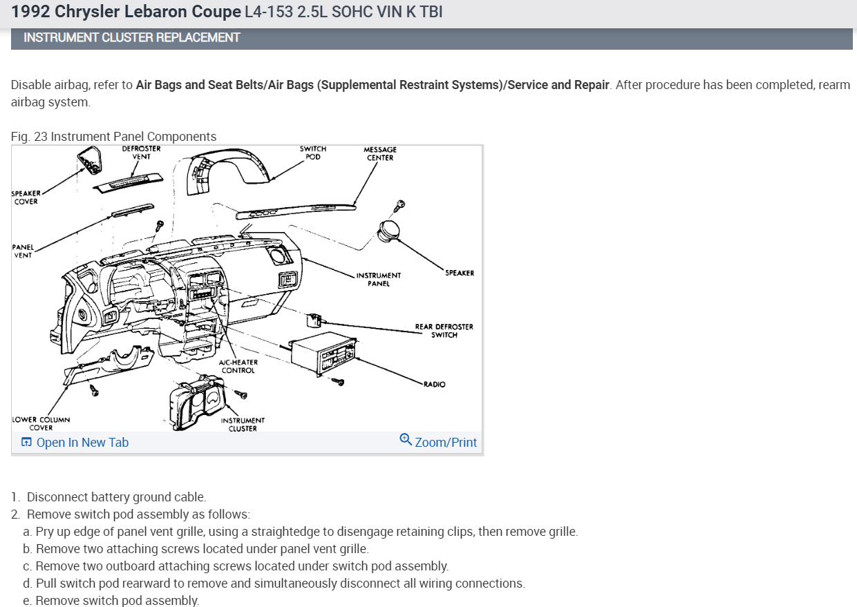

This can happen when the dash cluster shorts out, but we should check all fuses and then run the codes. here is a guide to help and I have left cluster replacement instructions in the diagrams below just in case:
and
https://www.2carpros.com/articles/retrieve-trouble-codes-for-chrysler-dodge-plymouth-odb1-1995-and-earlier-car-mini-van-and-light-trucks
