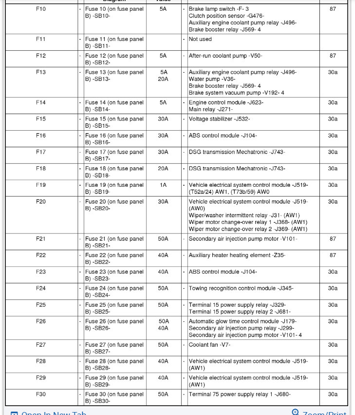

Left rear boot lid lights not working, all fuses are okay. 3 Single bulbs tested and 100%. on the right side all working. Central locking. Car not always locking with remote on driver side " right hand drive " Using the key in the door to lock ! Please help with both.
