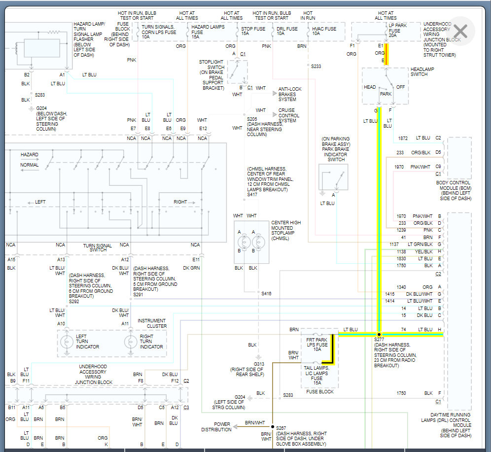

A while ago my odometer lights and tail lights quit working at the same time. I tried changing the fuse and it work for a few days and then quit again, this time the fuse isn't broken. They're just not working anymore and I don't know what to do. Suggestions?

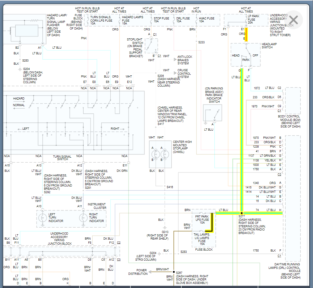

I assume you replaced the LP Park fuse in the fuse block under the hood?
If that is the case then that brings a couple other things into play which are the head lamp switch and the daytime running module.
Please see the wiring diagram below for more detail on this. Let me know what questions you have and we can go from there. Thanks
