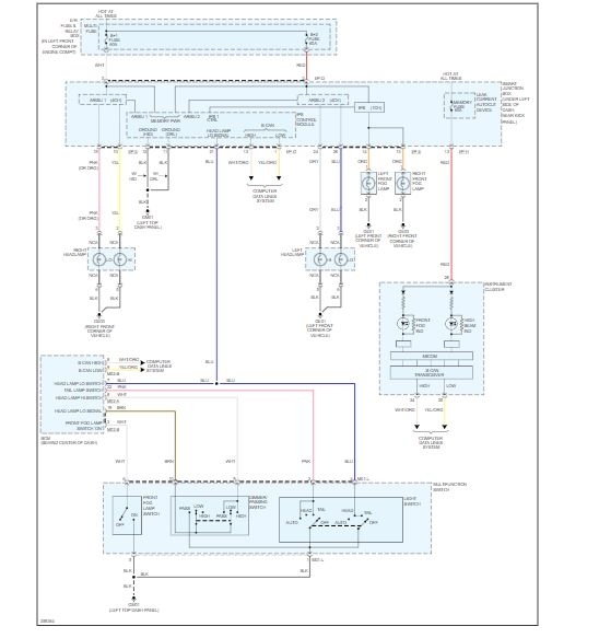

One week my headlight was burned out then following week both brake lights out and now both headlights and brake lights are out. I have checked both fuses and the bulbs only one headlight bulb is burned out. Fuses okay.
Sep 3, 2019 at 9:52 AM
Good afternoon.
The first thing I would do is check the charging system. If the alternator is putting out too much voltage, it will burn out headlights and other bulbs.

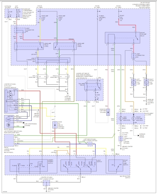

As far as the lights, have you checked for voltage to the headlights?
I attached a wiring diagram for you to view. Check the highlighted wires for power with the headlights on.
You may have a failed smart junction box.

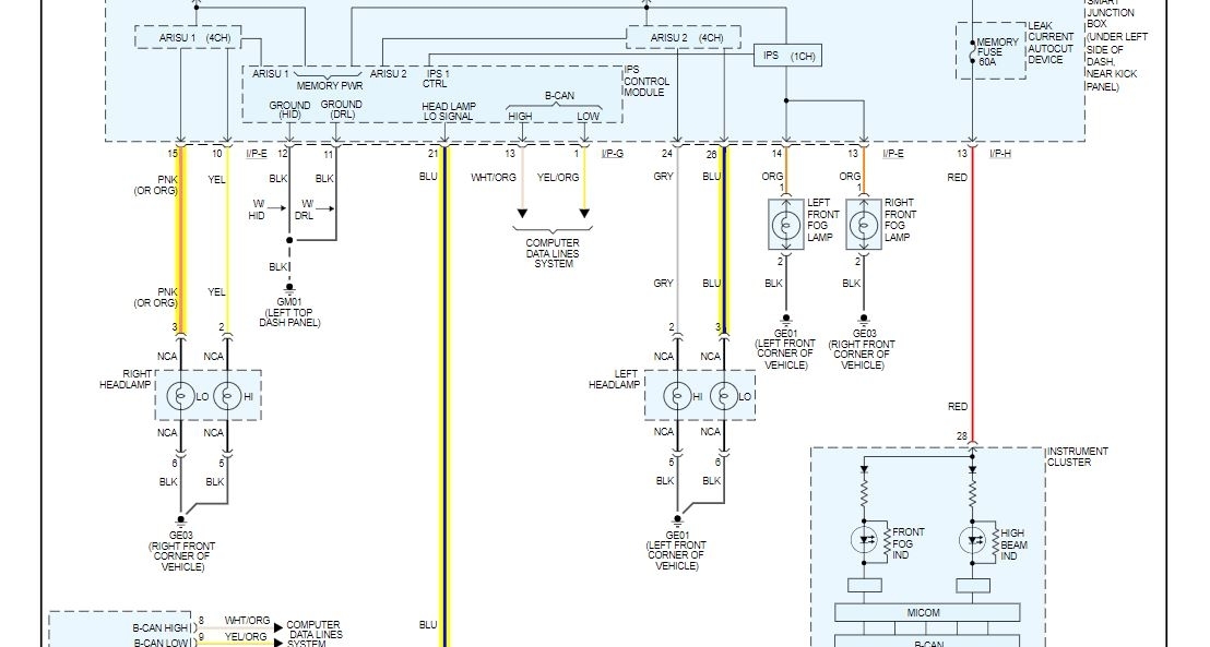

Hey Tony,
I found this wiring diagram for you, please do some testing and get back to us.
Here is a guide that will help
Let us know hat you find.
Best, Ken

Here is a diagram of the relay box. Swap E48 and E51 and if the low beams comes on and High beam goes off, the relay is bad. If both works now, check the terminals of the low beam for looseness and signs of overheating. If none found, replace the low beam relay, it is failing and intermittently bad.

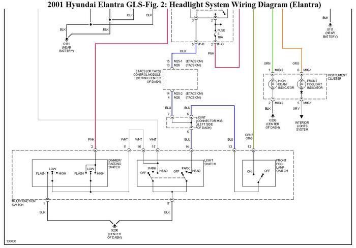

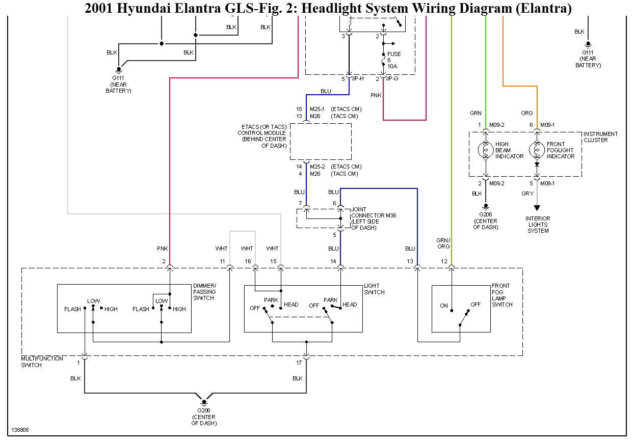

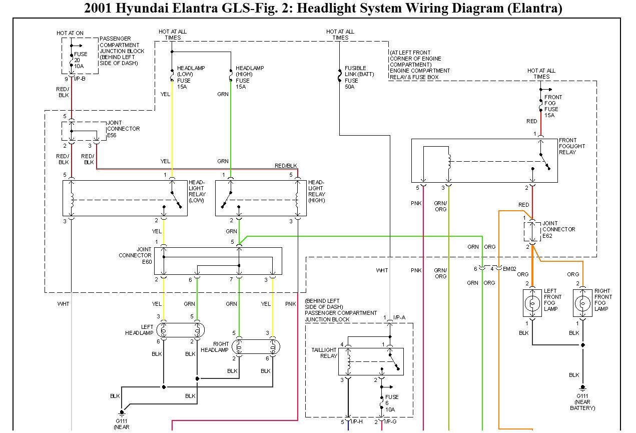

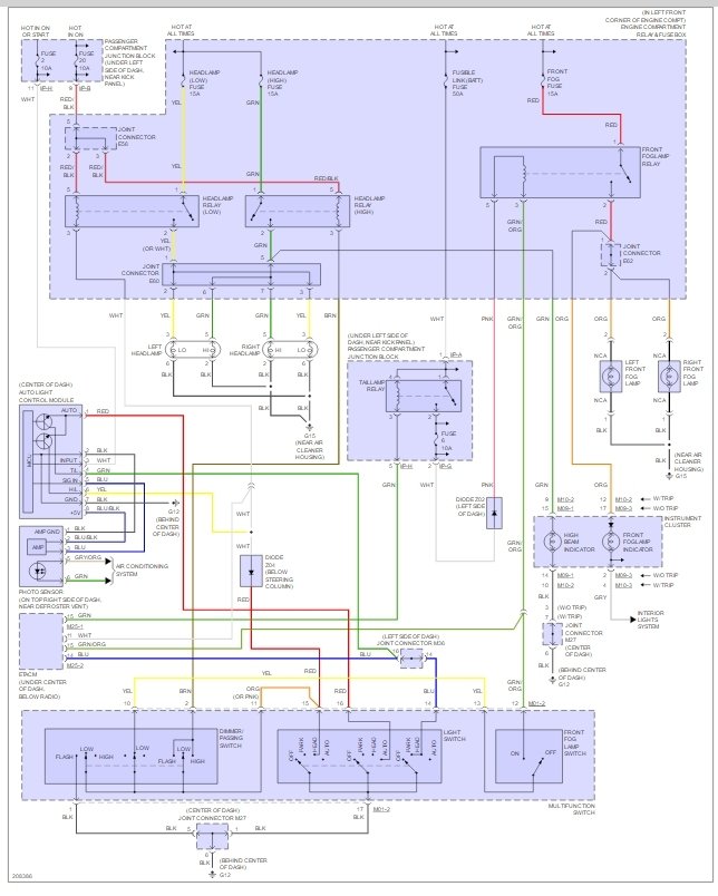

hello my high beam and low beam lights wont work. i had the fusses checked and the bulds checked and everything was good. we did find that there was no power going to the headlight. what could be the problem?
Oct 10, 2020 at 7:22 PM (Merged)
KHLOW2008
  • 41,814 POSTS
Power to the bulbs are via the headlight relays as shown in schematic. The relays are activated by the light switch and you need to check the various fuses, ensure the relays are being activated when the light switch is turned on.
Use this guide to check for power with the wiring diagrams below for the headlights.
Check out the diagrams (Below). Please let us know what happens.
