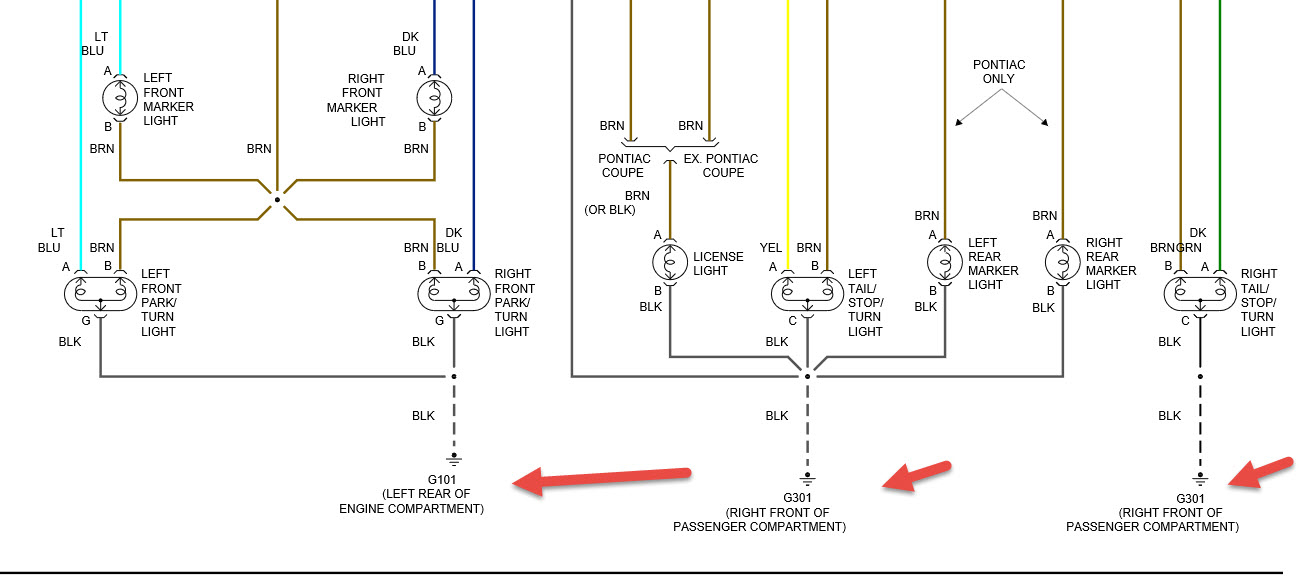

I payed 1000$ for a 1996 cavalier
my brake lights work when I push the brakes but when the headlights are on they only work whenipush the pedal?

WADEG1000
my brake lights?
the lights work when I press the pedal but don't get brighter when i push it when the head lights?

HMAC300
  • 48,601 POSTS
check grounds in pic then check headlight/hazard/turn signal switch as it's all one
