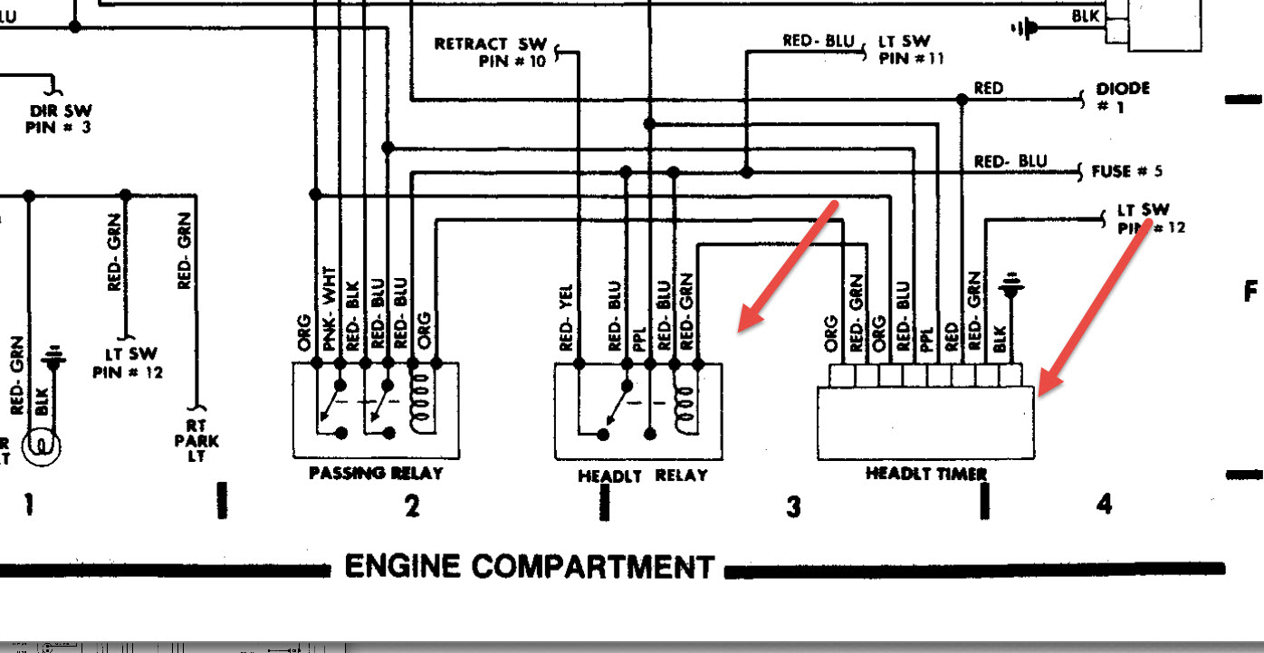

I can turn my lights on but when I get ready to turn them off they stay on.

check the two items in picture under hood then check for a bad headlight switch, but probably the timer.
