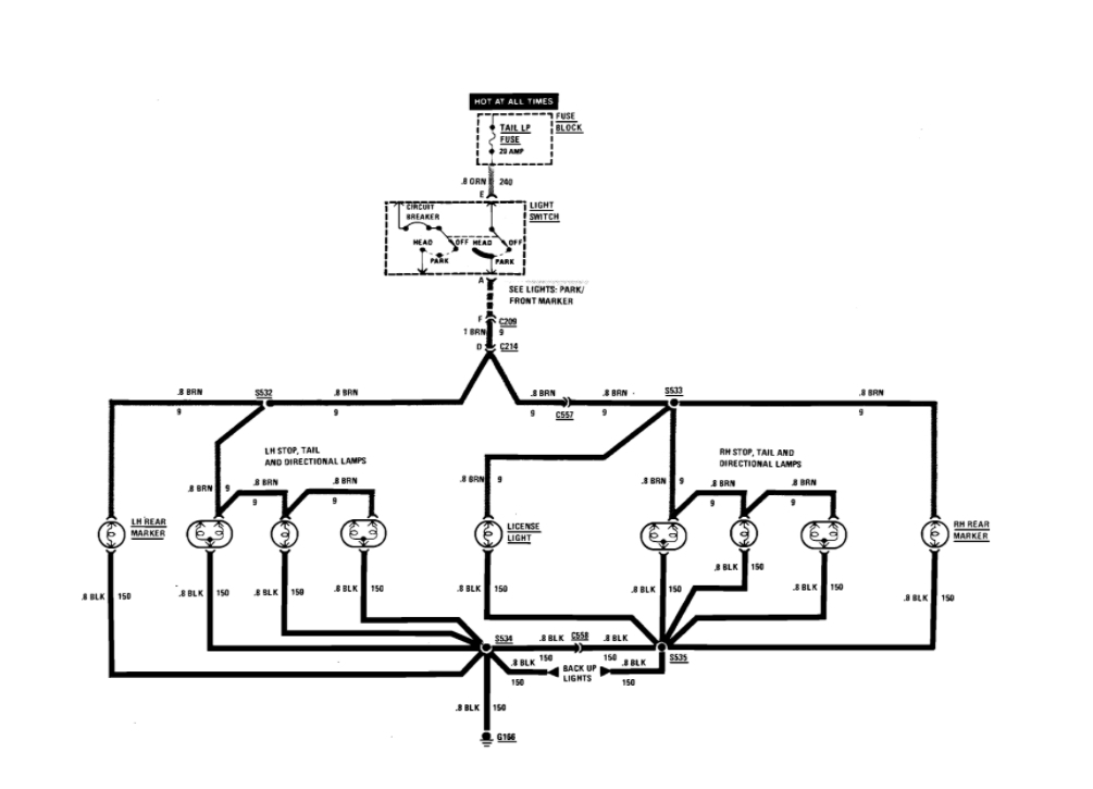

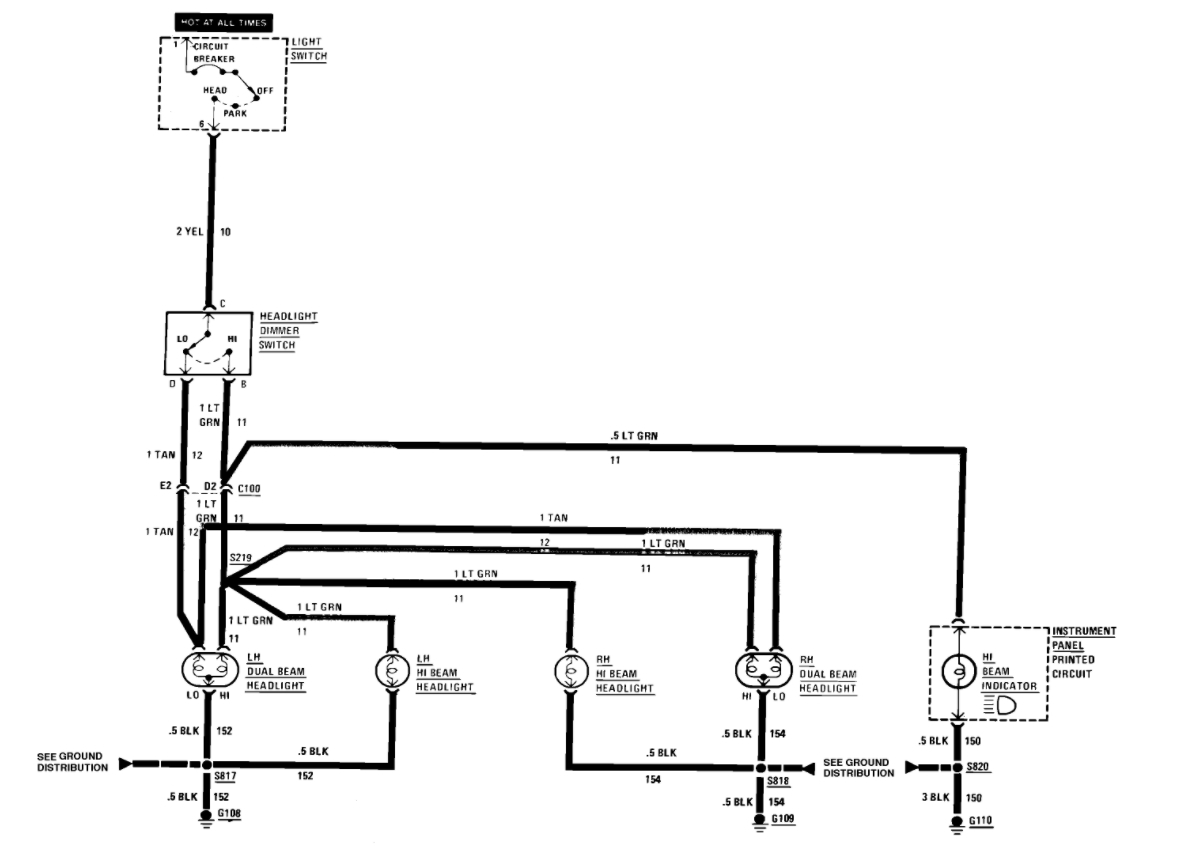

Are the head and tail lights connected by same wire?
Jan 12, 2021 at 6:23 PM
STEVE W.
  • 15,113 POSTS
Not on that car. The tail lights have a different power feed, the only part they share is the headlight switch itself.
Jan 12, 2021 at 9:54 PM
Here is a guide to help you check the wiring with the headlight and tail light wiring diagrams so you can see how the system works:
