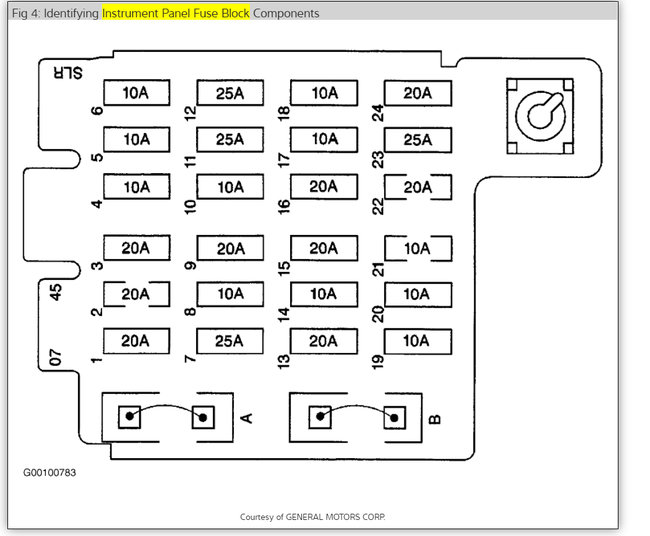

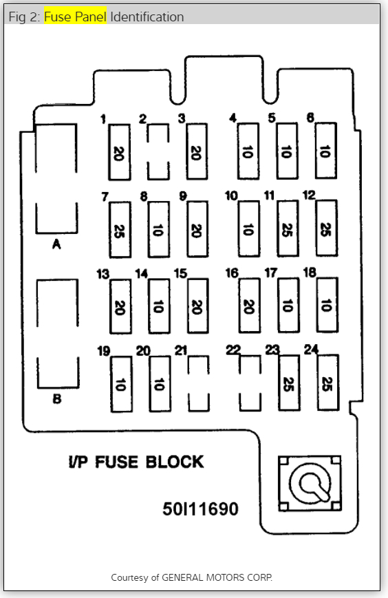

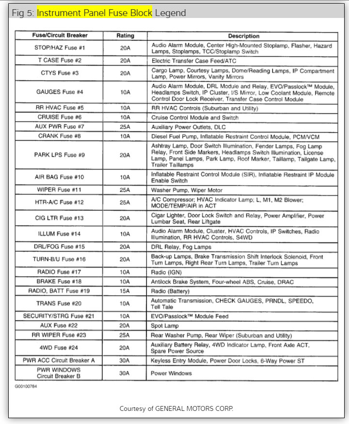

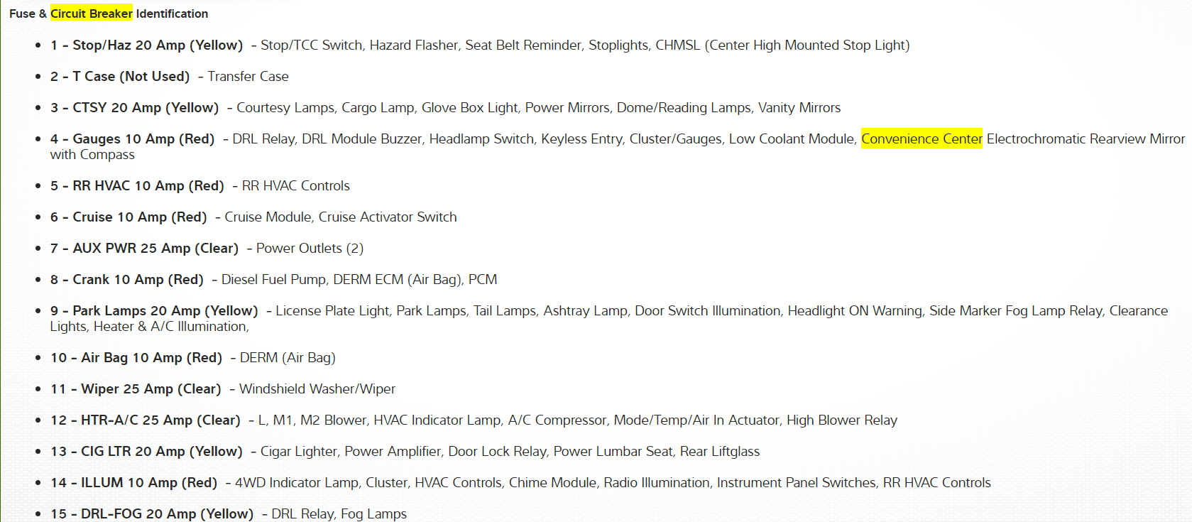

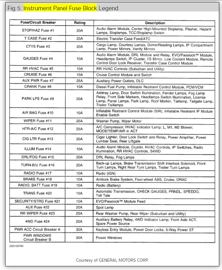

Are you sure you are looking at the correct fuse? It is the fuse "park lps" #9 in the I/P fuse block and it should be hot on both sides of that fuse with twelve volts all the time.
Dec 26, 2017 at 2:59 PM

yes fuse #9, is not blown. will check for voltage in the morning and update.

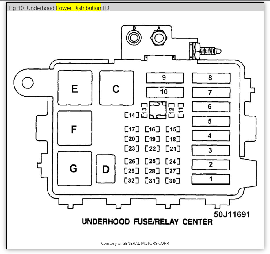

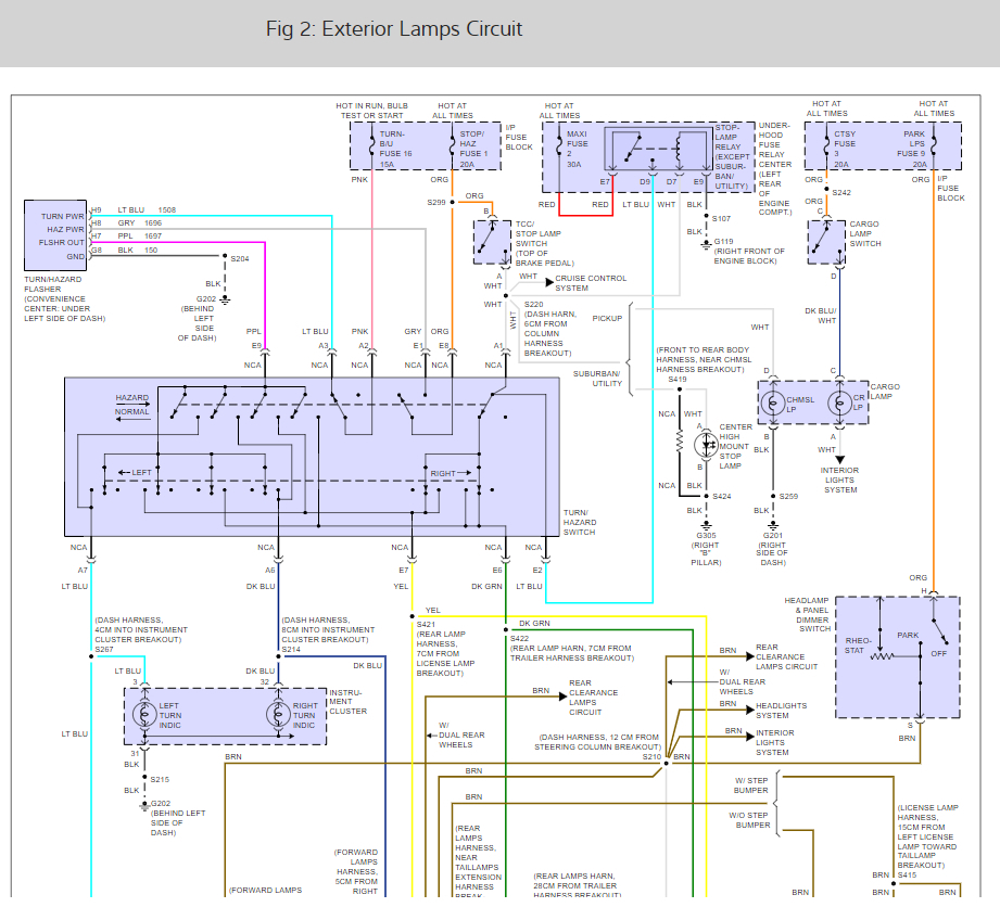

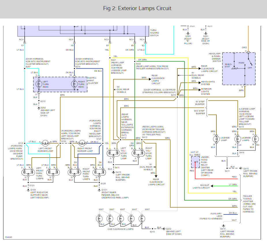

Here is a guide and the running light wiring diagram so we can test to see where we are losing power.
Dec 31, 2017 at 12:58 PM

Tested power at fuse box, it's getting 11.72 volts. Fuse not blown, but lights still do not come on
Jan 6, 2018 at 12:16 PM

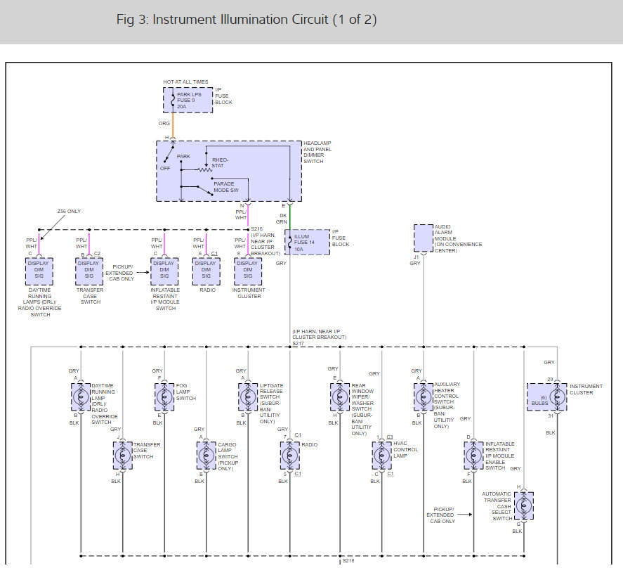

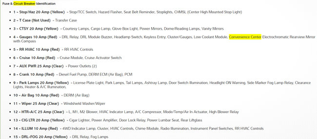

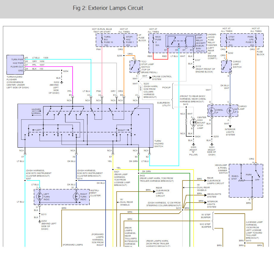

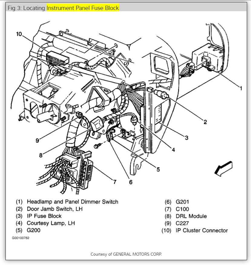

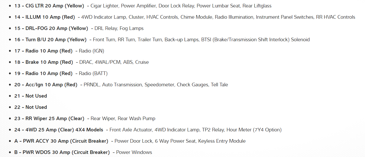

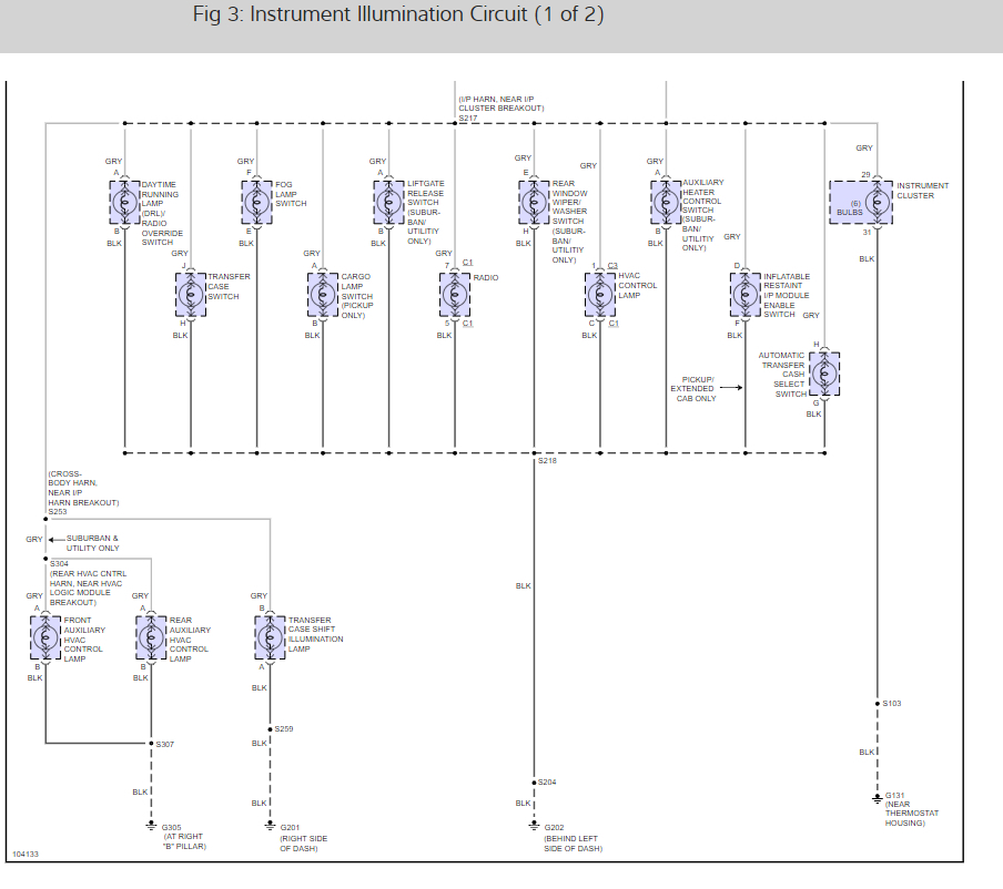

Can you please check for power at fuse #9 and #14? Here is the wiring diagram for the cluster we must be losing power somewhere.
Jan 6, 2018 at 12:21 PM

fuse #9 shows 11.72 volts, bout to check fuse 14 now
Jan 6, 2018 at 12:23 PM
CSA1
  • 78 POSTS
0 volts at fuse 14,

Hi guys. Look at your old switch to see if two terminals are black or overheated. If they are, the mating terminals in the connector have to be cut out and replaced individually.
The voltage missing on fuse 14 comes through the dimmer portion of the switch assembly. (Be sure the switch is turned on when you're checking for that voltage on fuse 14). Since that is missing, you will find it's also missing on the brown wire at the switch connector. That's the wire that feeds the tail lights. We know both the tail light and dash light circuits aren't going to develop their own problems at the same time. Instead, your old switch is defective and the new one is the wrong part, or there's a break somewhere in what they have in common. That is the orange wire at the switch.
Check for 12 volts on that orange wire. If it's missing there, that wire has a break in it, either inside the fuse box, or at the terminal in the switch connector.

The tail light circuit does not pass through the stop lamp switch. That orange wire for the tail lamps (park lamps) goes from the park lamps fuse #9 to the headlamp switch and it is not the same orange wire that goes from the stop/haz fuse #1 to the stop lamp switch.
You know of course you have to have the light switch on before checking that fuse #14 for voltage and also when testing fuses for voltage you have to test both sides of the fuse.
I think you have a bad headlights switch!
