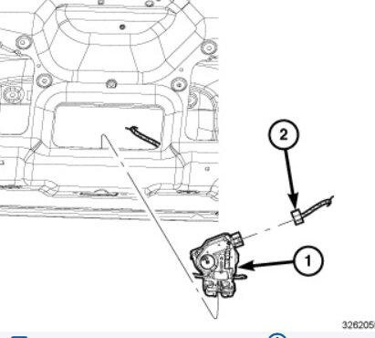

If you get a code for it here is the location of the latch and how to change it out. Check out the images (below). Please upload pictures or videos in your response.
