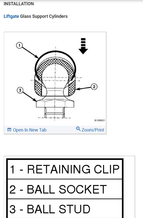

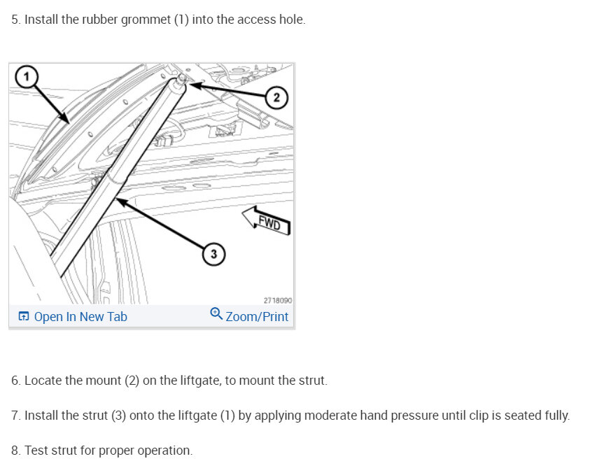

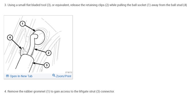

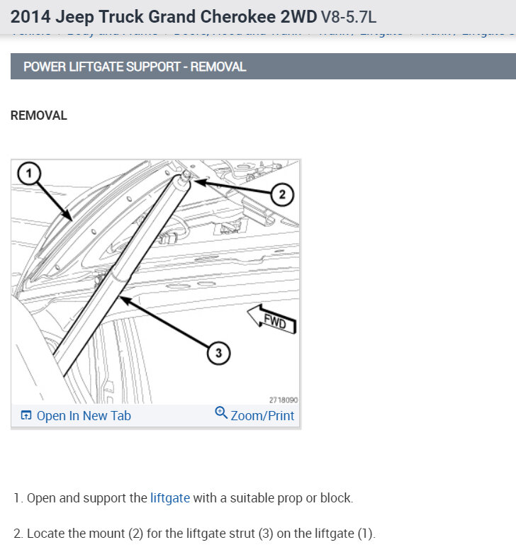

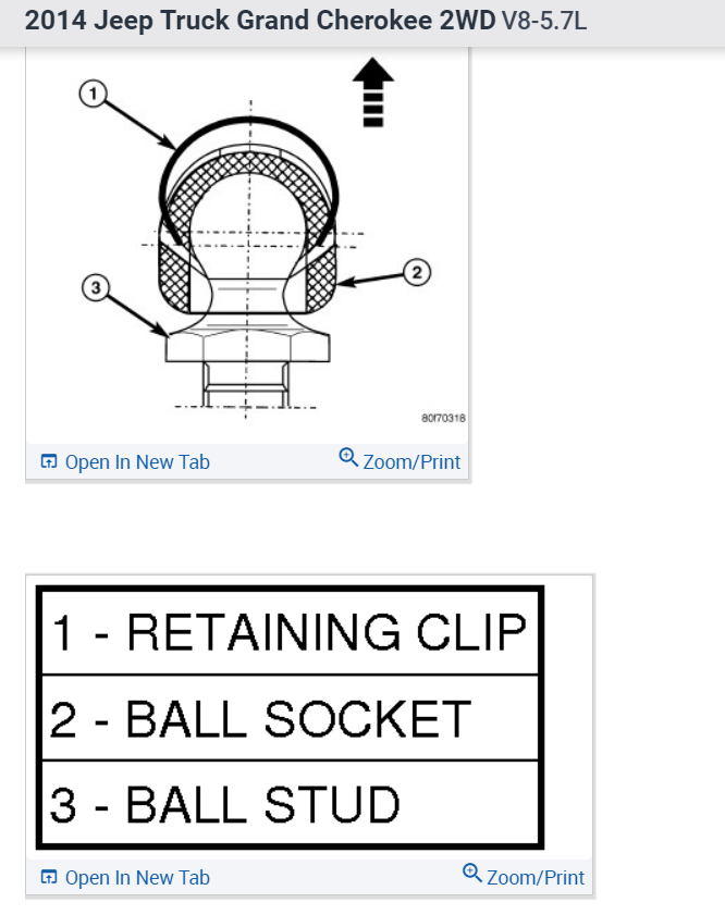

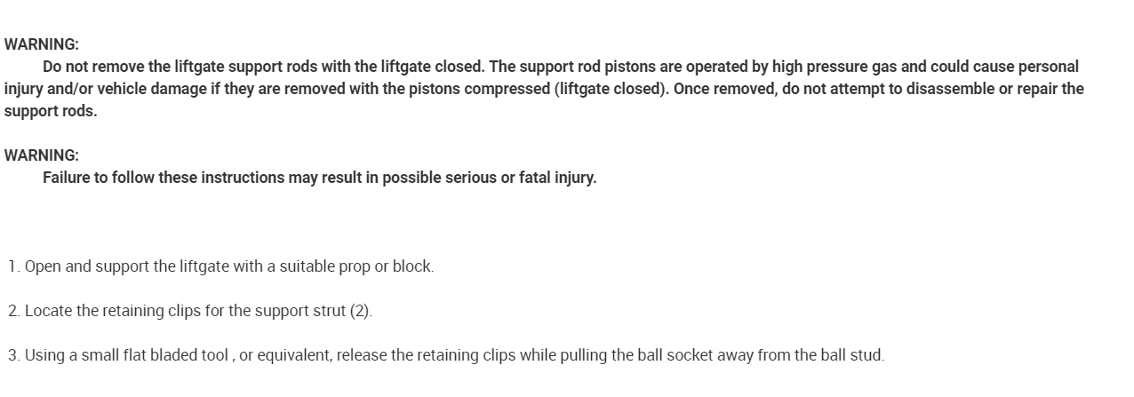

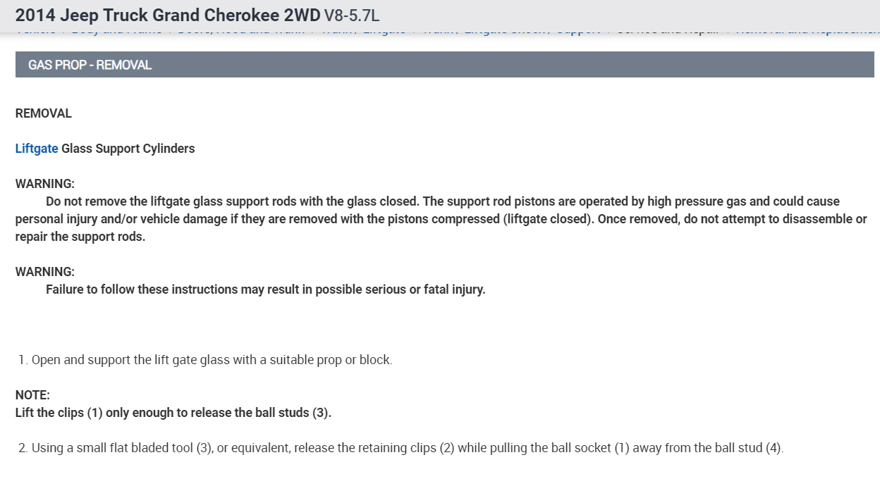

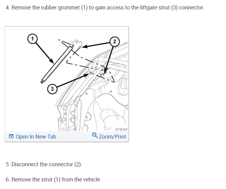

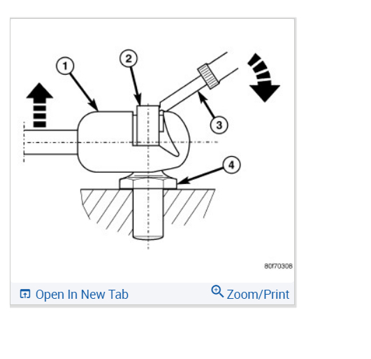

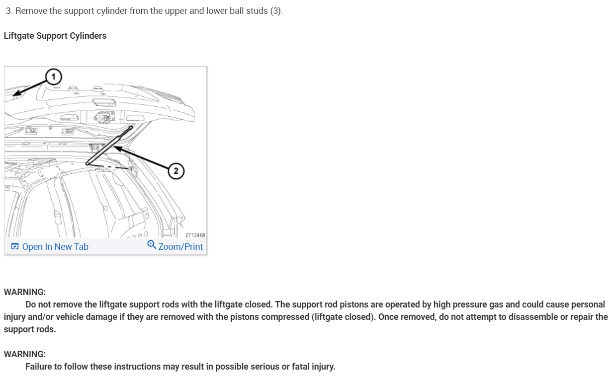

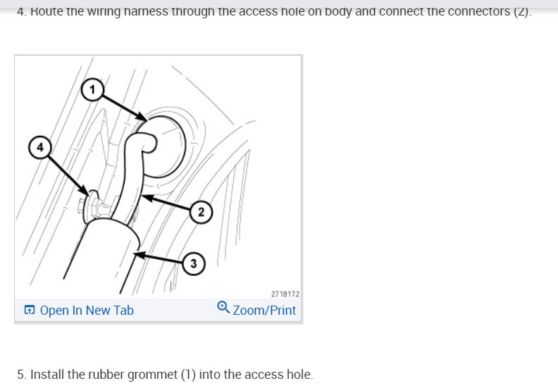

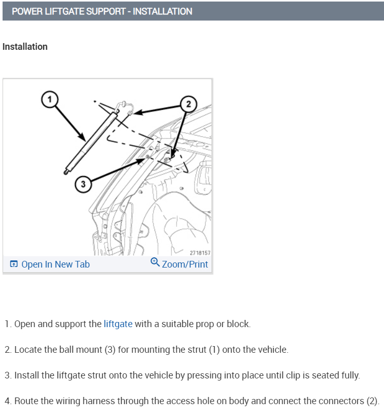

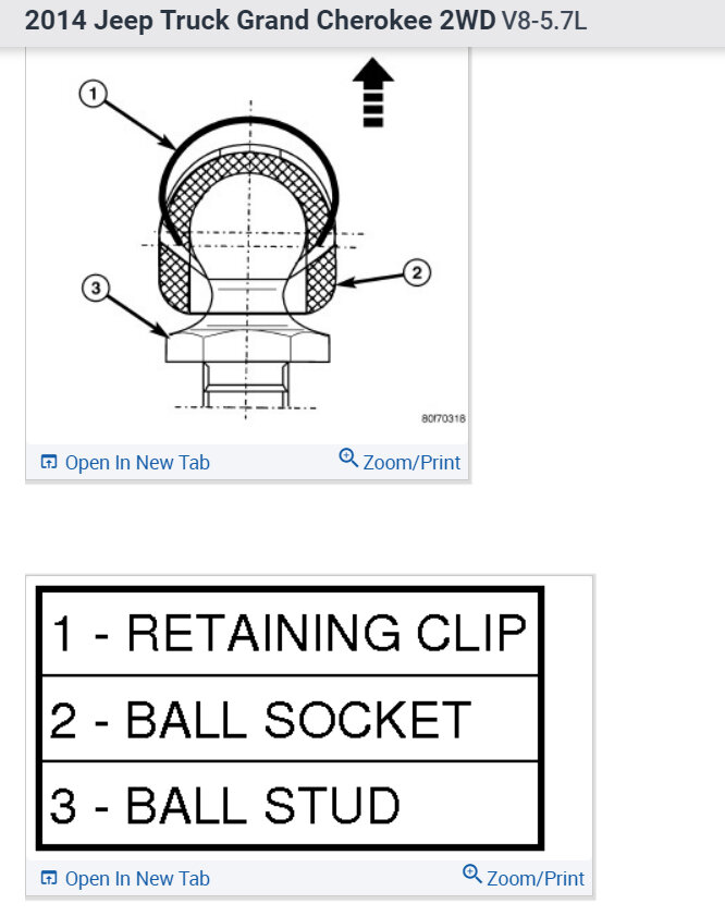

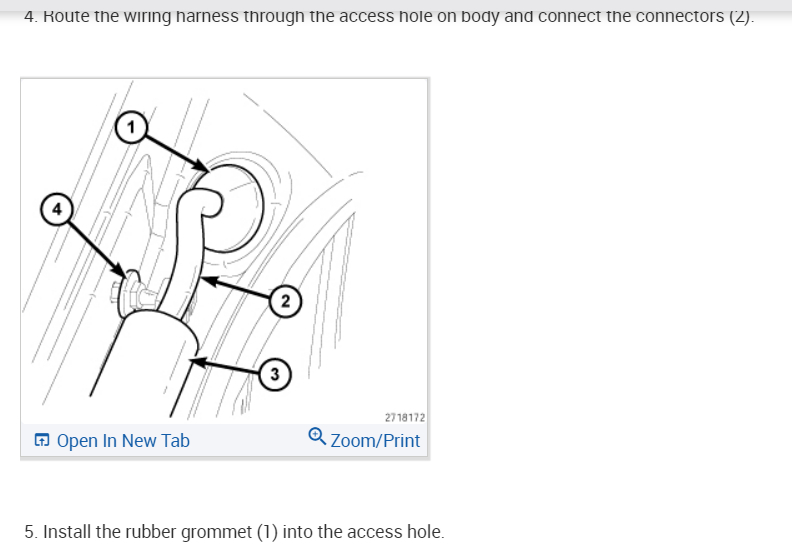

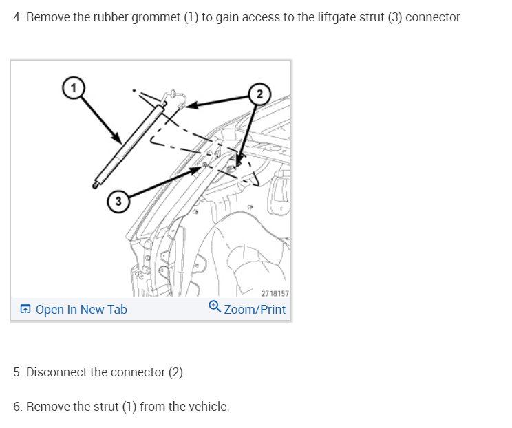

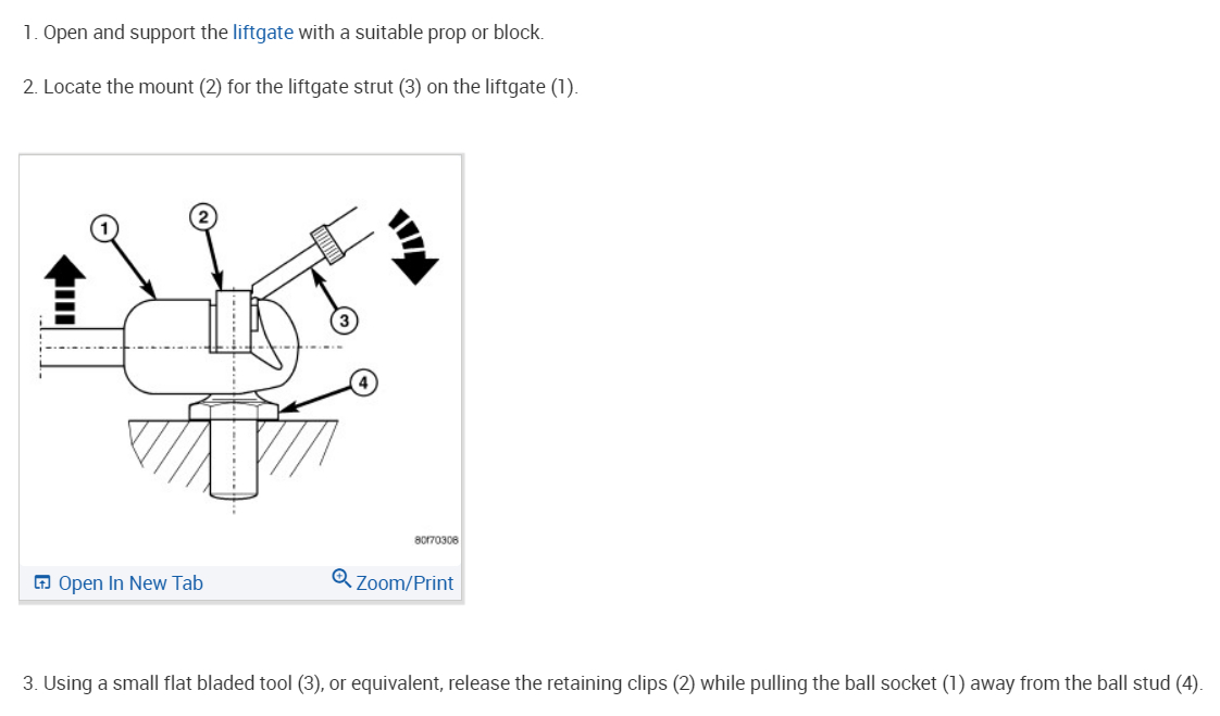

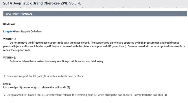

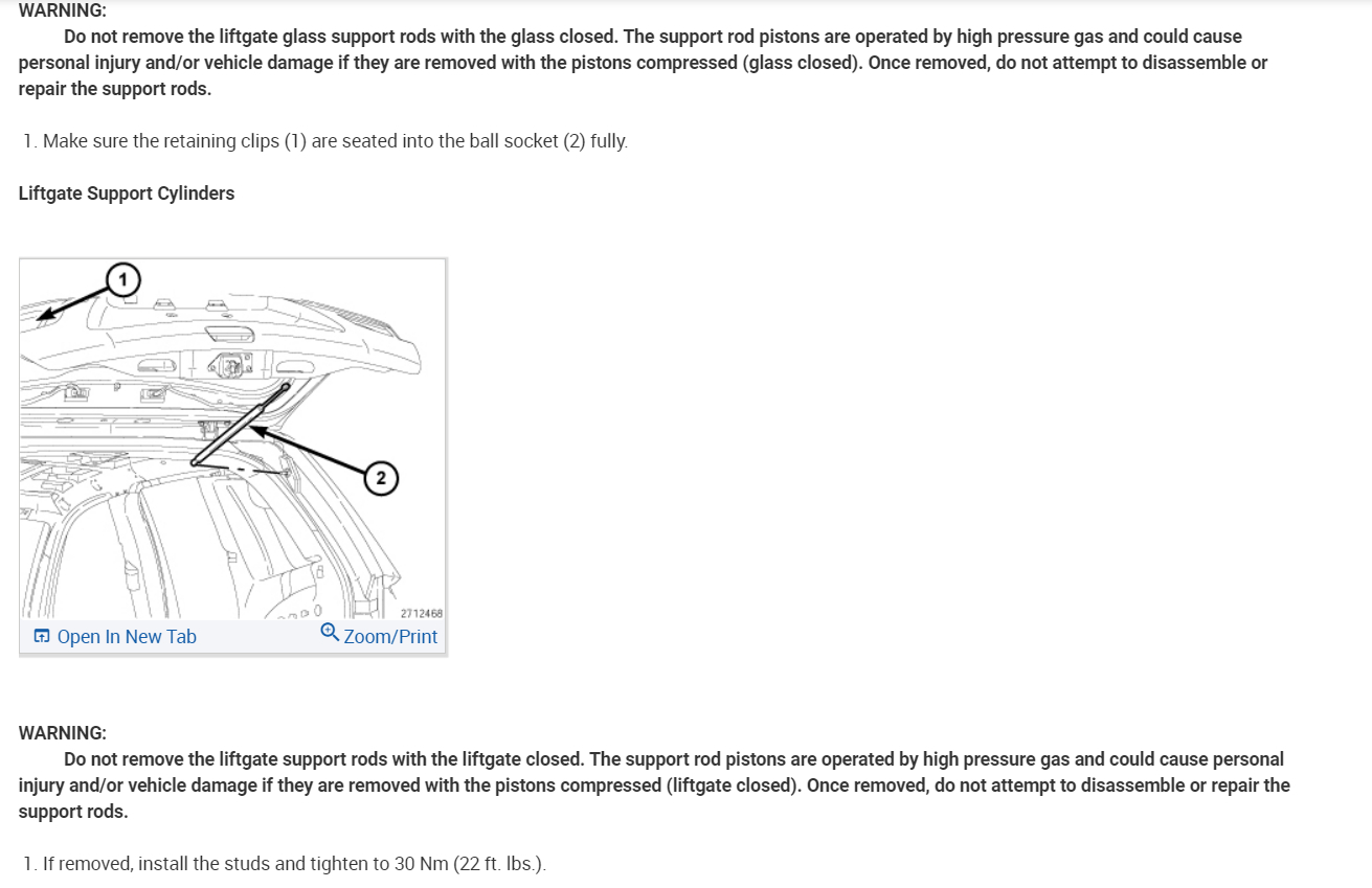

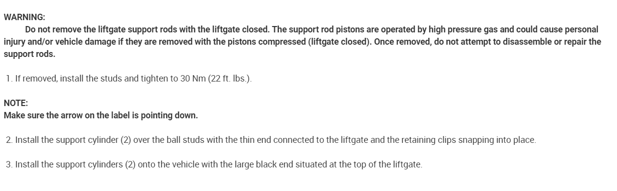

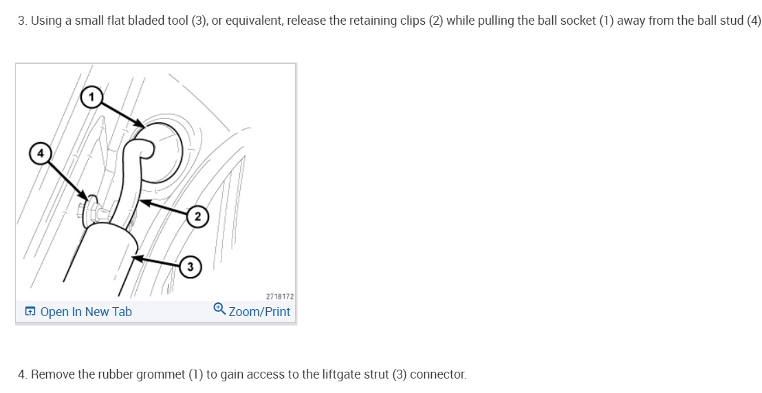

So, this happens when the gas lift shock and power lift shock goes out, I would do the gas shock first because it is cheaper. Here is how to change the two out. Check out the images (below). Let us know what happens and please upload pictures or videos of the problem so we can see what's going on.

Did not address my problem at all and was not for my make and model of car a 2014 jeep grand Cherokee.
Aug 24, 2023 at 6:40 PM
the instructions even say 2014 Jeep Grand Cherokee? what was wrong can you upload a short video so I can see?
