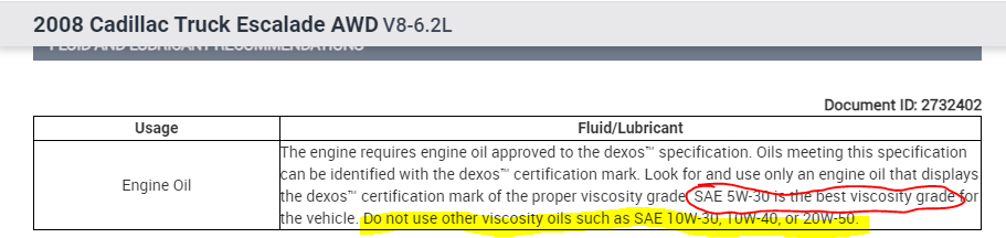

Also, using the wrong oil viscosity can cause similar issues. The vehicle requires a 5w30 viscosity. Other weights are not recommended. See pic below.
Let me know if the pressure has already been tested and if the correct viscosity is being used.
See pic below.
