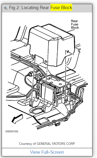

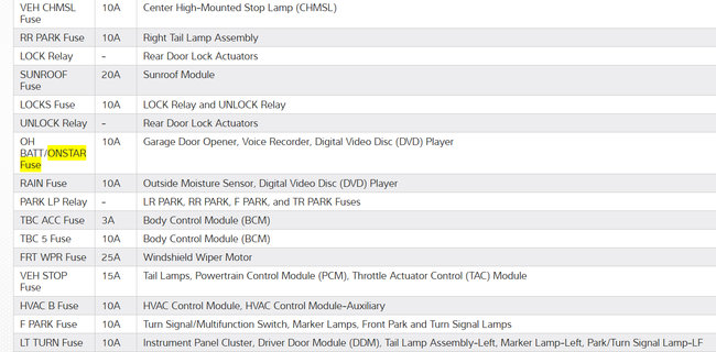

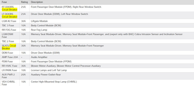

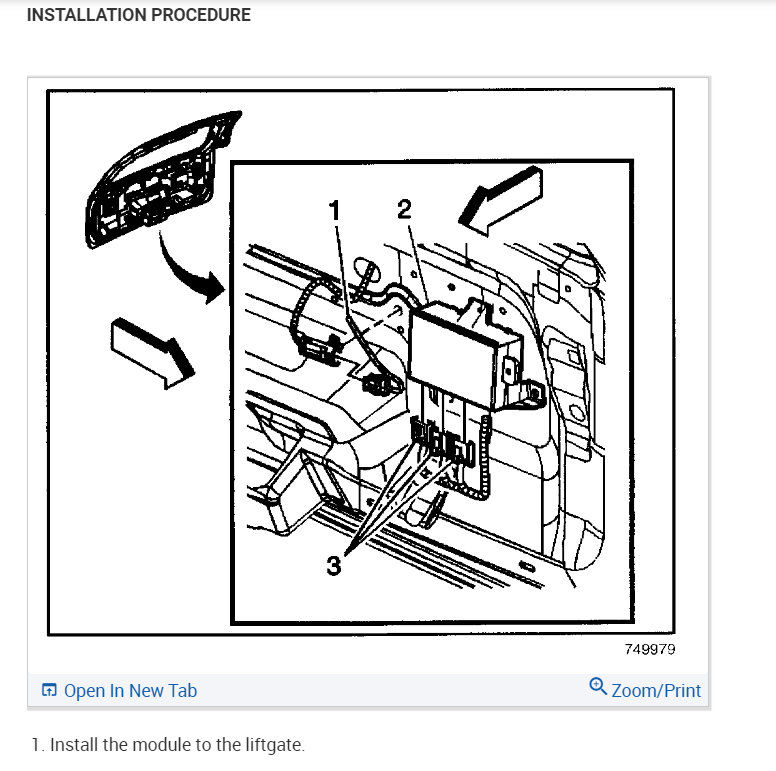

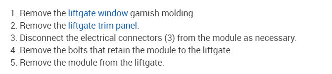

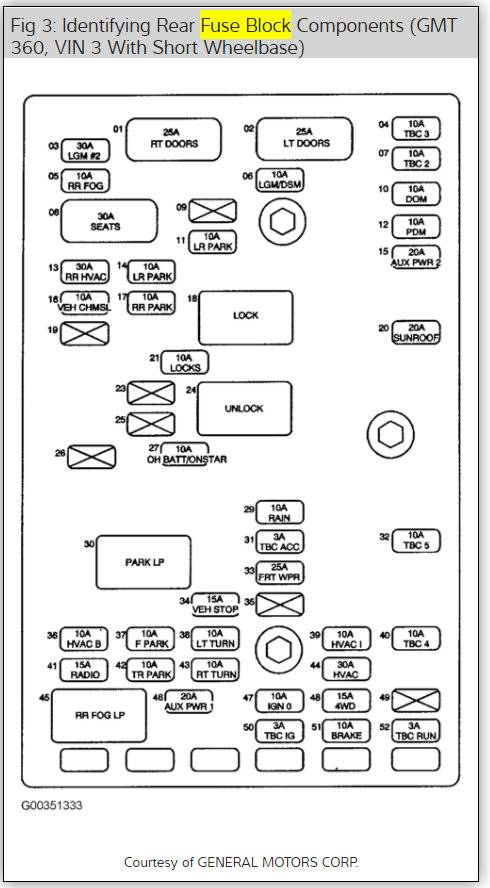

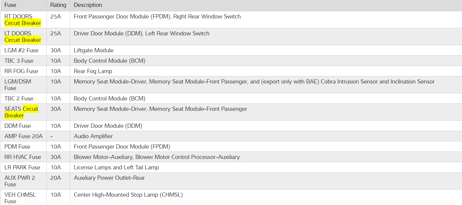

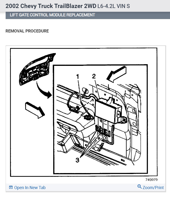

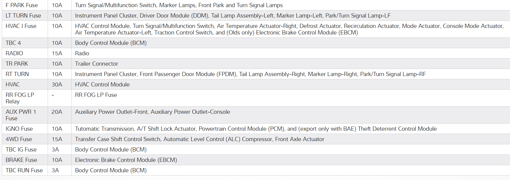

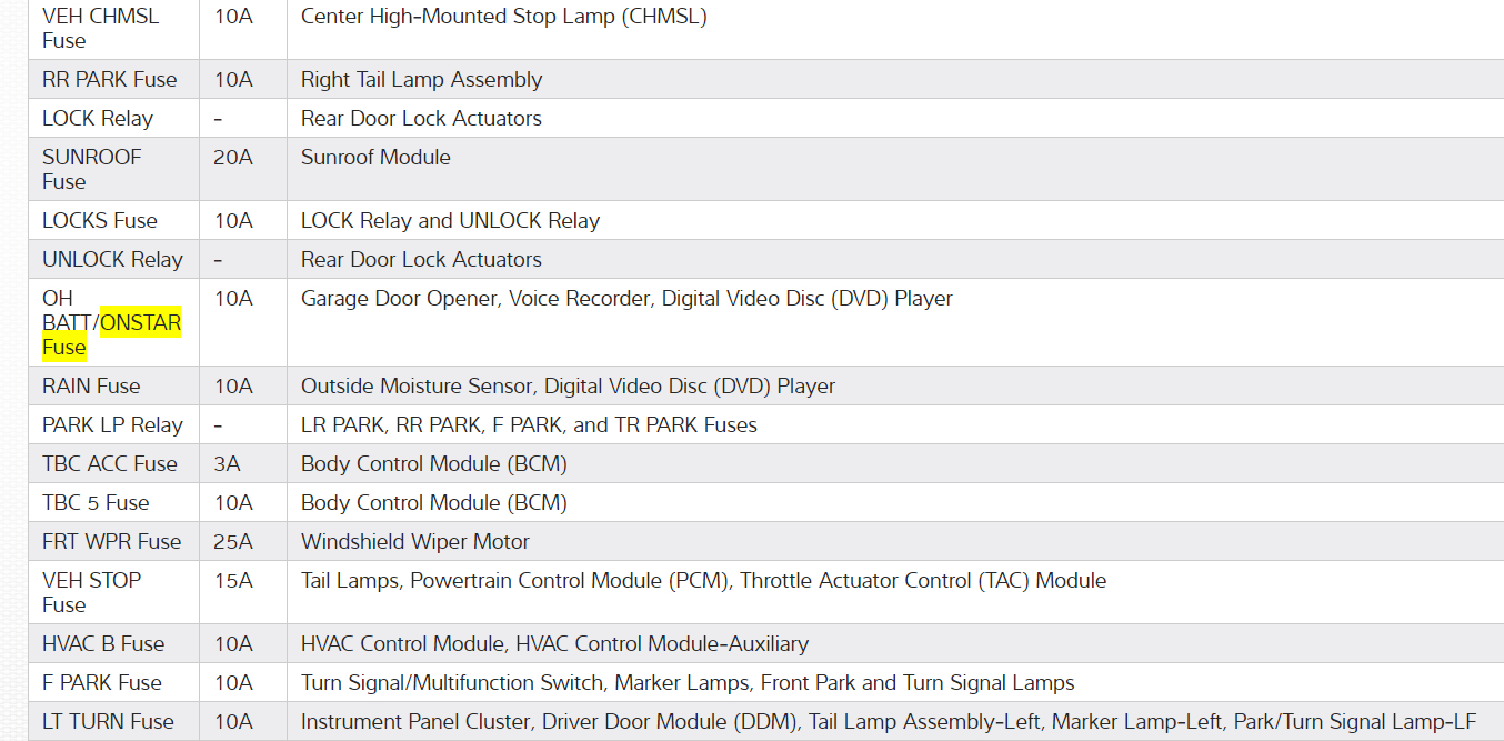

I would first start by checking the LGM1 fuse in the rear fuse panel below the left rear seat, if okay there is a liftgate control module that runs all three, the BCM runs two out of the three. Here is the location of the module and how to replace it. Also, here is a guide on how to check the fuses and the fuse locations as well:
