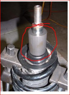

I actually talked to the owner (Pennsylvania, USA)and he sent me an email with detailed instructions. It is a pretty simple bolt-on kit! It uses the small spacer installed at the top of the front struts between the strut and bearing plate. (coil spring compressor needed) Note: That would be a good time to replace struts if old/worn. The rear just uses that larger spacer between shock and frame. The only difference is on the two inch kit you add a bracket to use the same length factory shock. Pretty simple. I have attached pictures from his instruction manual showing where the spacers go. I forgot a picture of the two inch shock bracket but I can get it if needed to show you. Hope this helps and feel free to ask any questions if needed.Thanks for using 2CarPros.
