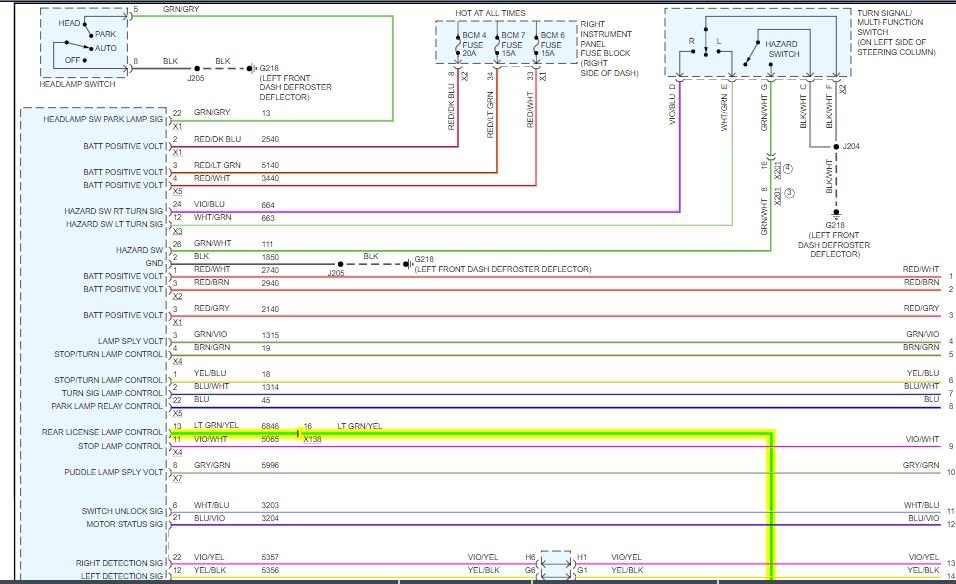

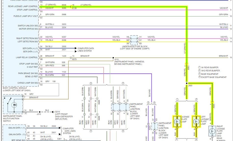

There is no fuse for the lights. The body control module is what controls the lights based on the input from the multifunction switch.
https://www.2carpros.com/articles/how-a-headlight-switch-works
I attached a diagram for you of the circuit.
You need a scan tool that can read the inputs and outputs from the body control module.

I would install the standard bulbs and see if they work.
Were there any resistors given to you for the bulbs? The body control module may not allow them to light due to the current flow.

There are no fuses for the lights as in the diagram I attached. the BCM controls the ground side of the circuit.
