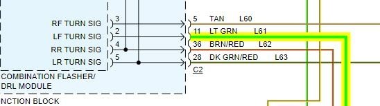

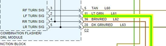

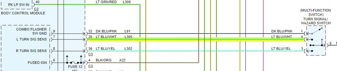

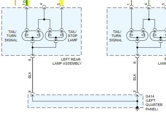

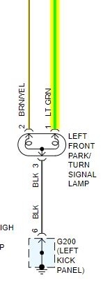

Left hand turn signals not working.
right hand turn signals work okay.
Emergency flasher works on all four corners.
Replaced flasher and turn signal switch.
According to the manual at this point it is either a wiring fault or a bad junction block. (Maybe the BCM?)
I have replaced the BCM twice on this vehicle so I know what a PITA it is to pull out all the wiring connectors, etc.
My question is, it worth trying to solve this problem or just use a hand signal for left turns. The engine and transmission is still good on this vehicle which is basically why I am still messing with it.
Thanks,
