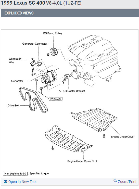

First you need to get the alternator tested, as when the battery light comes on it mean that the battery is not getting sufficiently charged.
It could be due to the idle speed drooping below recommended level but then again you could have an issue with the voltage regulator in the alternator, which is unable to support the extra load when you turn on the A/C.
