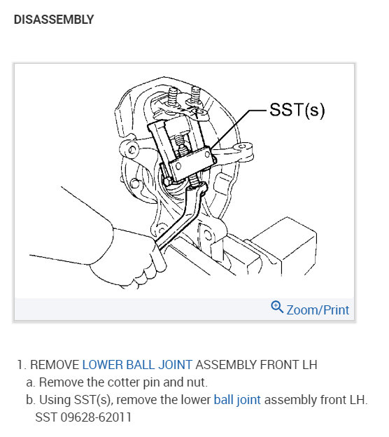

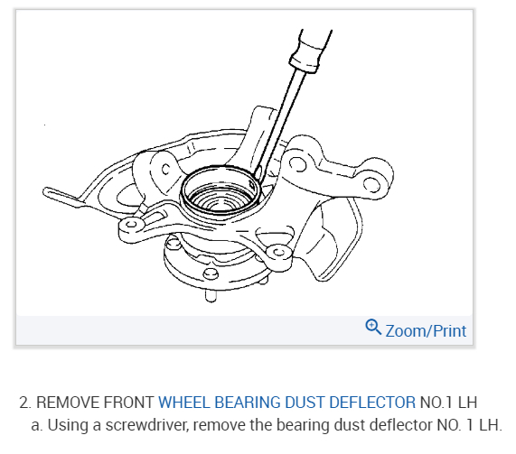

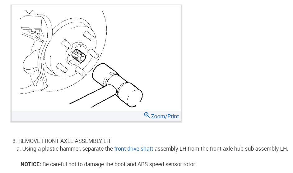

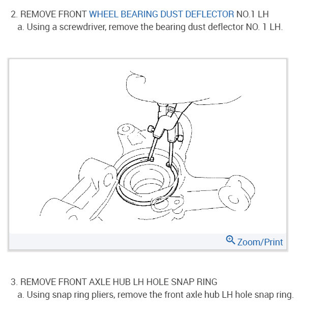

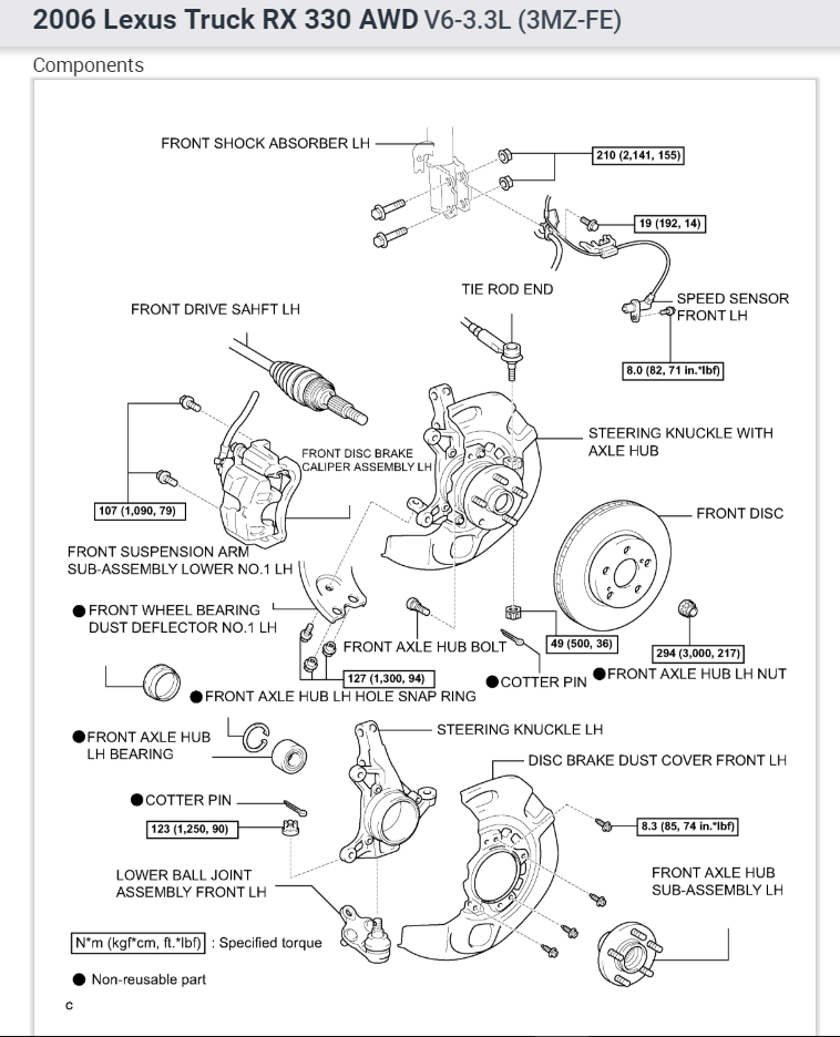

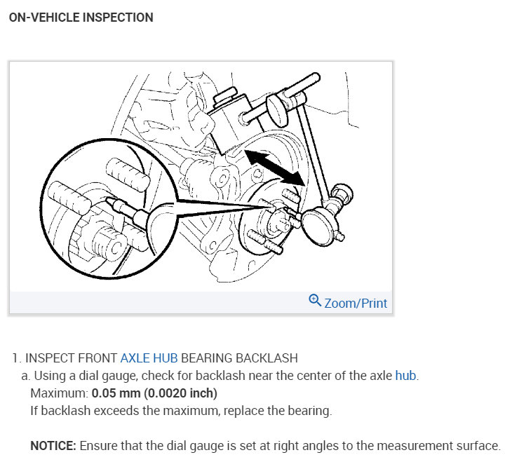

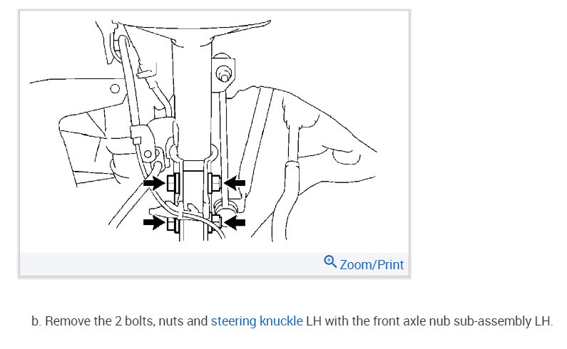

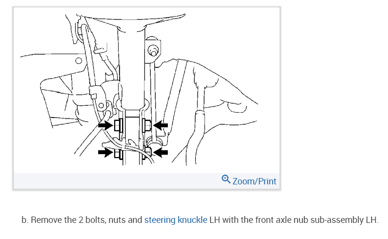

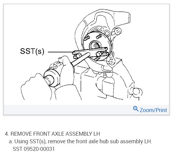

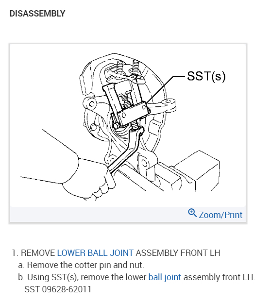

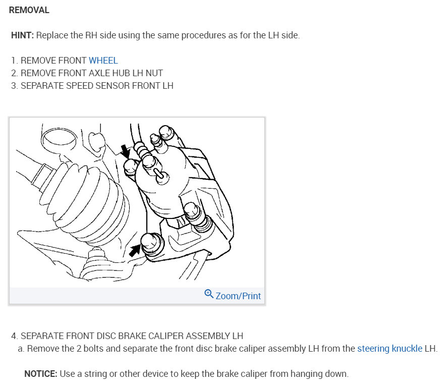

This happens when the front wheel hub on either the right or left goes out making the wheel speed sensor not work right. But to be sure lets run the codes to see what comes up here is a video to show you how.
https://youtu.be/rTtAnsOlZU4
If it gives you a wheel sensor code here is a guide to help you change the axle bearing out. I would do both sides with diagrams below to show you on your car
https://www.2carpros.com/articles/how-to-replace-a-cv-axle-bearing
and
https://www.2carpros.com/articles/how-to-replace-an-abs-wheel-speed-sensor
Check out the diagrams (Below). Please let us know what happens.
