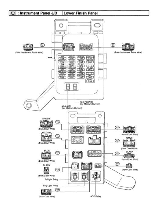

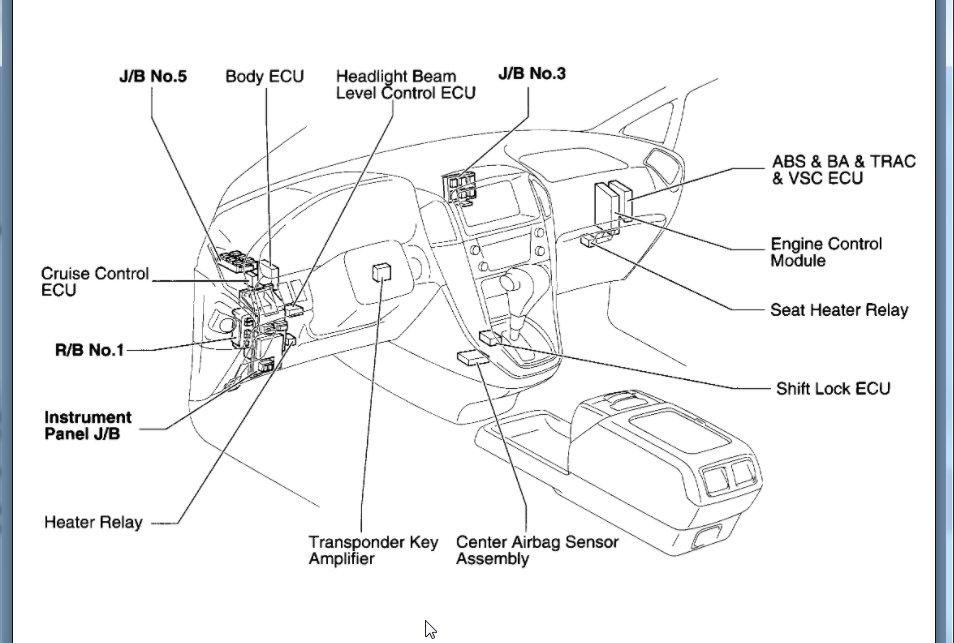

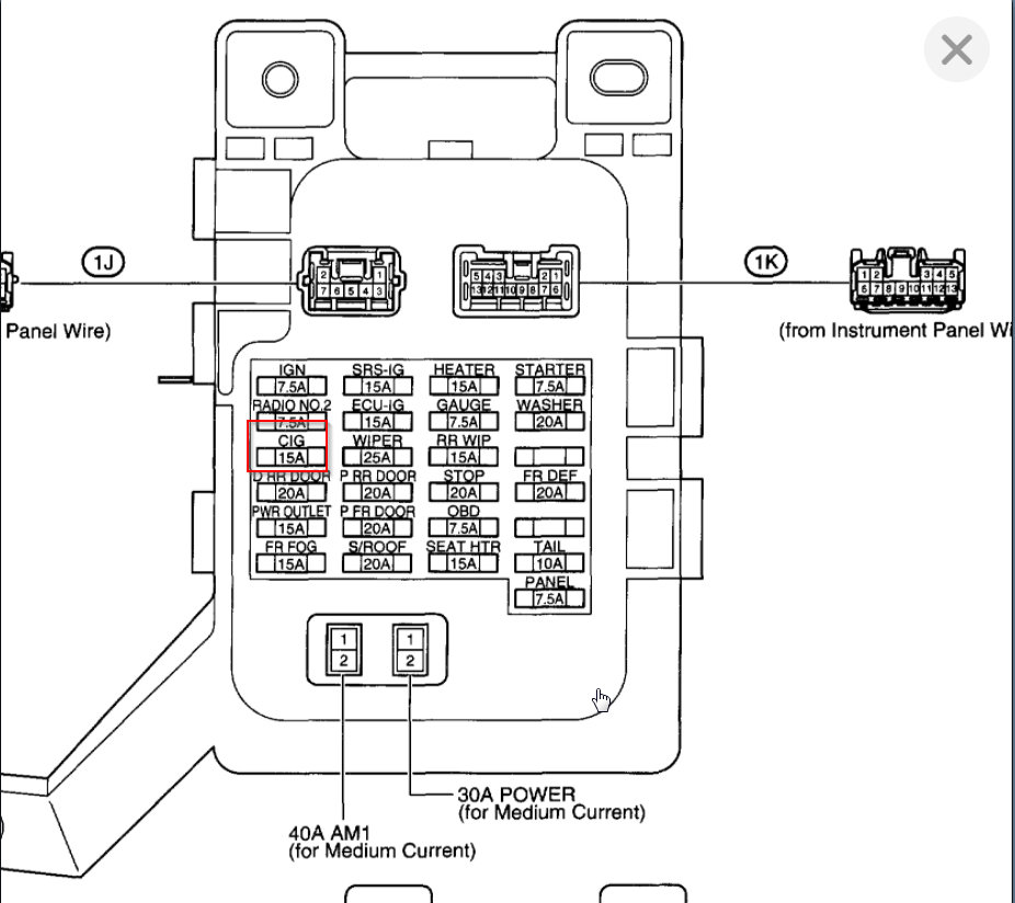

I am attaching the fuse block and showing the location in a red circle. It is located in the instrument panel fuse block so just review this material and let me know if you have other questions.
