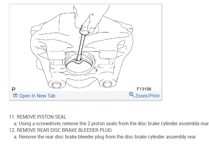

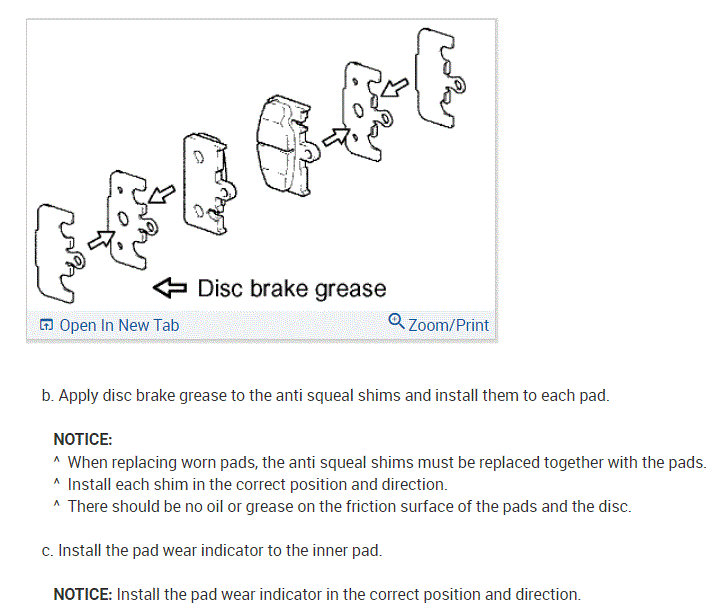

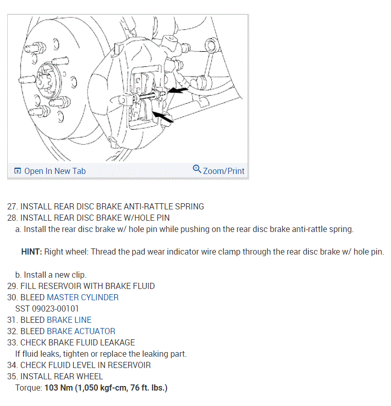

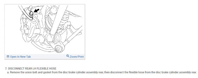

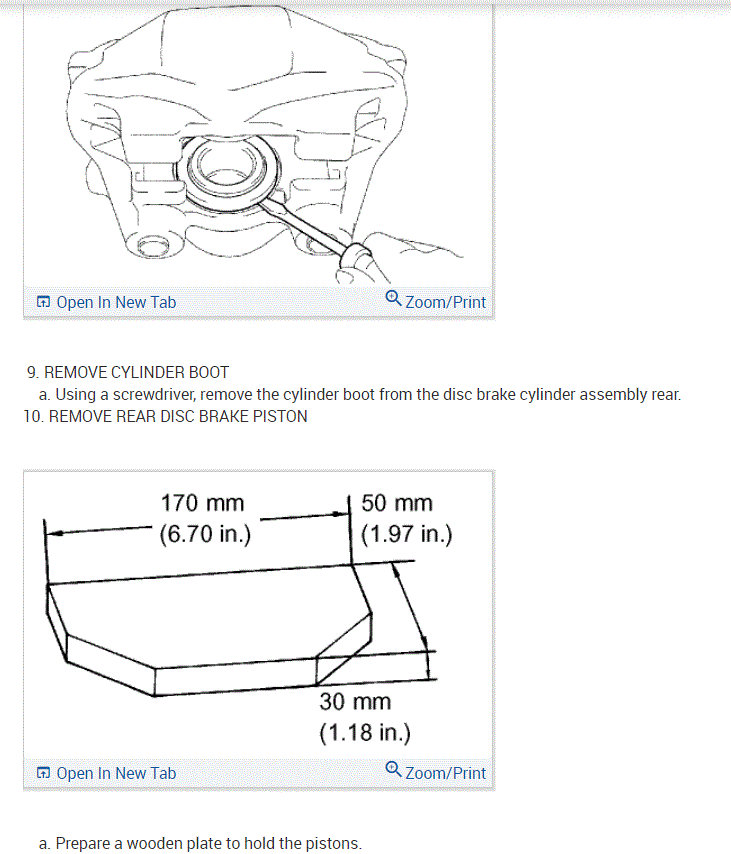

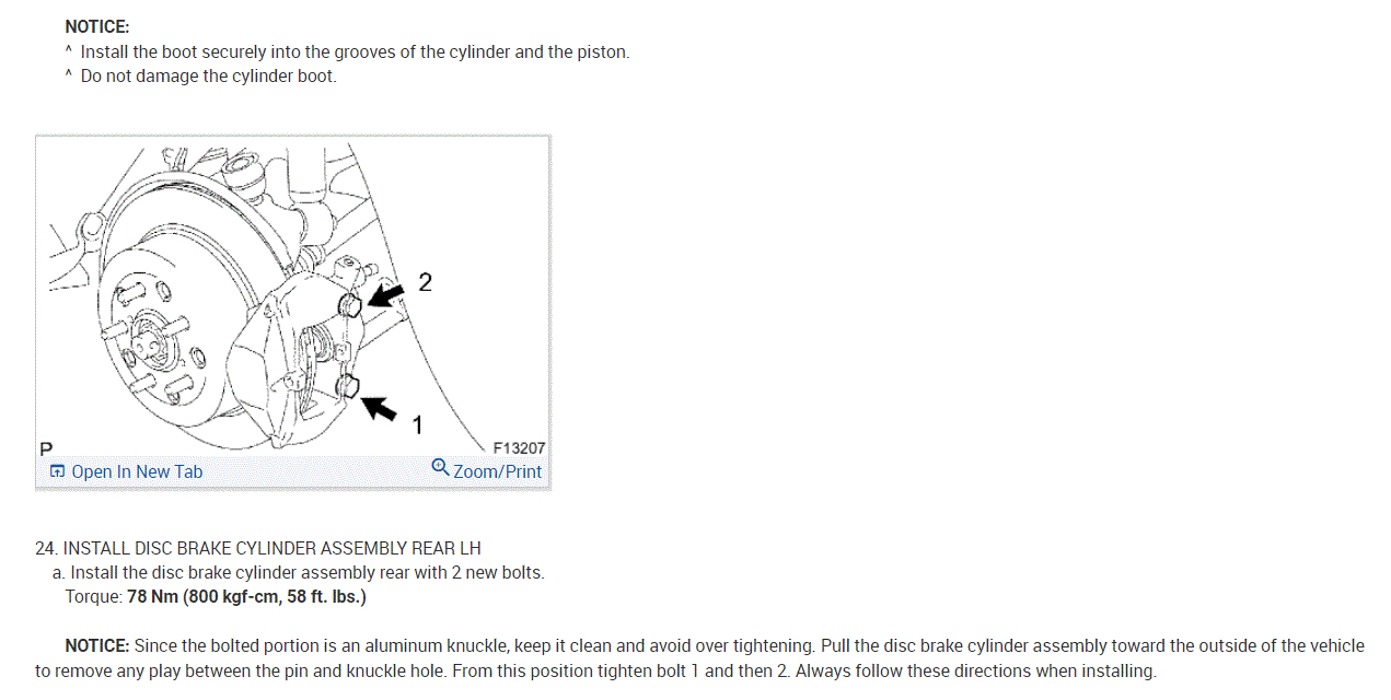

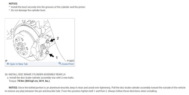

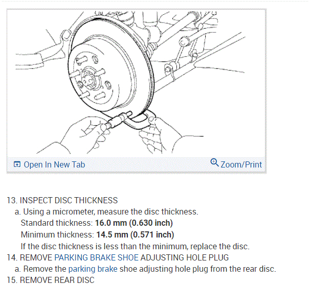

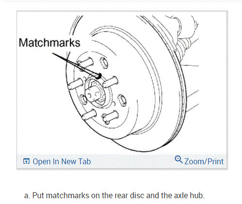

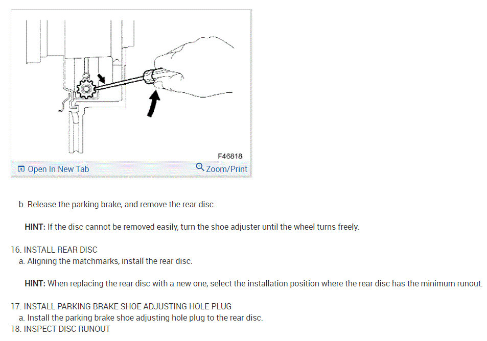

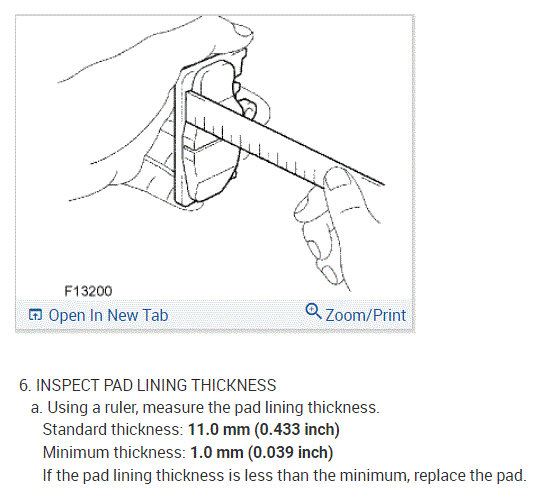

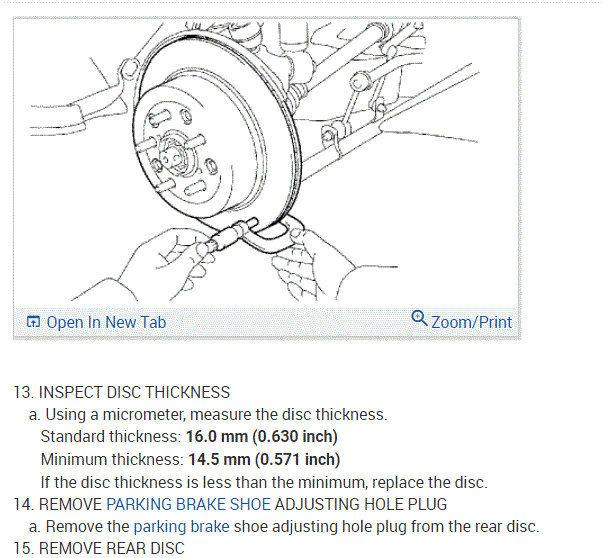

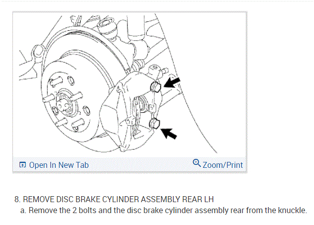

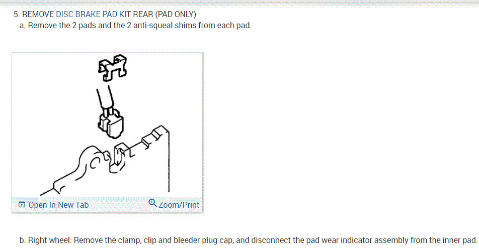

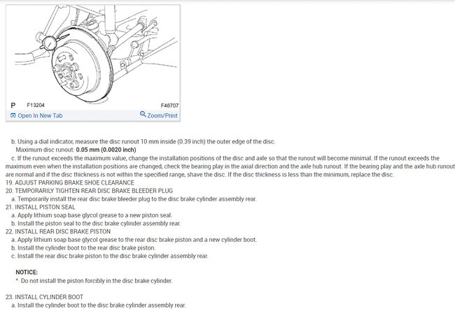

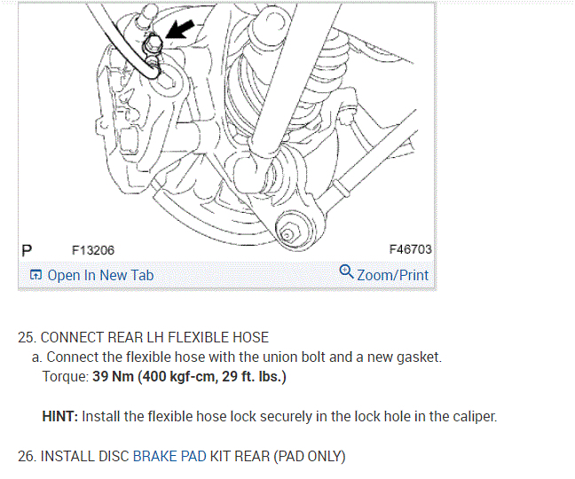

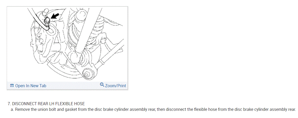

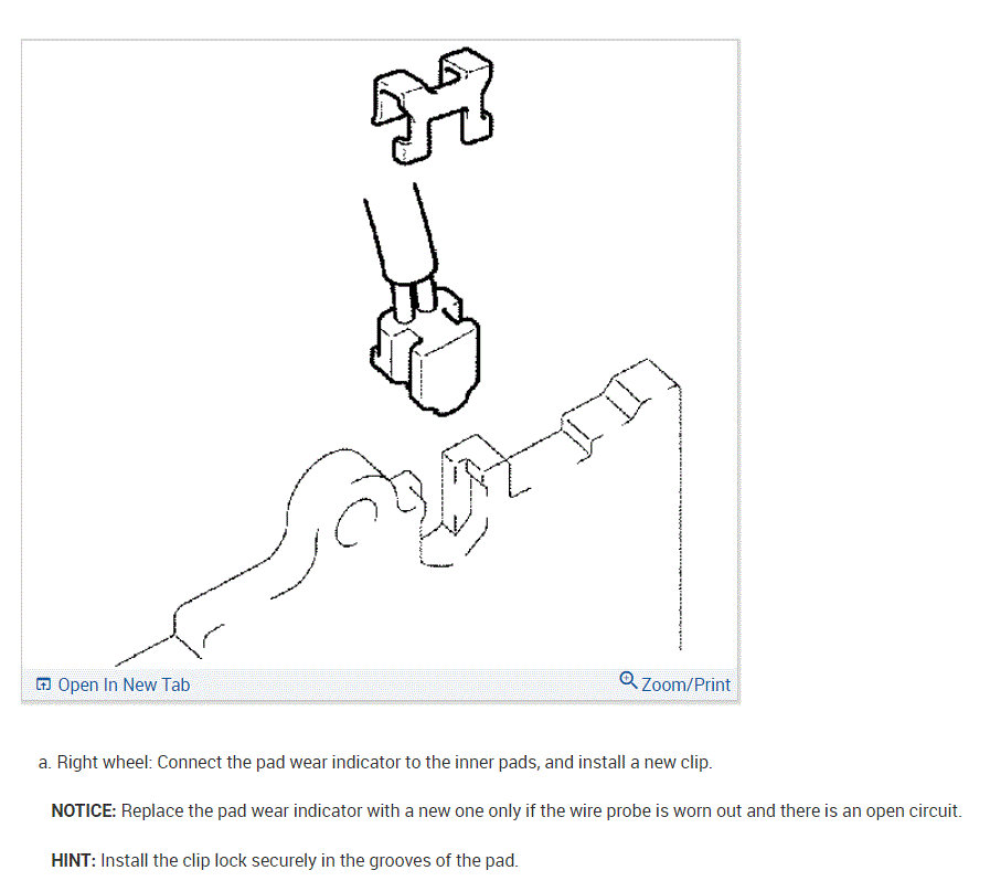

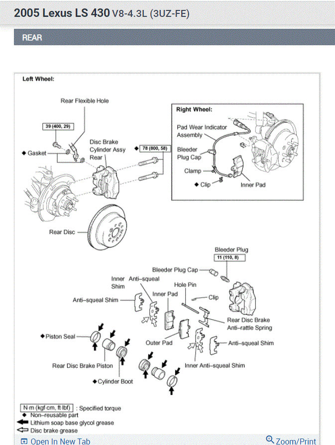

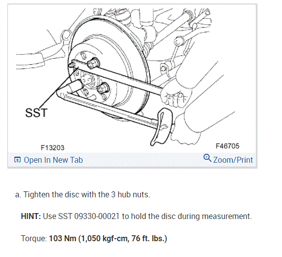

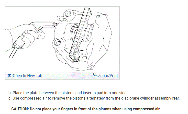

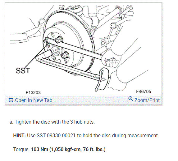

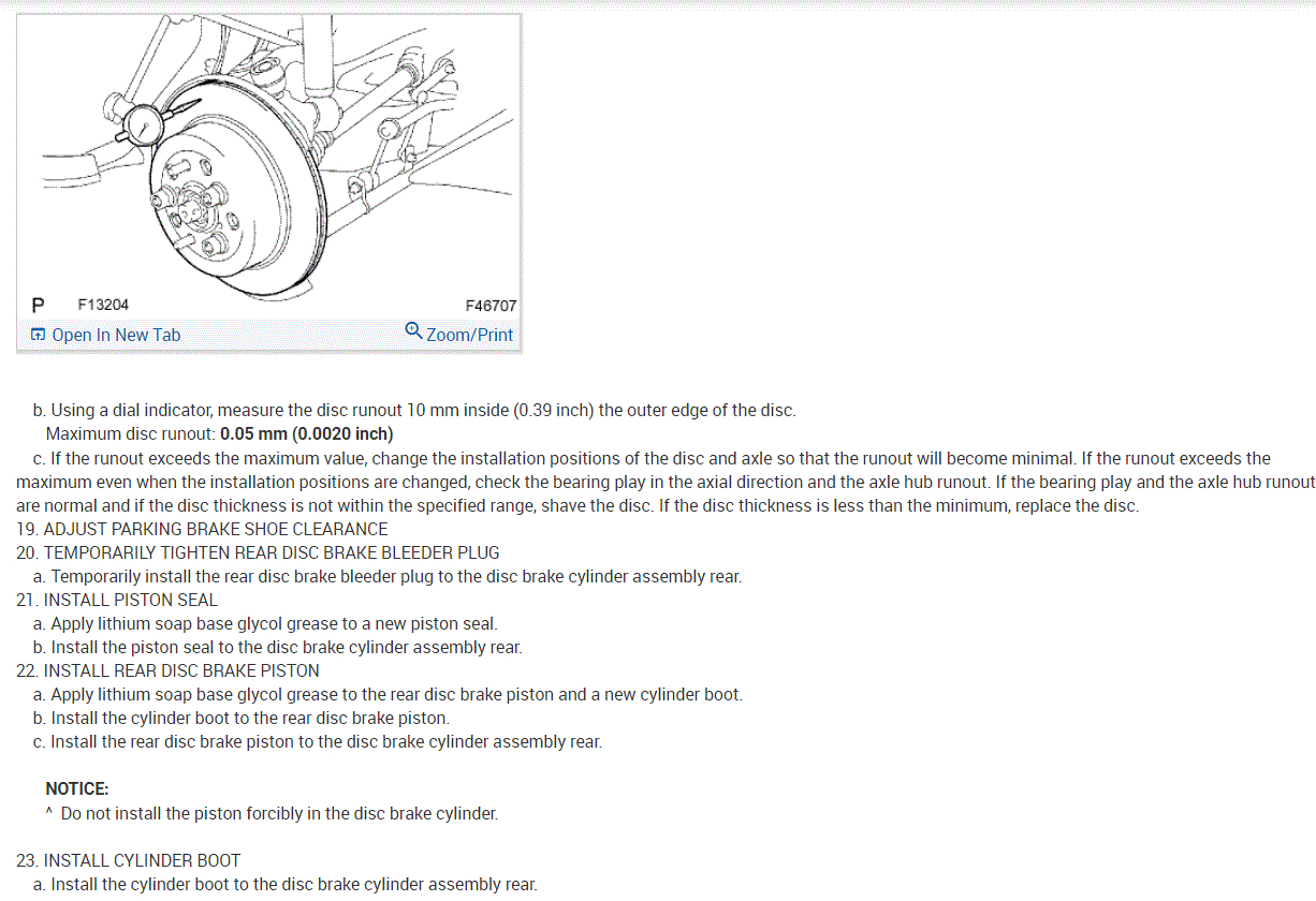

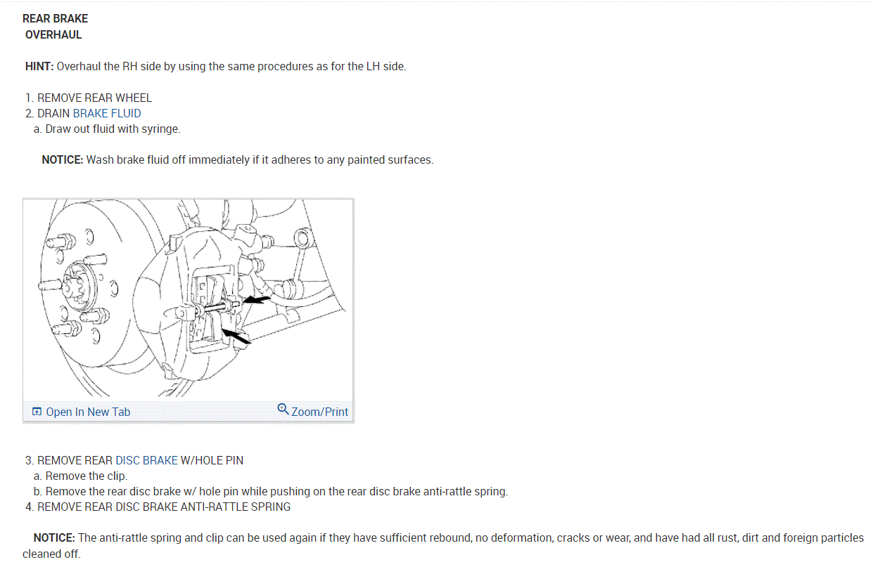

If you look at the attachments below, they provide the directions specific to your vehicle for rear brake pad and rotor replacement. These directions are for the entire rear brake system. They include inspection of the rotors and caliper overhaul.
I hope this helps. Let me know if you have other questions. Remember, the directions are for an overhaul. Only do what is needed.
See pics below.
