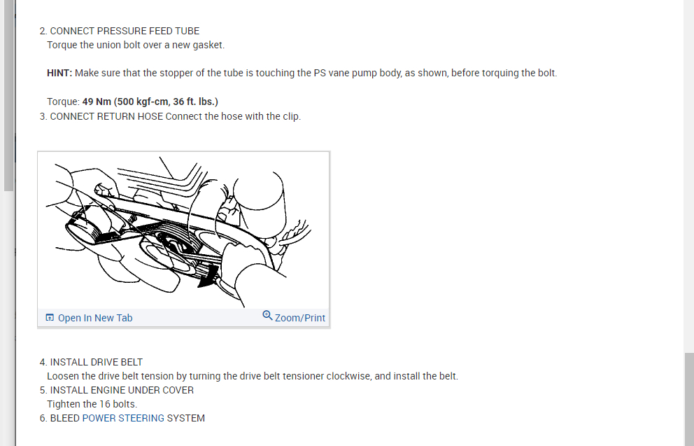

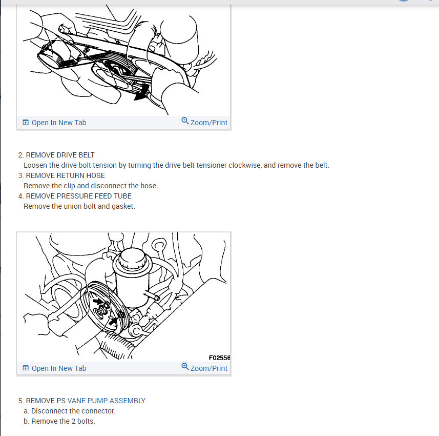

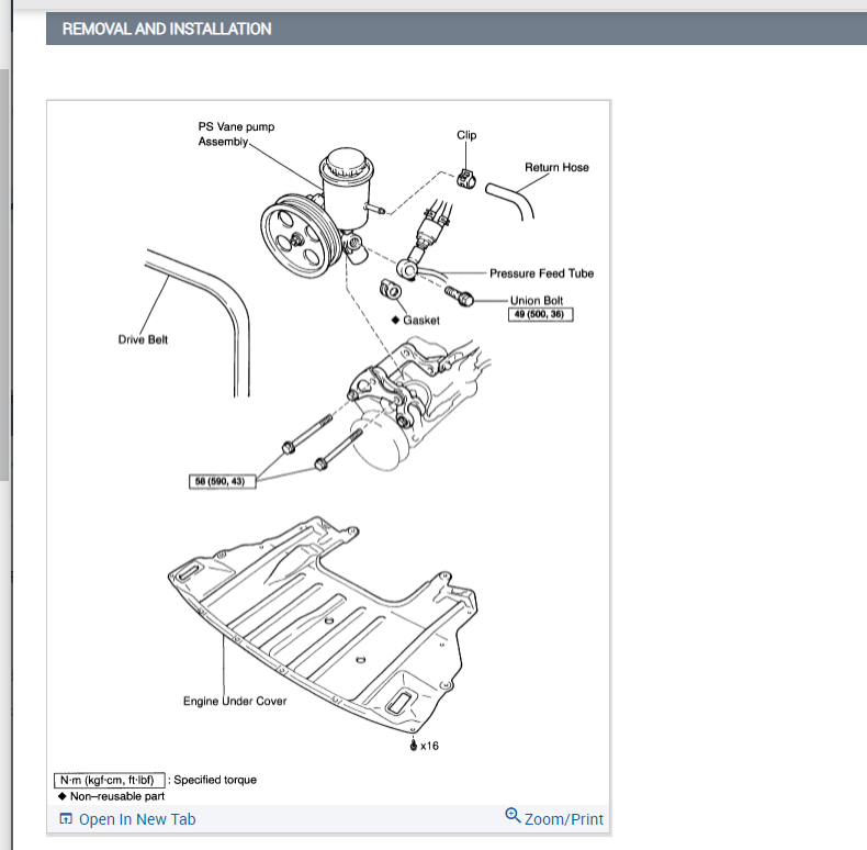

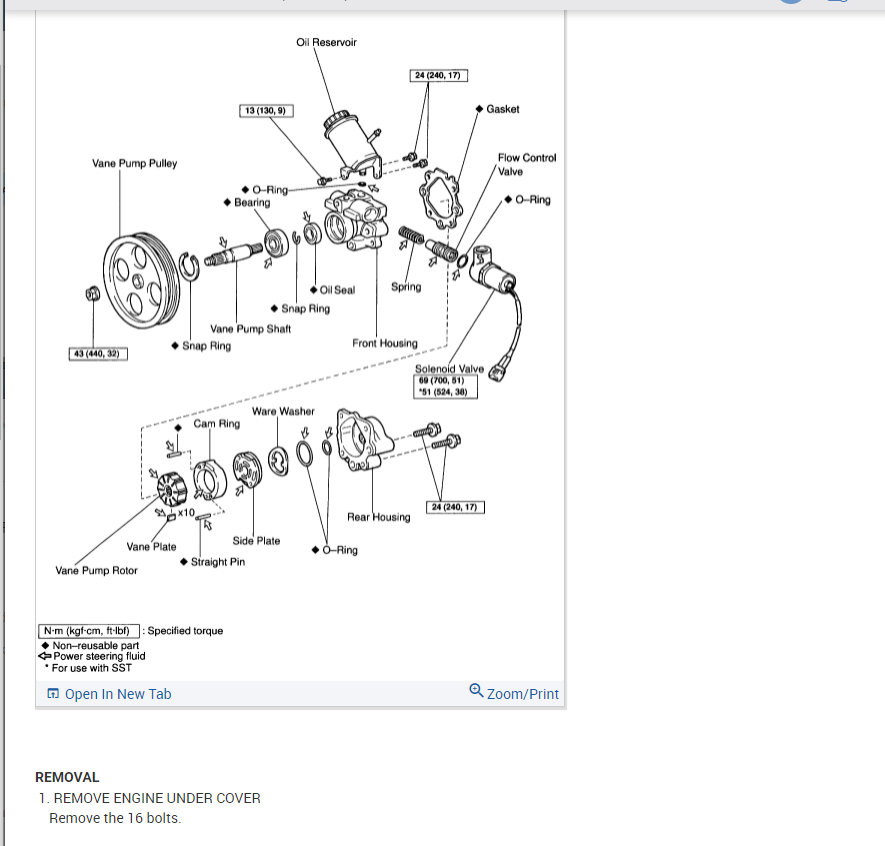

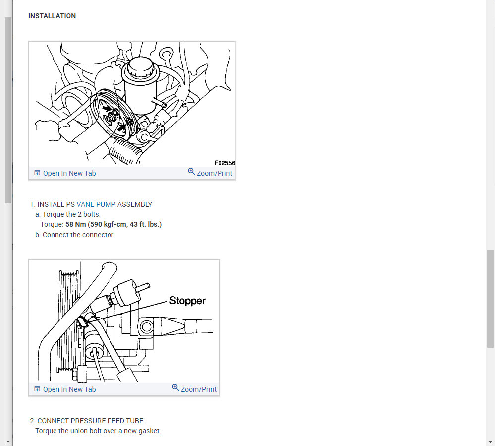

Below is the process from the manual that will help with the step by step process. Please let us know if you have other questions on this. Thanks
