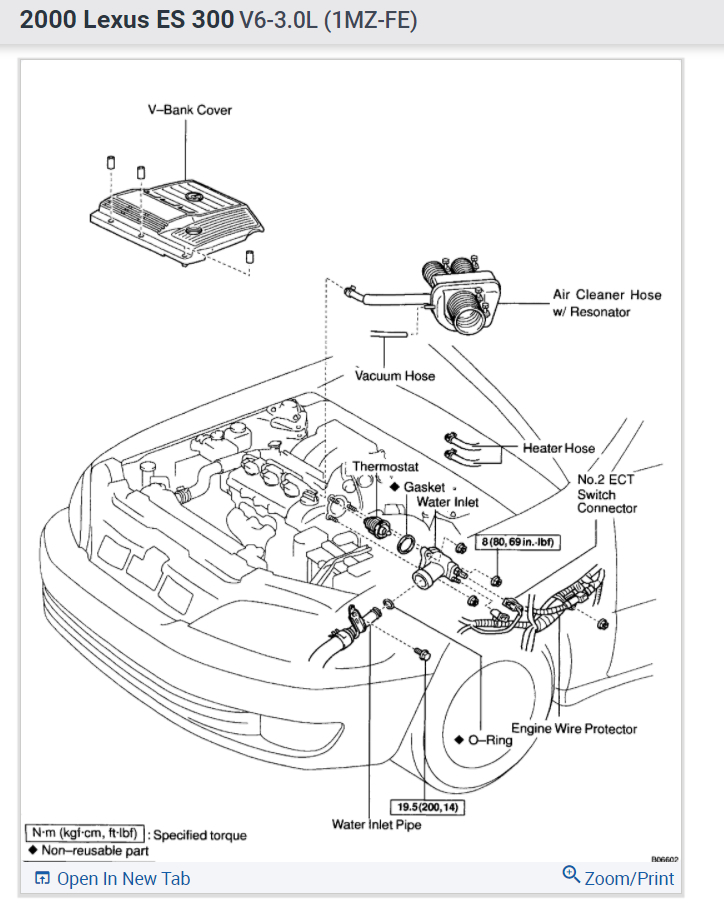

Where is the thermostat located on a 2000 Lexus es300. I followed the upper radiator hose and took apart what i thought was the housing but this wasn't it. I've found several different answers for several year models but not this one in particular. Also would a stuck thermostat cause my car not to go into overdrive? I'm getting a code for insufficient temp for closed loop and knock sensor codes but nothing for my transmission. Pleaaaase help
