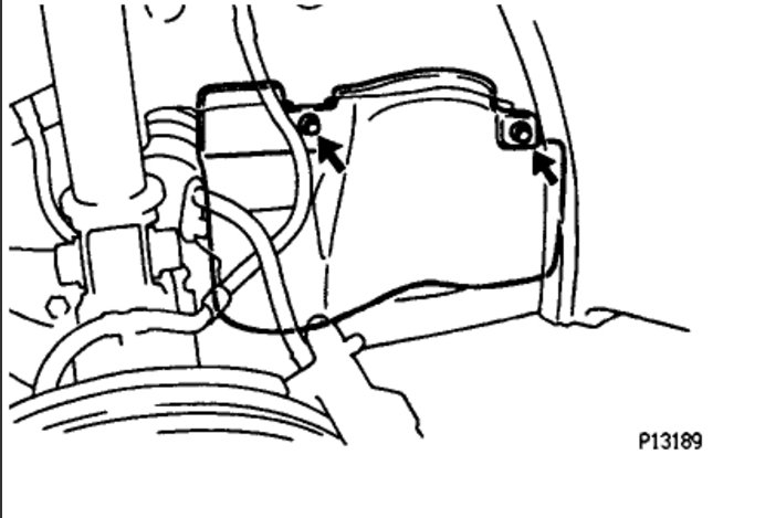

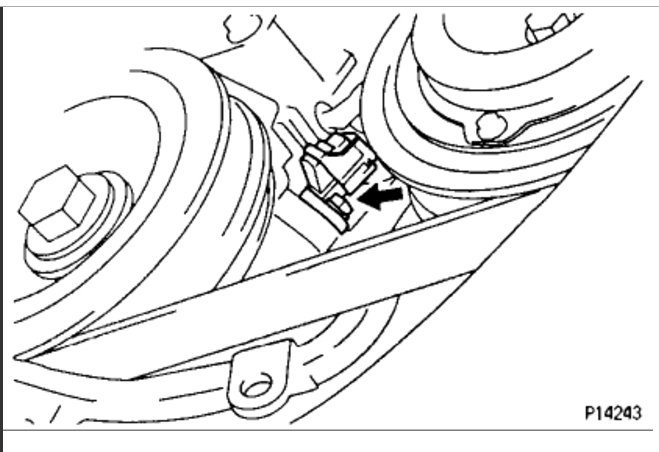

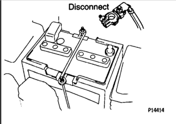

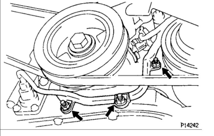

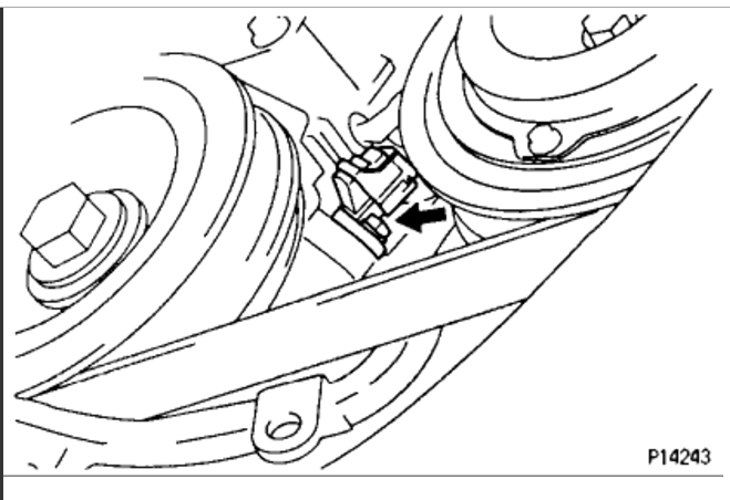

It sounds like the crankshaft angle sensor is going bad and the IAC valve needs to be serviced.
Here are a couple guides to show you what you are in for when changing and cleaning to get the car fixed.
and
I would also run the codes to see what come up.
Here is how it is done in your car (below)
