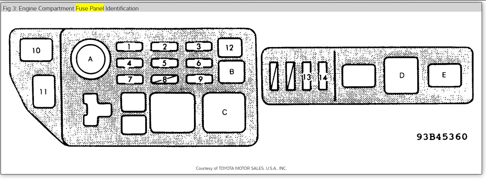

The Relay I'm talking about is on the passenger side on the right. There is one screw you have to remove you can turn that screw by hand. Once that cover is off you'll see a black relay and a fuse in there.

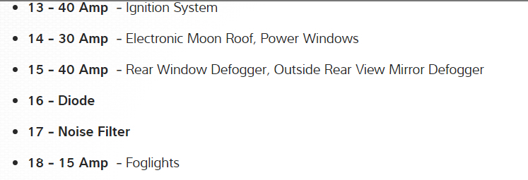

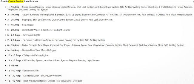

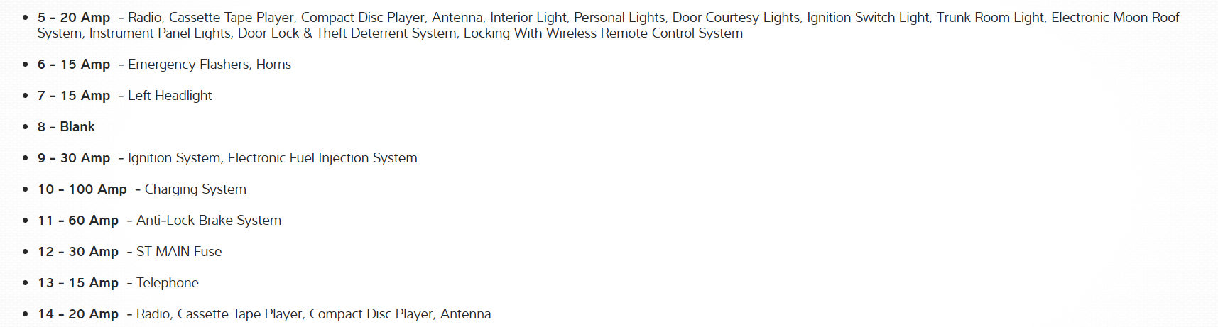

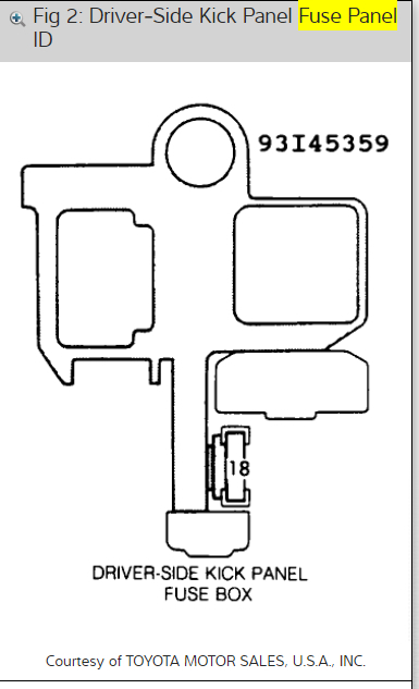

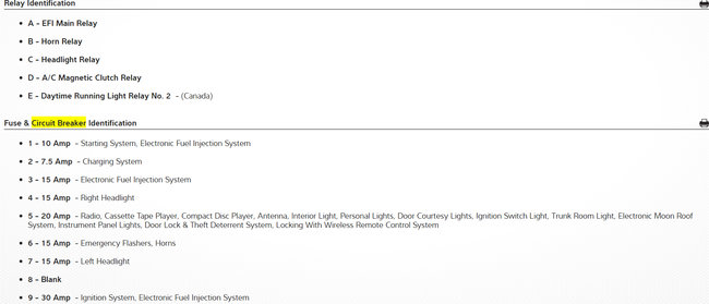

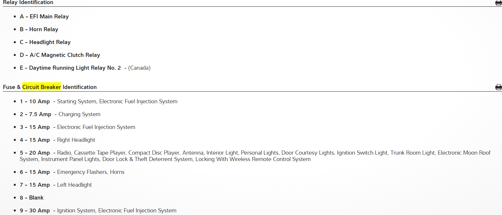

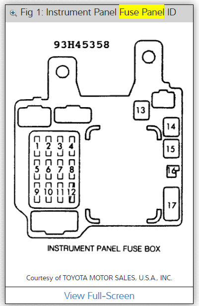

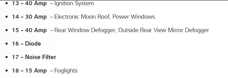

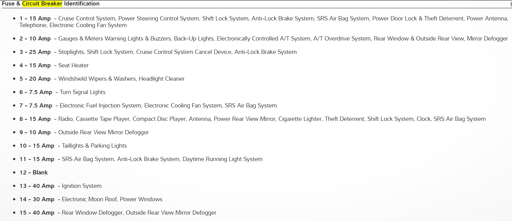

I think the relay he was talking about was the EFI relay which I have seen problems with. Here is a guide to test and the location of the relay.
