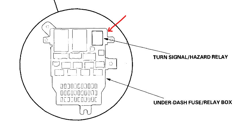

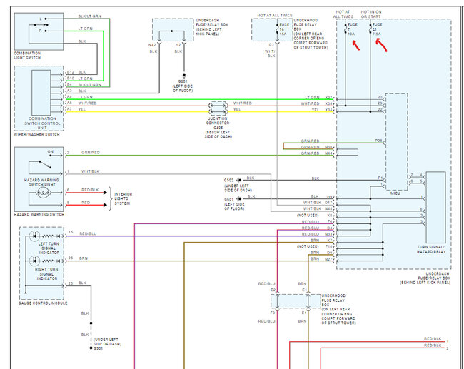

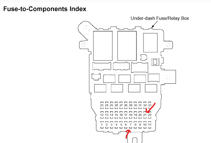

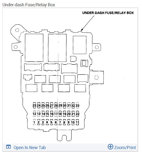

You may have a defective hazard/turn relay because that is what feeds the blinkers, but I would check the fuse# 7 and #21 in the fuse panel under the dash. Here is the location of the flasher and fuses so we can be on the same page. Also, this guide may help:
https://www.2carpros.com/articles/turn-signals-not-working-blinker

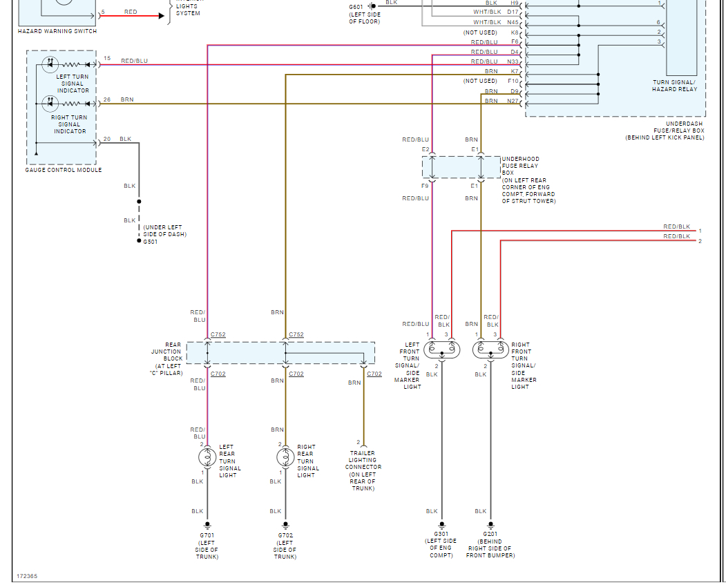

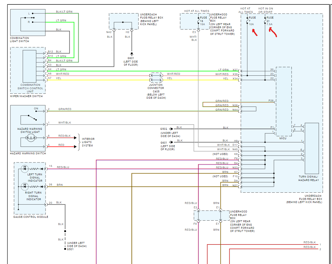

Here is the blinker wiring diagrams so you can see how the system works. Check out the images (below). Let us know how it goes.

Okay, can I ask if both front and rear bulbs on the left side are lighting up even though they are not blinking? Also are the bulbs bright when on? As you can see by the wiring diagrams there is a MICU that supplies power to the hazard/turn signal flasher that can be bad. Does fuse #21 pop after you install it? Here is how to replace the MICU which is inside the under-dash fuse panel in case you need it. Check out the images (below). Please upload pictures or videos in your response of any problems so we can see what to help you with.
