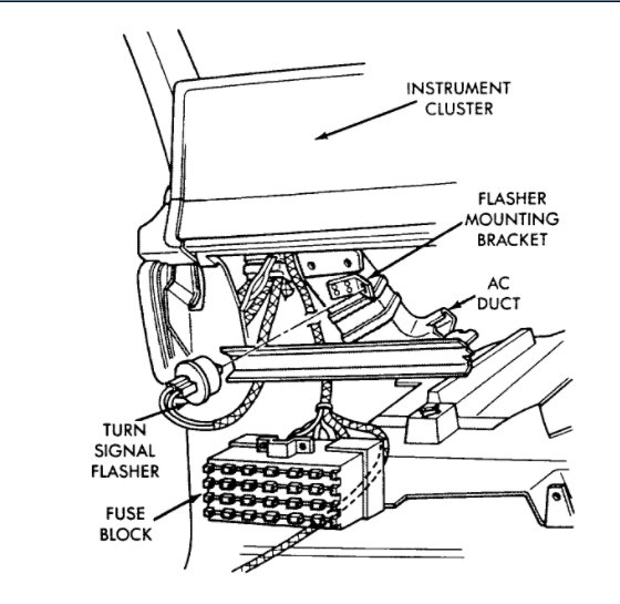

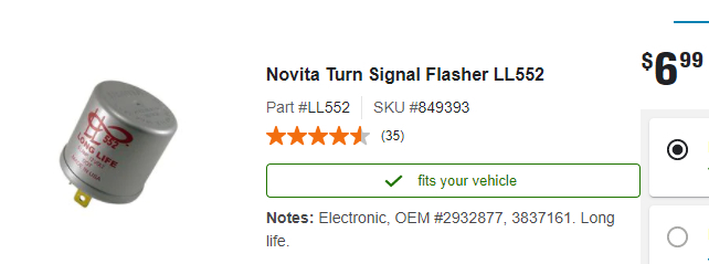

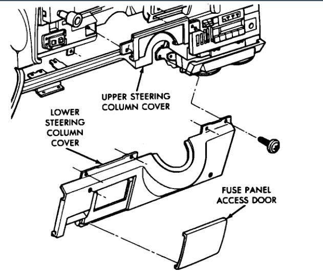

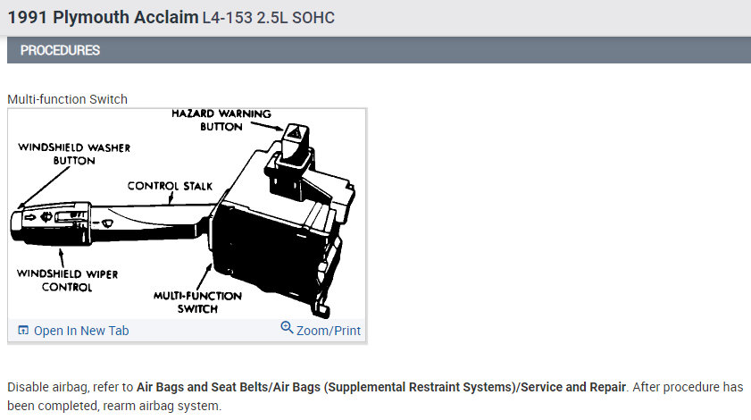

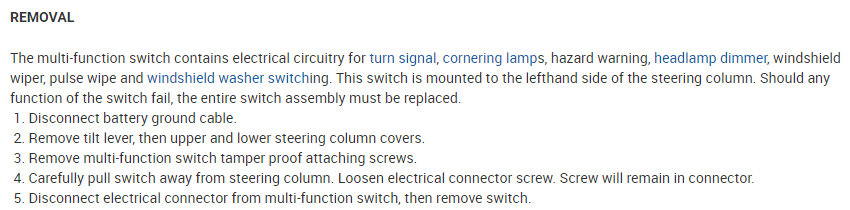

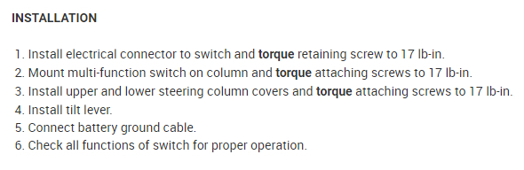

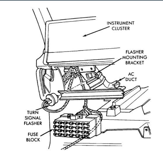

I suddenly lost the left only turn signal clicking sound, the light lights up though, but no clicking (flashing). I changed the rear bulbs and all it did was make the bulb brighter on the dash. Will changing the front parking lights make the turn signal flash and click? Any suggestions? remember the right hand flasher works great and so does the ER flasher.
