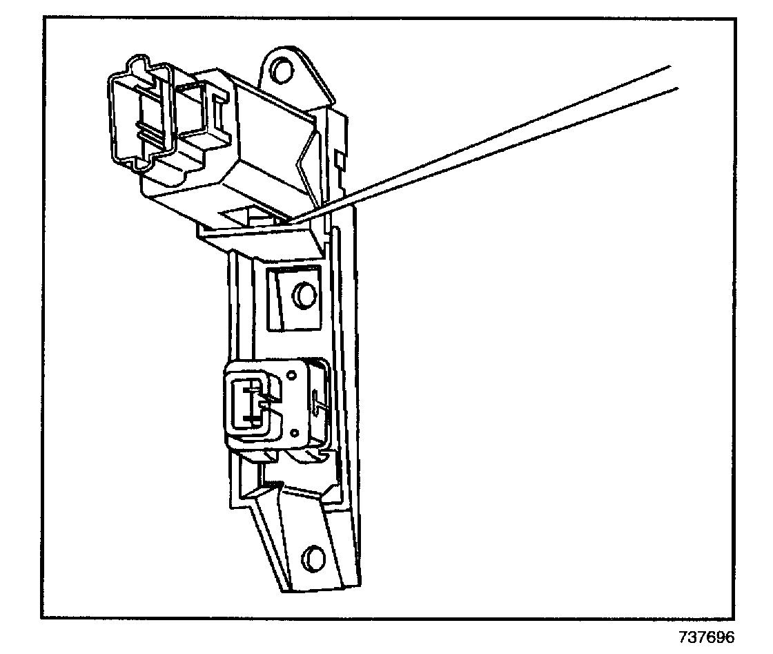

pic 1
1. Remove the Instrument panel accessory trim plate.
2. Remove the screws from the switch retainer bracket.

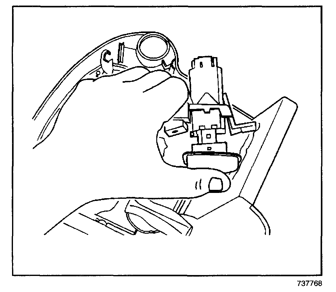

pic 2
3. Remove the retainer bracket from the accessory trim plate.

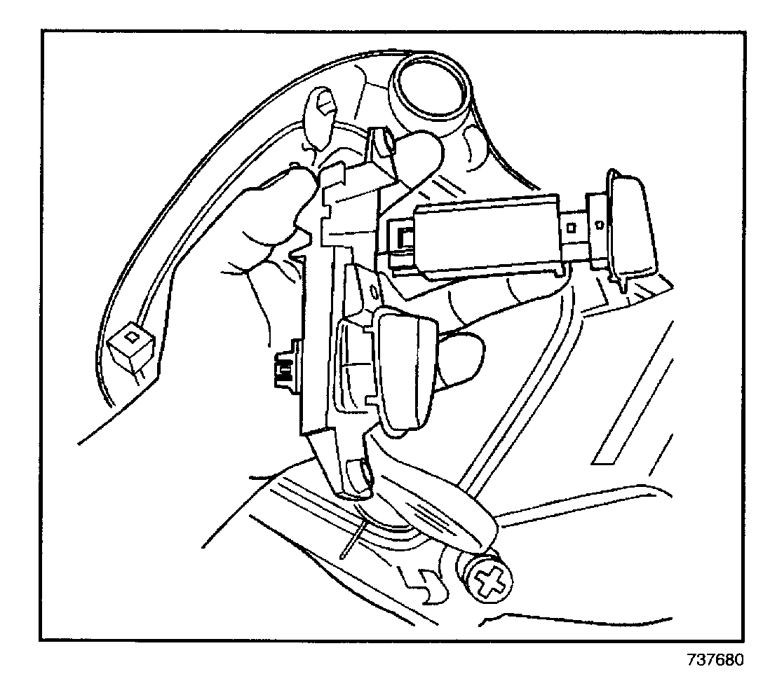

pic 3
4. Remove the flasher and switch from the switch retainer bracket use a small flat-bladed tool in order to depress and release the flasher retainers, while pressing the flasher and switch out with your thumb.

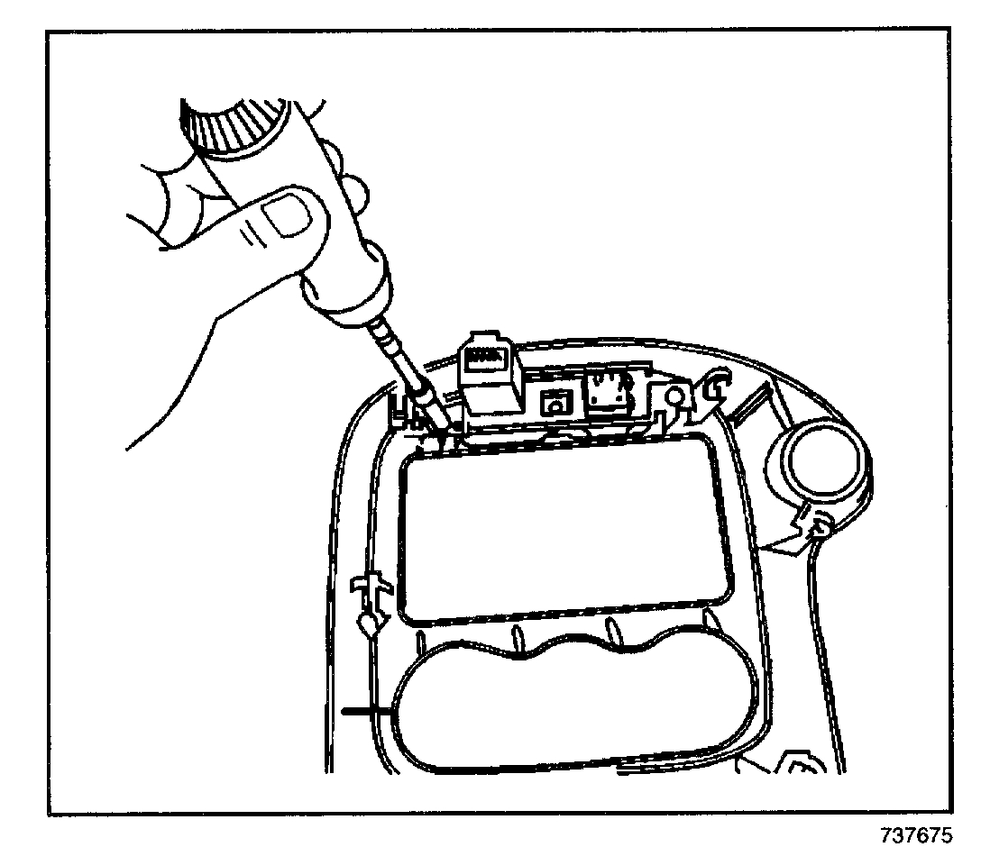

pic 4
5. Remove the flasher and switch from the switch retainer bracket.

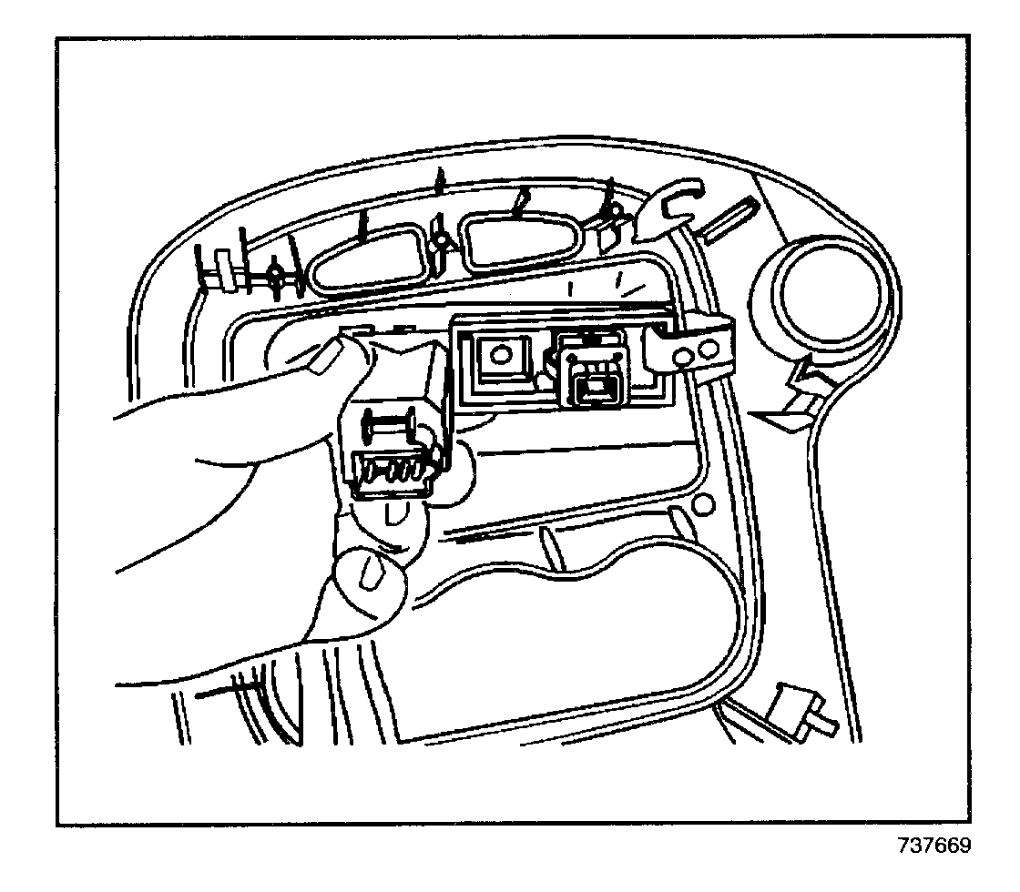

pic 5
1. Position the flasher and switch to the switch retainer bracket.
