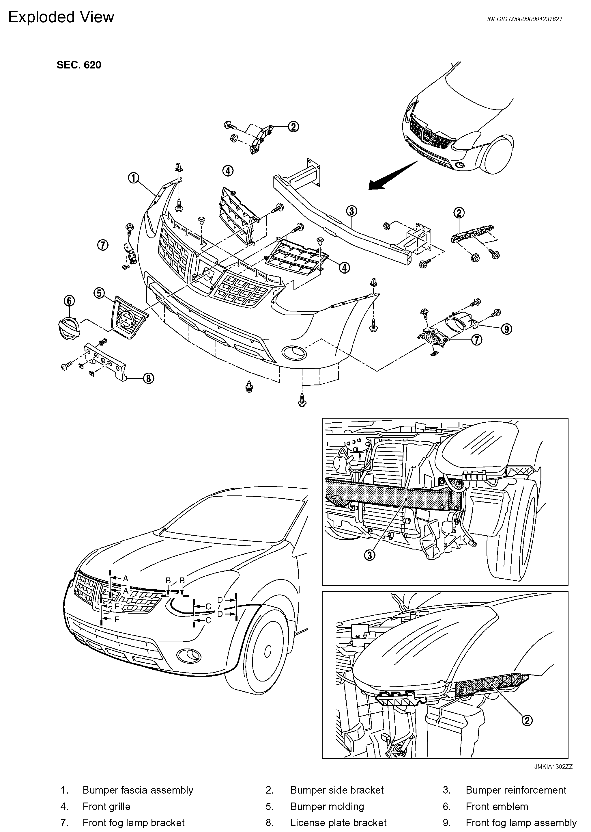

Fascia removal (basically, you need to remove the front bumper cover.)
(see pic 1 below for mounting pin locations.)

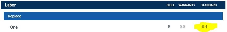

Please let me know if you get it taken care of or if you need help. One last thing, it calls for aprox 30 minutes to replace it. So don't let people take advantage. See the pic below. I highlighted the labor as provided by Alldata.

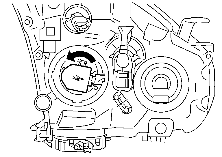

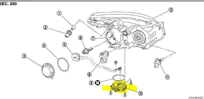

If you look at pic 1, it shows the HID module. If that is on your vehicle, they are HID.
Now, I looked in another manual and found a totally different set of directions. See if this is something you can do. I will include for both HID and non HID. According to this manual, the bumper cover doesn't need removed and the bulb can be replaced from under the hood.
Make sure to disconnect the battery first.

HEADLAMP BULB (LO)
1. Remove the air duct*. Keep a service area.
*When replace a left.
2. Rotate the resin cap counterclockwise and unlock it.
pic 2
3. Rotate the bulb socket counterclockwise and unlock it.
4. Unlock the retaining spring. And remove the bulb from the headlamp housing assembly.
