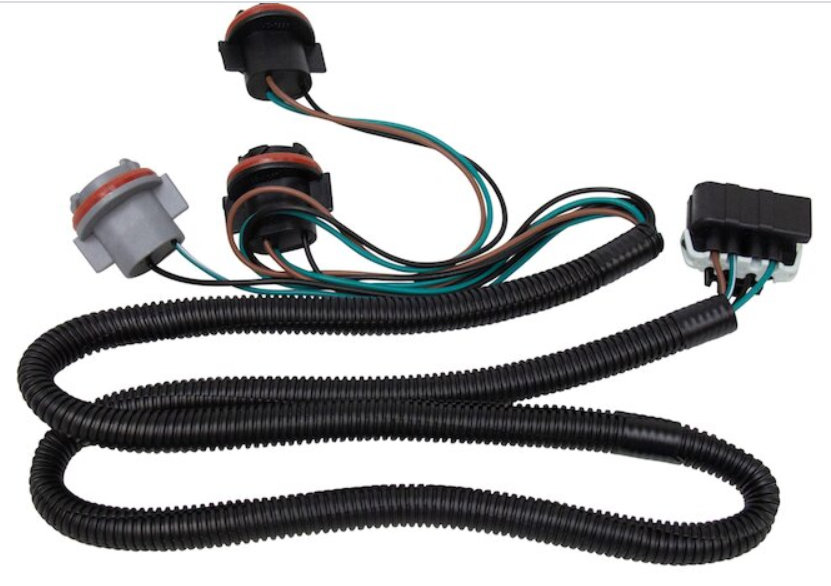

This is the issue:
Turn indicator only, okay!
Turn indicator, with lights on, okay!
Turn indicator, and braking, okay!
Turn indicator, with lights on, and braking, Left rear lights go out
When I activate my alarm via the fob, the only left rear light on, is the reverse light.
Any suggestions!? I have en-route, a complete set of housings (right/left, front/end) to replace the ones on the vehicle now.
