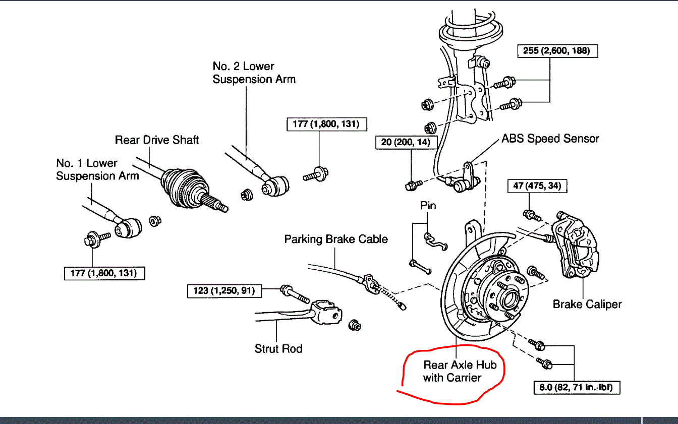

My problem is the left rear axle carrier bushing,is got a lot of slick in the bushing. Lexus wants to sell the whole knuckle.I only need the bushing,can't seem to find one that fits. I strongly would appreciate your help.Thank you
