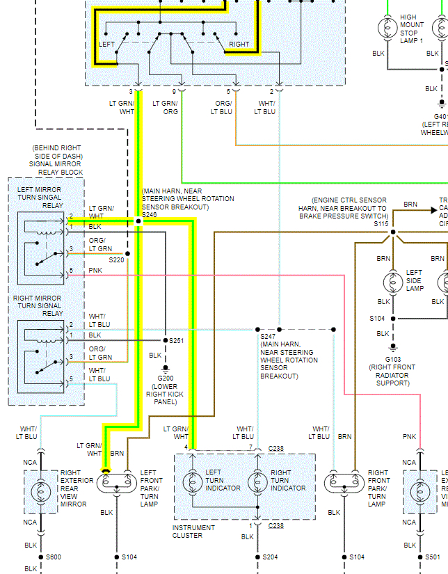

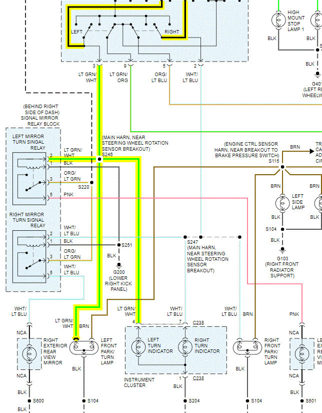

Is the signal on the left exterior mirror working? I attached a pic from the schematic below and it shows that the power first goes to the mirror.

Have you checked to see if there is power the light green wire with the white tracer? Also, in the socket, check to see if there is continuity to ground.
When you turn the left signal on, does it flash really fast?

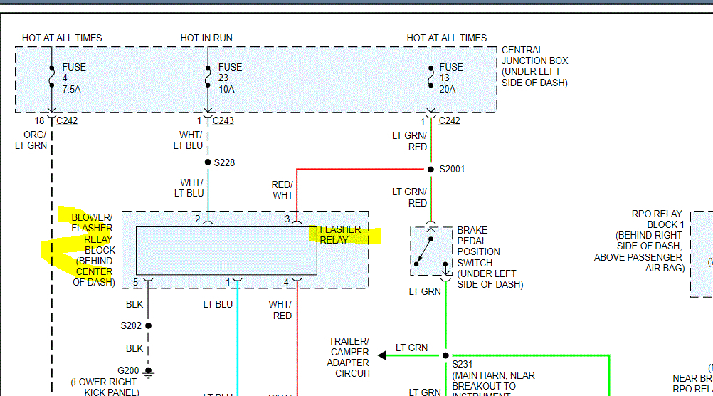

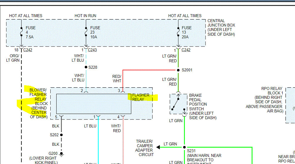

This 2002 Expedition has no side mirror signal light. Does it still run through a common relay?
Oct 31, 2020 at 10:48 AM
Yes, it is under the dash. See the attached pic.
