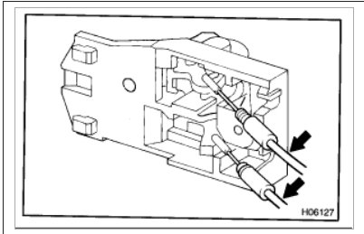

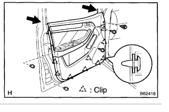

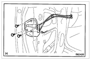

This sounds like the latch needs to be replaced you will need to remove the door panel.
https://www.2carpros.com/articles/door-panel-removal
This guide will give you an idea. Here are diagrams to show you how to do the job.
Check out the diagrams (below).
