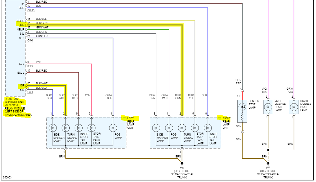

I just went through wiring schematics and found that the left and right-side signals get power from two different pins at the SAM module (Signal Acquisition Module). If there the left power supply has a bit more resistance in the wire, that could allow the circuit to continue working. See pic below.
I feel it you would place a resister at the right rear signal lamp, that would eliminate the bulb out and failure of the right side.
