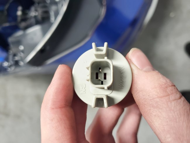

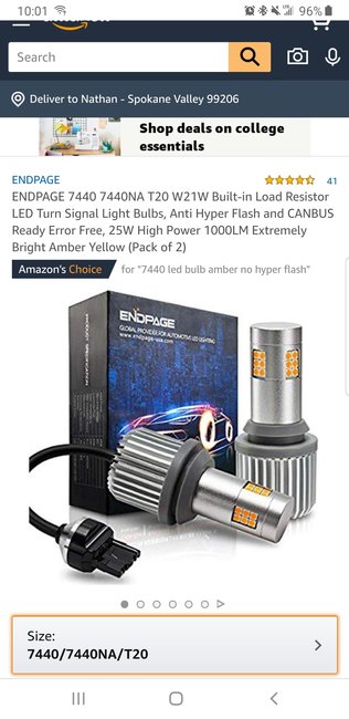

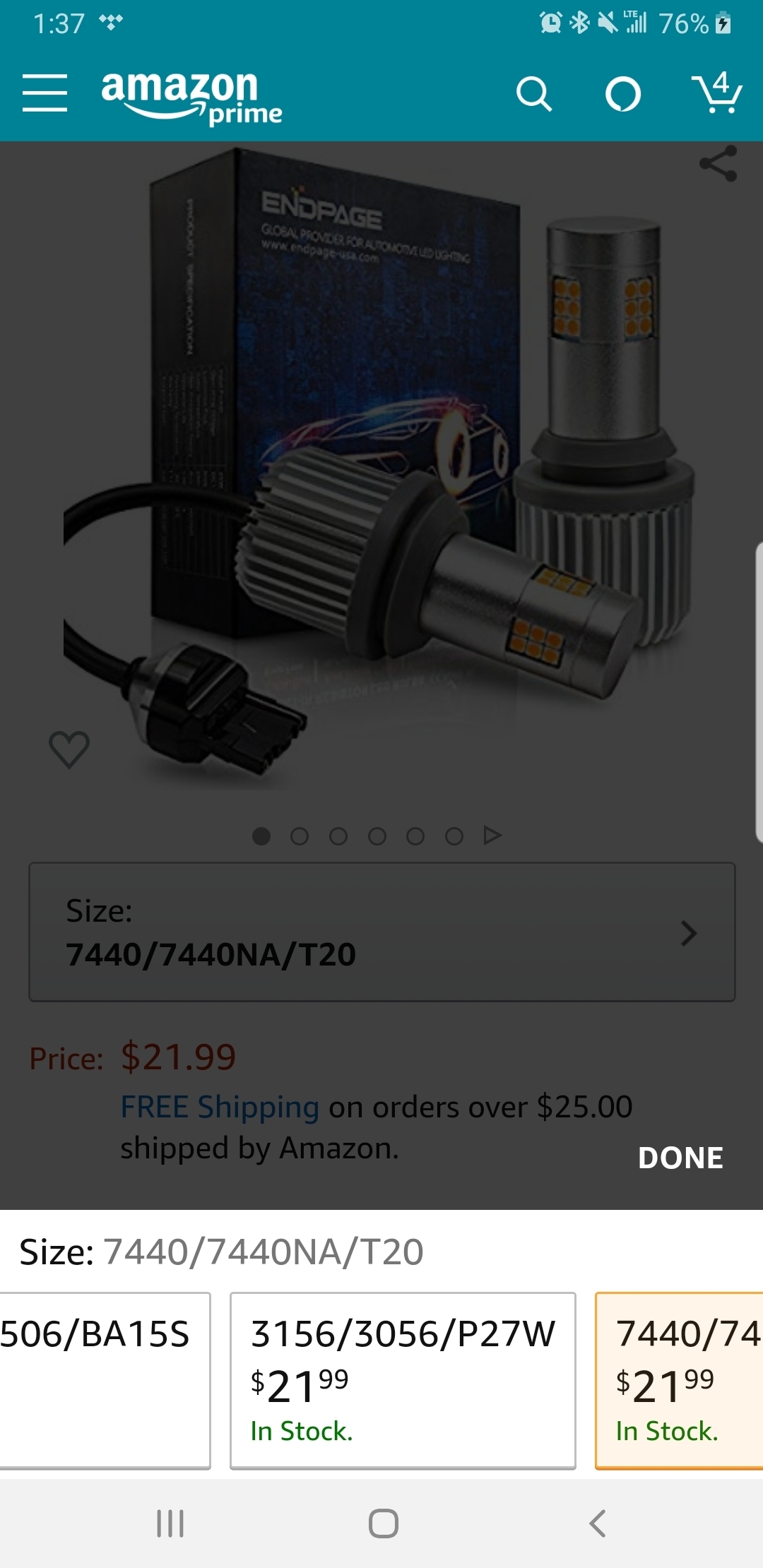

Would you know if these LED blinkers would work in the 2019 Honda insight hybrid and If so what size of the bulbs and will they even work in my vehicle?
Sep 29, 2019 at 10:08 AM

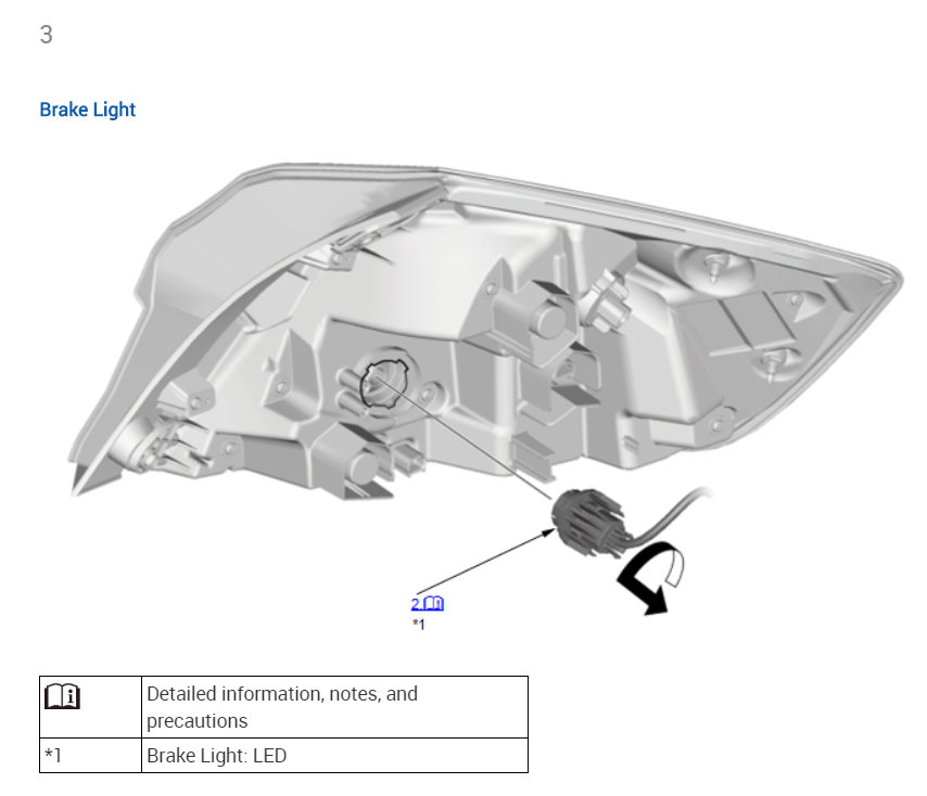

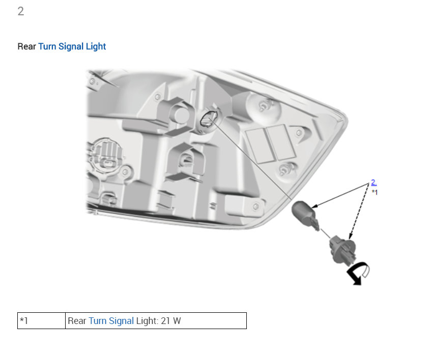

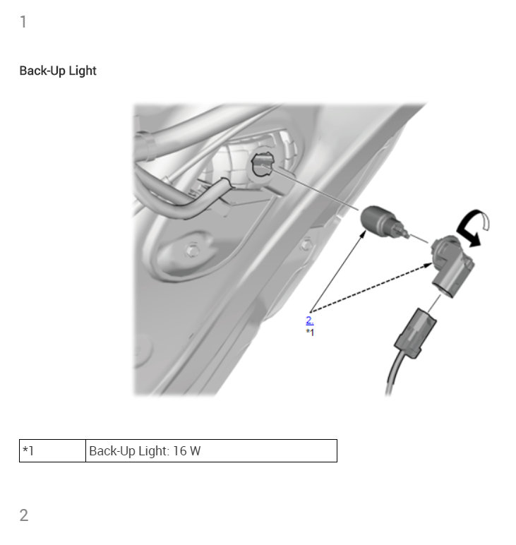

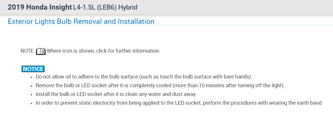

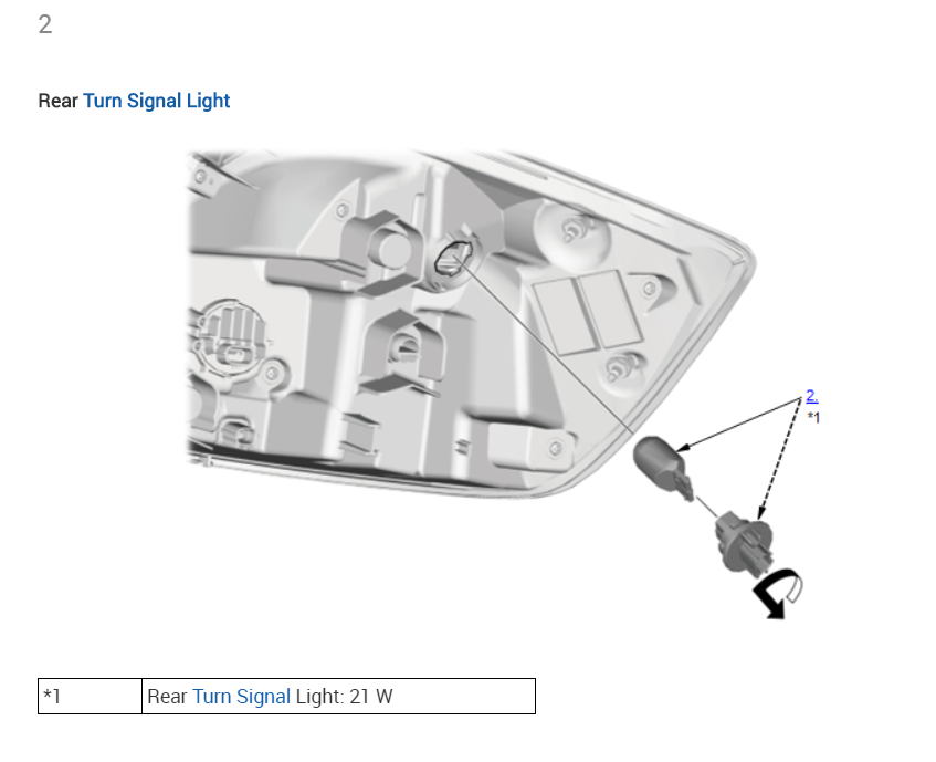

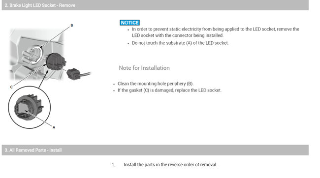

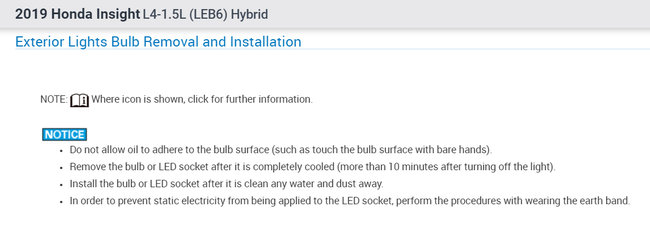

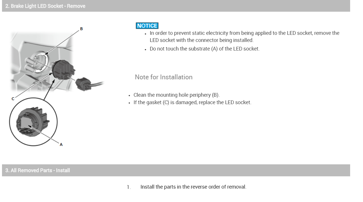

It says the bulbs are already LED. Here are the part numbers and instructions on how to change the brake light and running light bulbs which show the LED's:
12v16w - 33506S8RN51 $5.68
12v21w Amber - 33303SCK003 $6.23
Can you please shoot a quick video with your phone so we can see what's going on? that would be great. You can upload it here with your response. Check out the diagrams (below). Please let us know what happens.

What size of bulbs do I need and to do the ones from the Amazon link that I sent you work?
Oct 2, 2019 at 10:48 AM
Yes they look like they will work. Let me know how it goes.

Which size of bulbs do I need? They only offer 3 sizes.

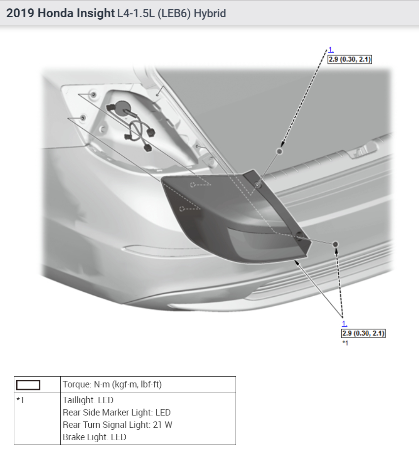

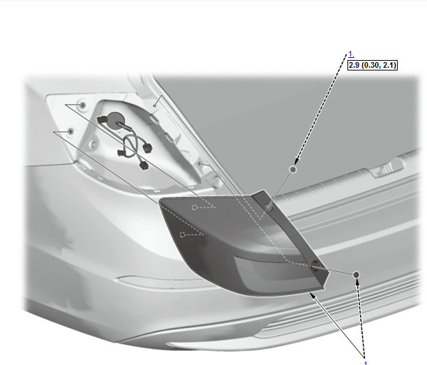

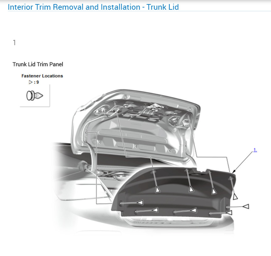

Here is an image below on the taillight assembly removal. When you remove the bulb give me the number and I can cross reference you an LED bulb number.Thanks again for using 2CarPros.

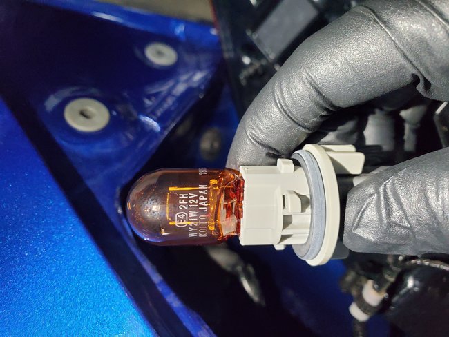

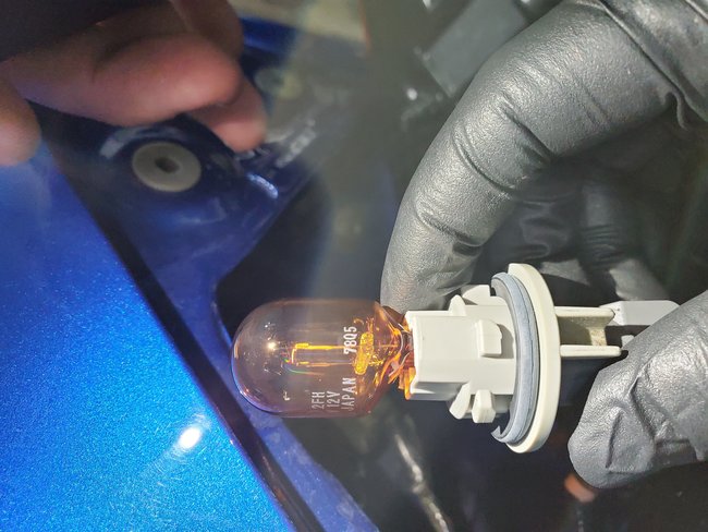

Hey there, sorry i am taking so long to respond, but i have taken the bulb out of my vehicle and it appears to be this size. i took two photos. could you see if there is any LED turn signal bulbs i can use to replace these normal bulbs that i currently have?

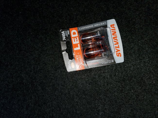

Okay, here is what I found out. Your bulb for the rear blinker is based off the part number 7440A . Sylvania does make an LED bulb available at any parts stores. I've attached the stock bulb and the LED bulb below. If you want to go off Ebay or Amazon like the pictures you included then you will have to base it of the bulb number 7440A as I stated . Hope this helps and thanks gain for using 2CarPros.
