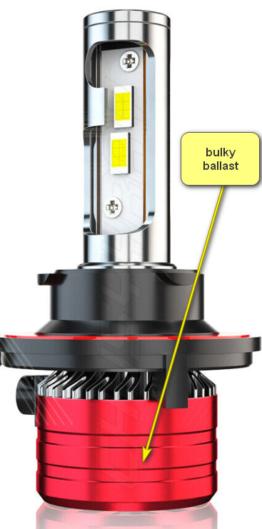

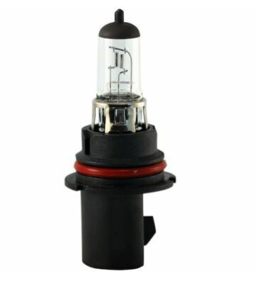

Please note that due to the bulky ballast setup of the LED headlight bulbs the rear headlight cover might no longer fit and then you might get water entry. See image below LED compared to standard bulb
