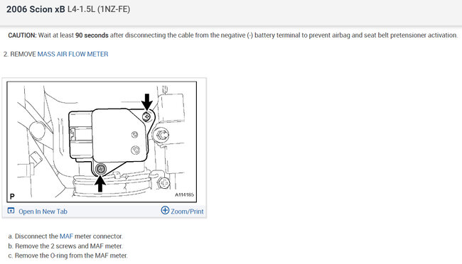

If not, I would replace the MAF sensor, cleaning it will not help at this point. Here is the correct way to do the job. Clear the codes once the job is completed. Check out the images (below). Please let us know what happens.
