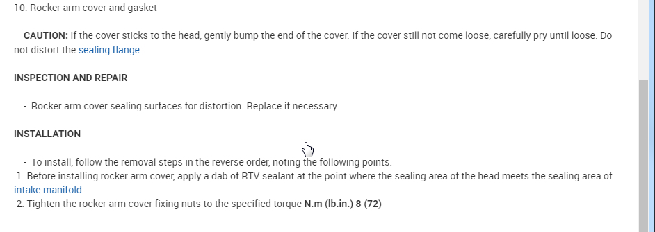

What is the fix for leaking valve cover gaskets?
Apr 10, 2020 at 5:24 PM

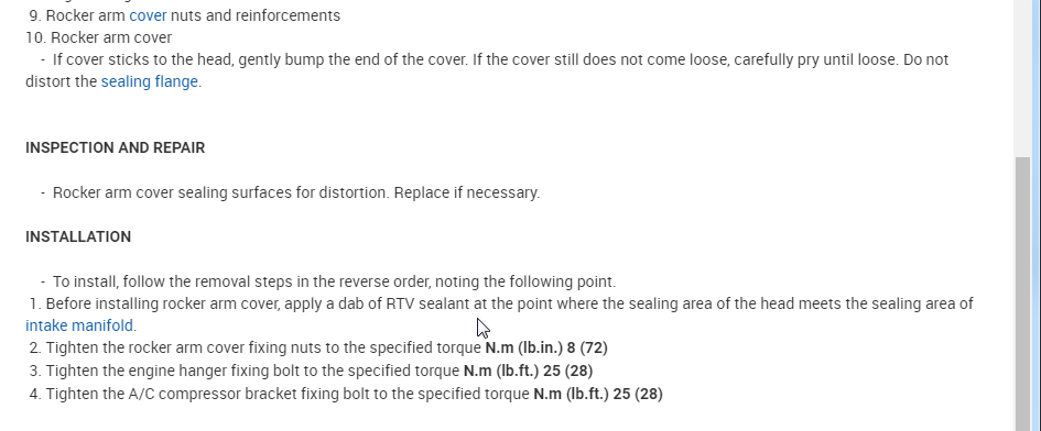

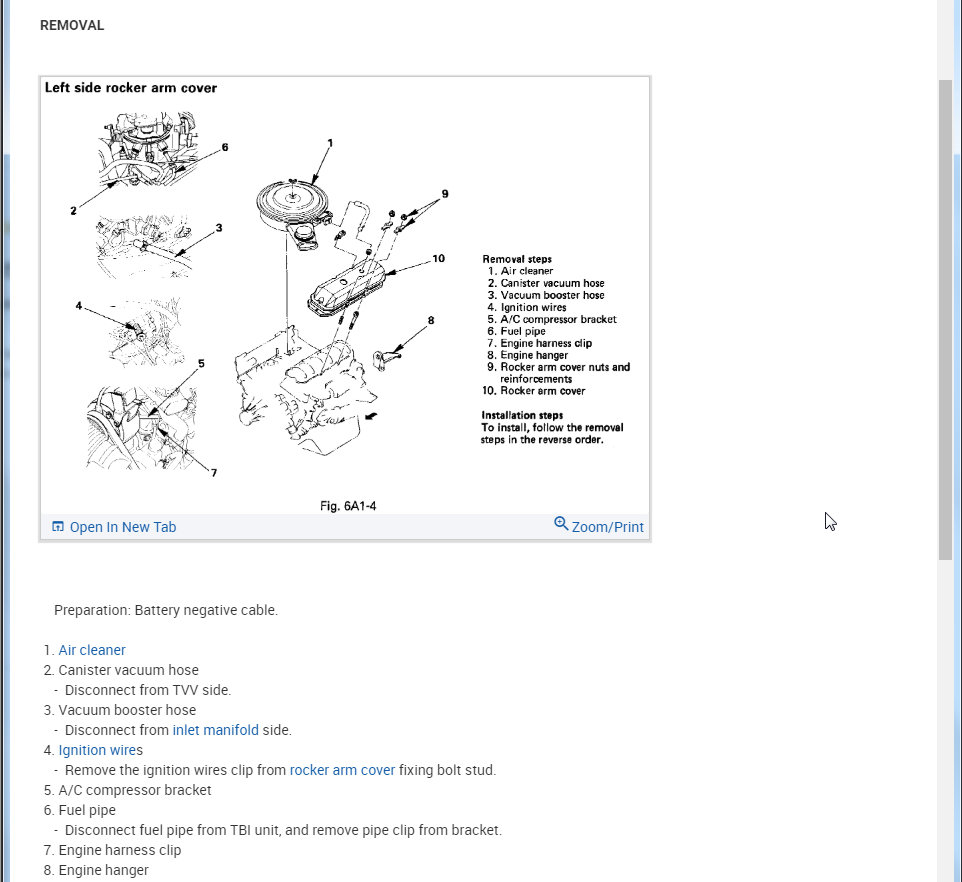

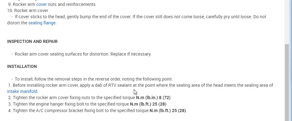

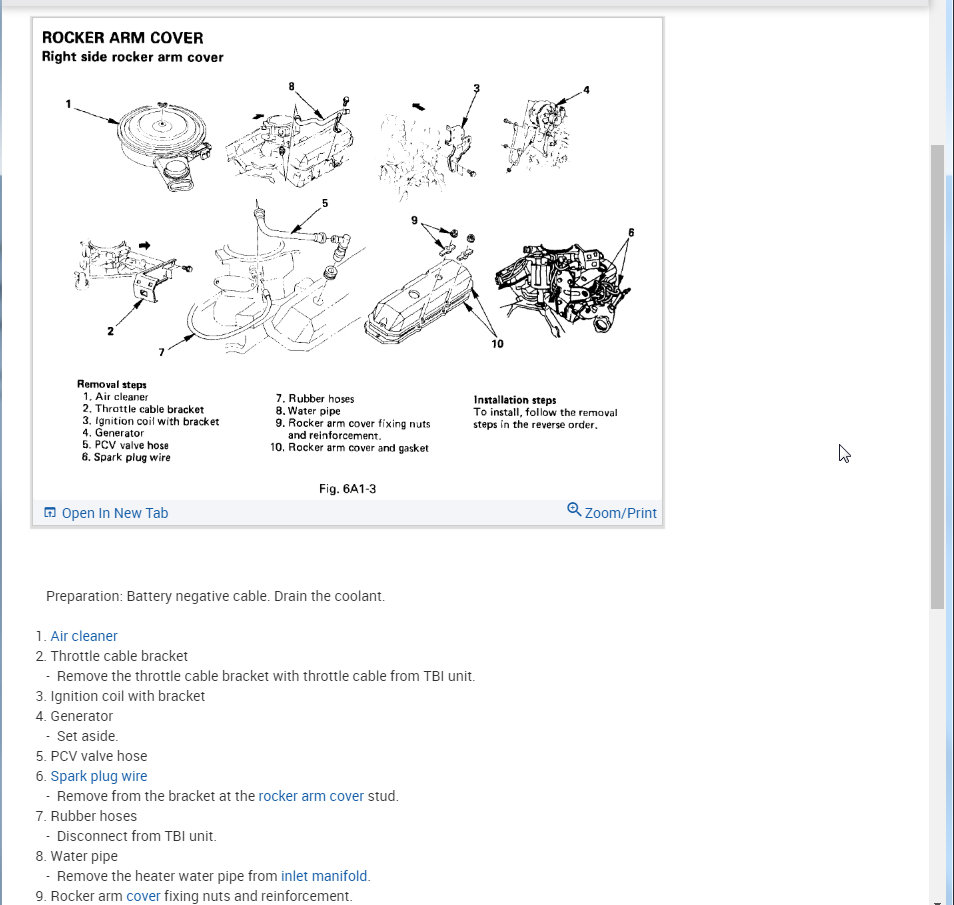

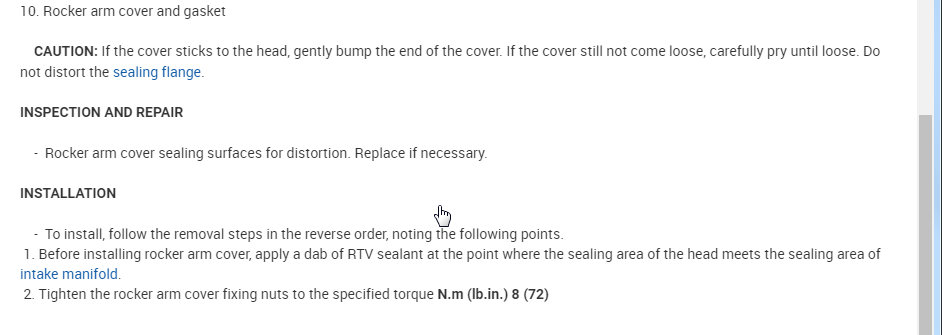

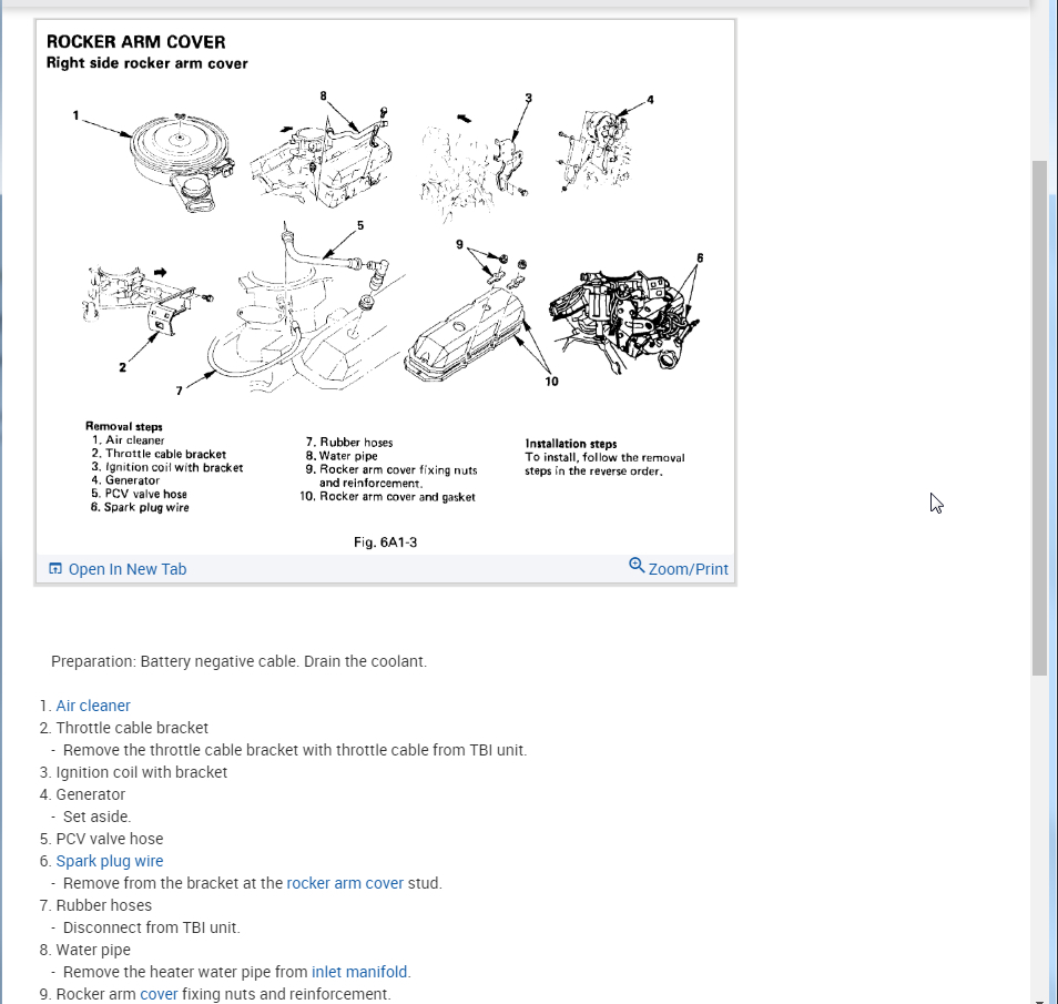

Unfortunately, the only repair is to replace them. Here is the process on how to do that. Let us know if you have questions. I included both sides because I am not sure which one is leaking. Thanks
