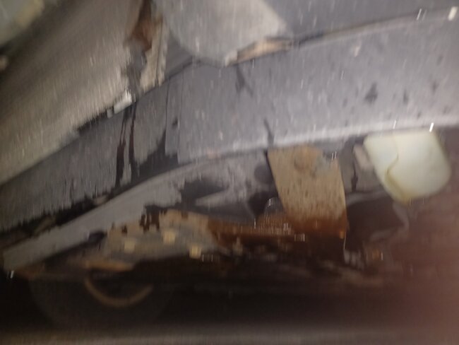

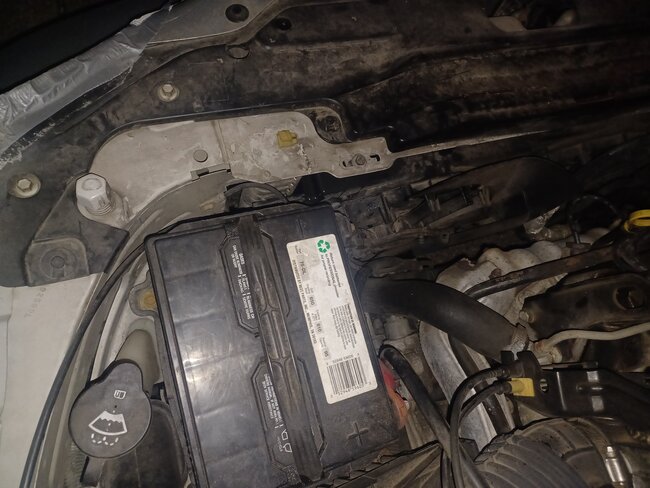

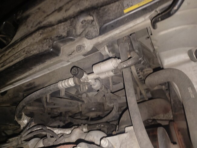

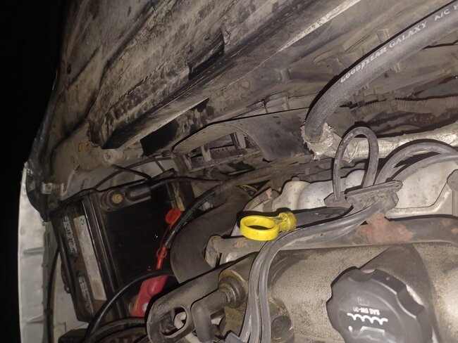

Every now and then my temperature gauge will start to creep past the middle mark, so I turn the heat on and usually stops. I keep an eye on antifreeze and everything, all good. No smoking or anything. Until last night. I was driving, the temperature gauge was normal but when stopped at a light I noticed smoke/steam coming from under the hood on the driver's side opposite of where the reservoir tank is. So turned the heat up, stopped smoking while driving but started again while stopped. Make it home and pop the hood and there's water everywhere on the driver's side. On the radiator even the front tire. Antifreeze a little low but nothing feels hot except a radiator hose which isn't leaking or anything. But I have had problems with the fan not coming on before. Sometimes I have to turn on the air first before the heat just to make sure the fans are working. Can the fan not coming on make it spray water like that but not make the temperature gauge go up?

3.4 L. So, I'm almost positive it's coming out of the radiator hose bit there's no holes and clamp is fine it's just being pushed out when it gets hot because the fans aren't coming on. So I should start with the fuses and relays before I make any big repairs, correct? I switched some of them around yesterday to check them and the fans came on for a bit but back off now.

Also, it looks like straight water...not antifreeze. But there's plenty of antifreeze. When it does get hot there's a lot of water on my left front tire but also directly under the radiator.
