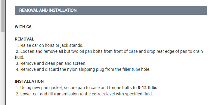

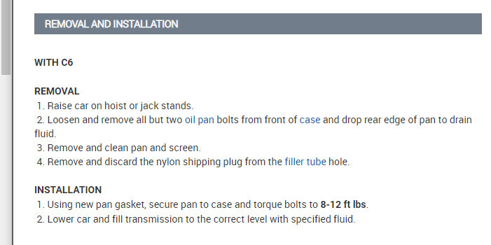

i have the van listed above and it has been sitting for about a year. i notice that i have a bad transmission leak going on. could it be that the pan gasket rotted away or a front main seal? i need to get under it and see where the leak is coming from. Help!
