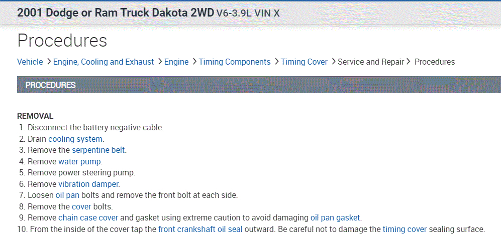

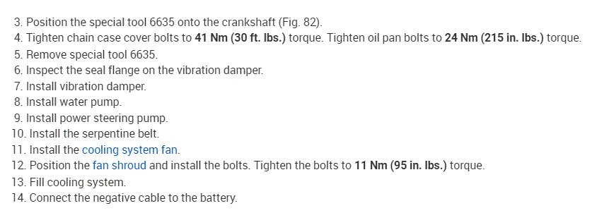

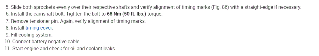

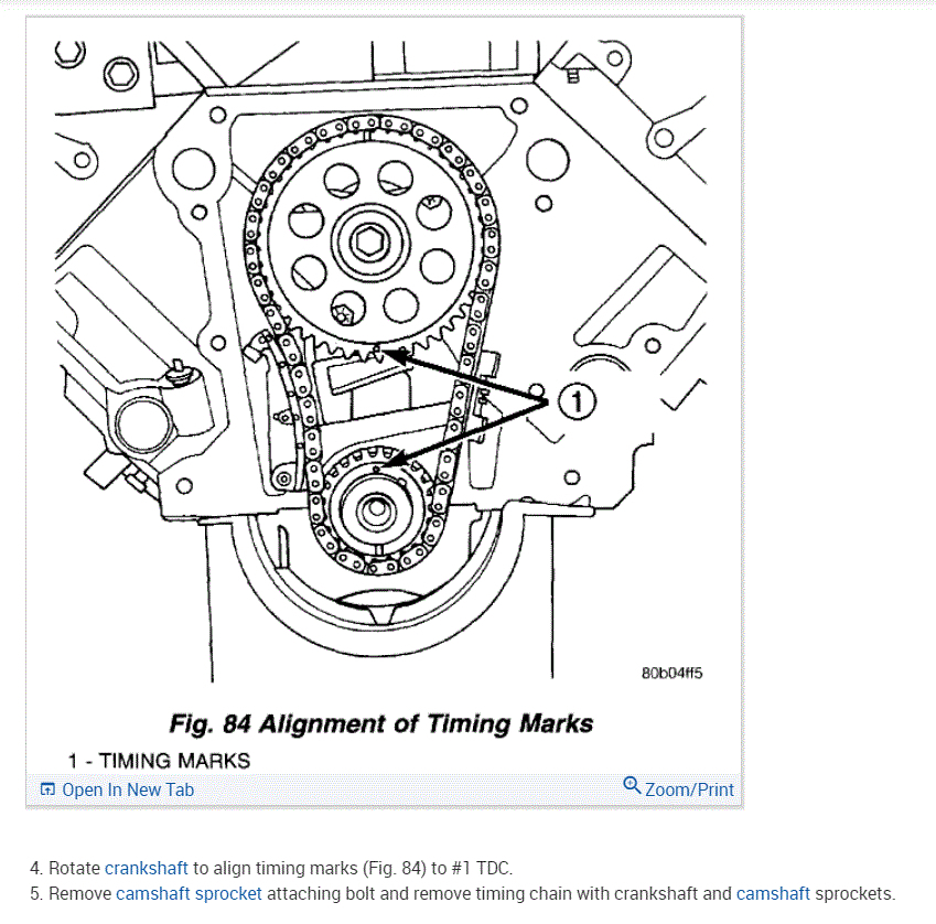

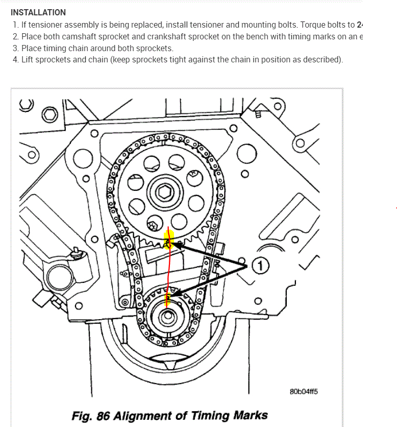

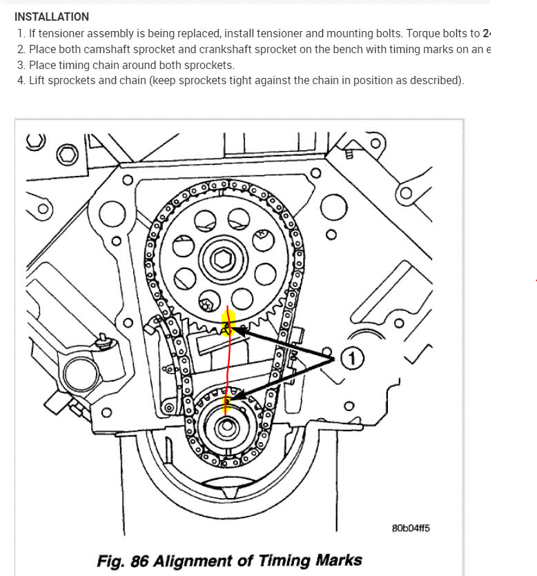

On this vehicle, it is really easy. Once the cover is off, there are only two sprockets to deal with, the crank pulley and the cam pulley.
The timing marks are really simple as well. The camshaft mark sits at 6 o'clock and the crankshaft mark sits at 12 o'clock.

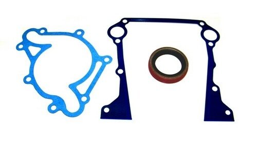

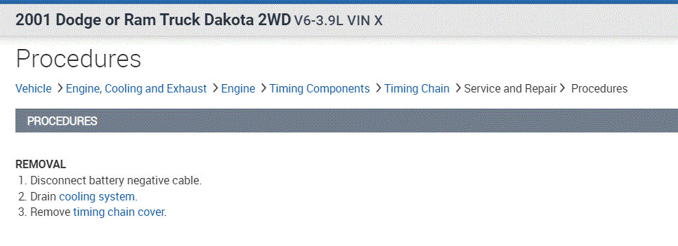

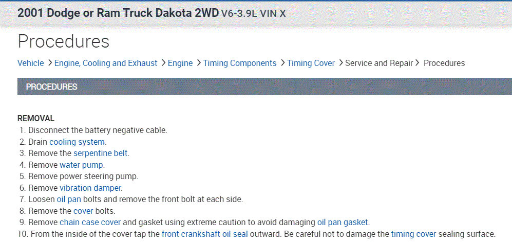

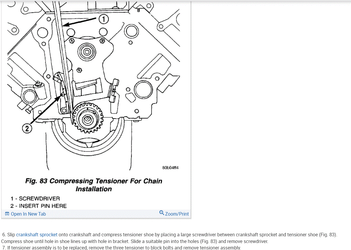

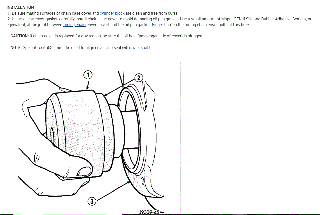

If you do it, replace the tensioner as well. I attached the directions below.

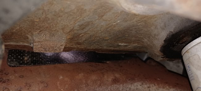

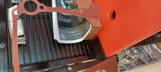

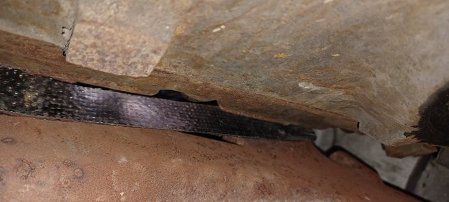

See pics below.
