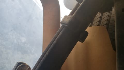

Hi, I can move the rear suspension up and down together. I can bend the leaf springs by hand. Maybe the springs themselves or the shackle is the issue? No noise while driving, but I can move it up and down with weight on the vehicle.

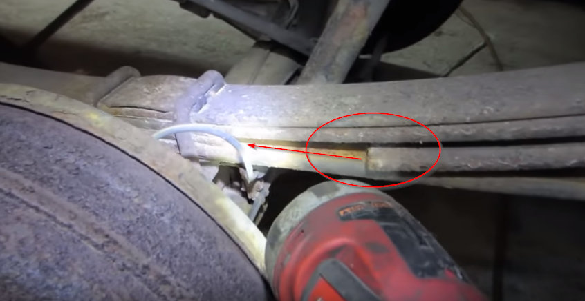

Do both sides do this? Clearly the spring should feel solid and not move much at all so I suspect it is broken at some point. You want to inspect the entire pack and see if you can find where it is broken. I attached a picture of a dramatic case but it will be the idea.
The shackles there that you mentioned in your other post are only intended to keep the leaf springs from fanning out so they are not the issue.
Thanks again for getting this new post started. I understand it may seem silly but the internet search engines actually punish the websites when they are not separated out like this which is why we require it.
Let me know what you find and we can go from there. Worse case, I would go to a salvage yard and get a new leaf spring pack.

Both sides do it, yes. I noticed one side I can grip the spring pack and compress with my hand , and another pack stays compressed, no movement.

I think that is a lot of movement. The clamps are what caught my eye.
It almost looks like it is missing a leaf. How old are the springs?

Roy I thought the same thing. They are from a 2011 Ford truck 320,000 miles, but they both have the same number of springs, just one moves in the clamp, the other does not.
Mar 20, 2020 at 3:02 PM
I watched the video again. I honestly see nothing out of the ordinary. The clamp may have stretched which I have see many times. The axle is pulling down on the leafs, so when you pull upward, they will move easily. What are your thoughts, Roy?
