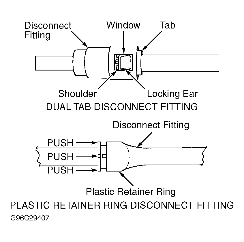

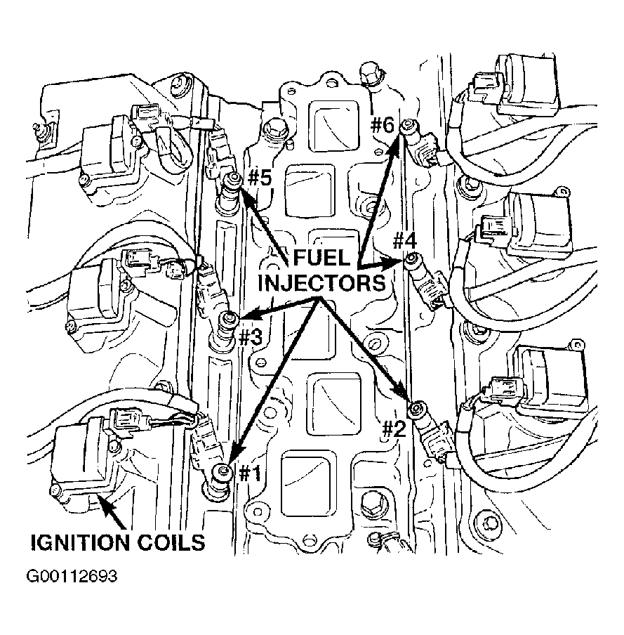

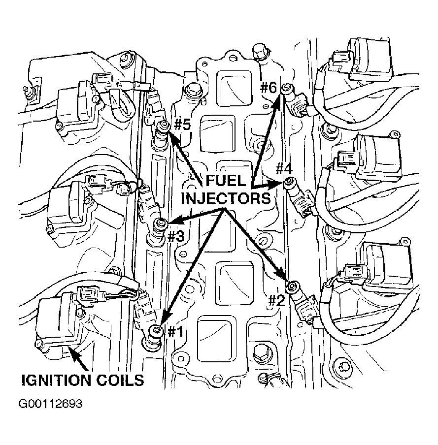

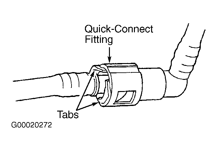

I have attached pictures of the quick connect fittings to the fuel rail. It is easy to damage the o-ring in it when putting it back together. It should be lubricated with a small amount of oil before reconnecting. Also, when you reconnect it, you should hear a click. Take a look at the pictures. The last picture is of the tops of the injectors where they attach to the fuel rail. You should always replace the o-rings and the injector should turn smoothly in the rail.
I hope this is helpful. Let me know if you can determine where the leak is coming from. Since it is running down the back of the engine, I suspect it is the supply line and when you reconnected it, either the connector did not fully engage or the o-ring is damaged.
