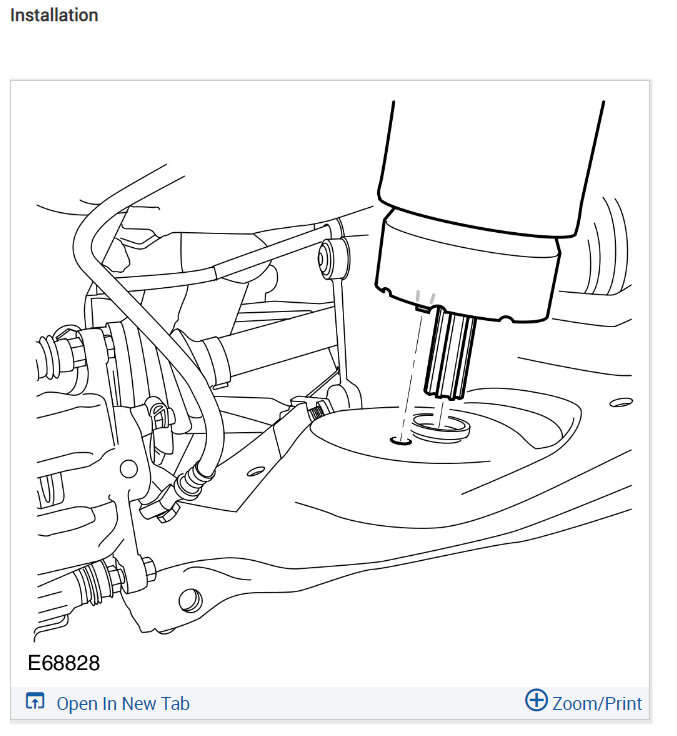

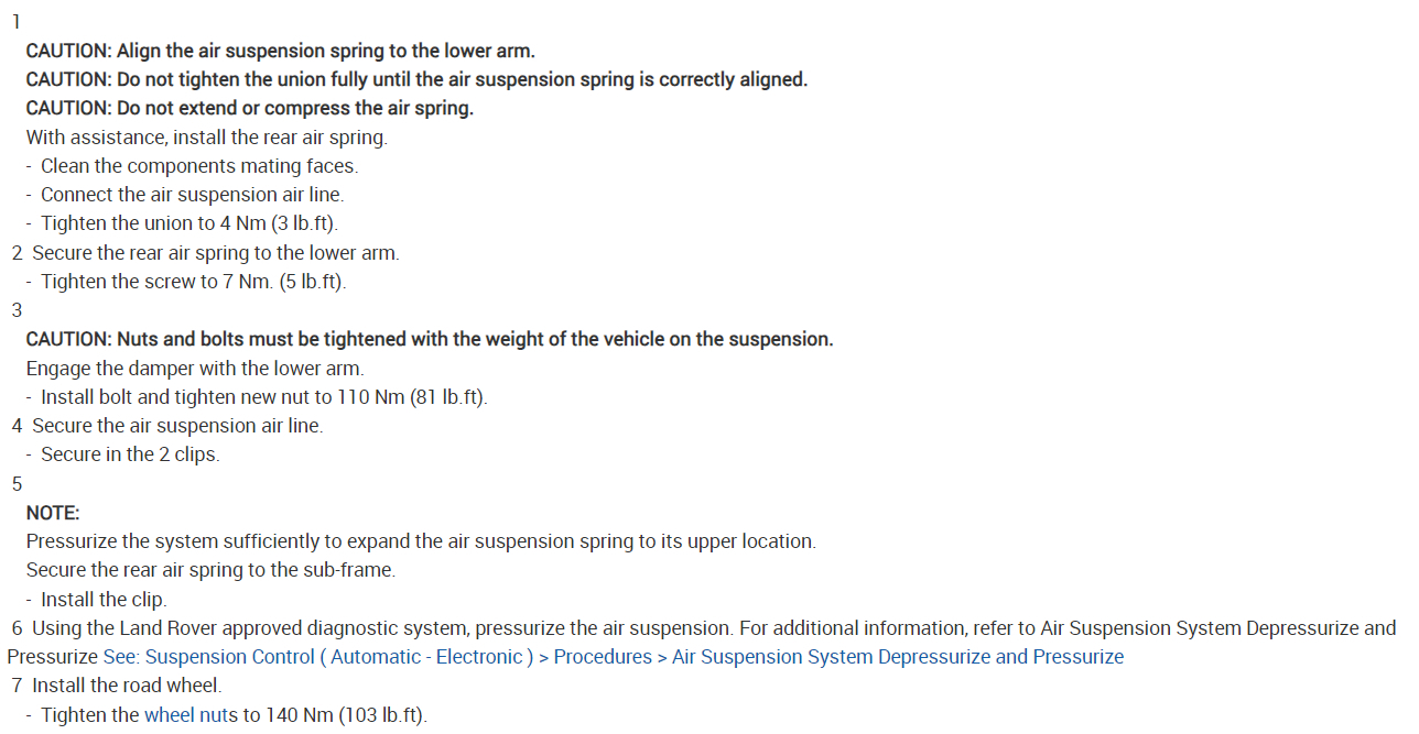

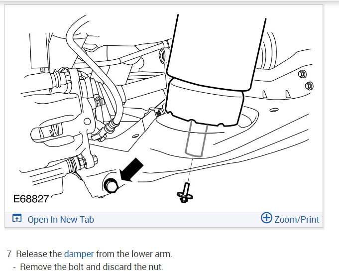

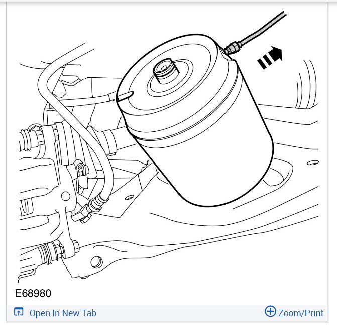

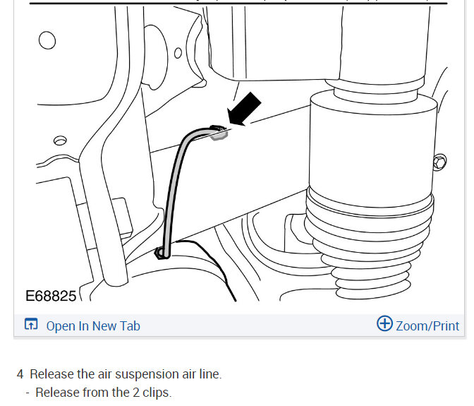

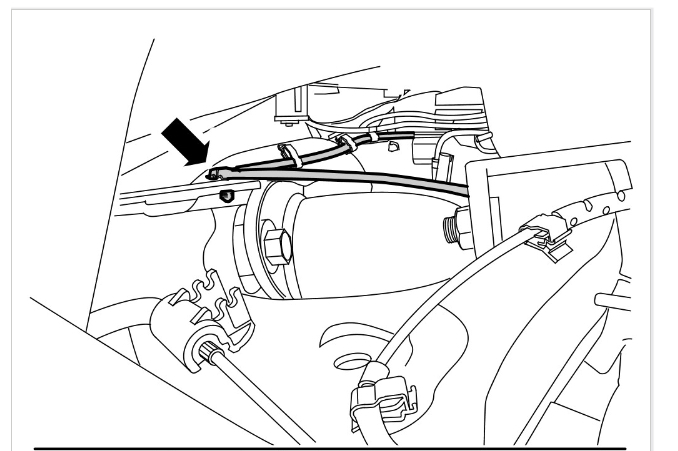

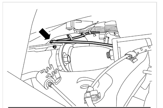

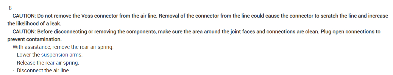

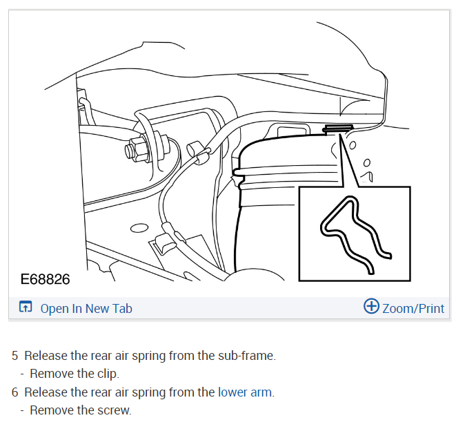

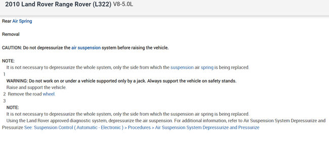

This happens when one of the rear shocks has a leak which is super common. Here is how to change them out, FYI these are a normal service item. Check out the images (below). Please let us know what happens.
