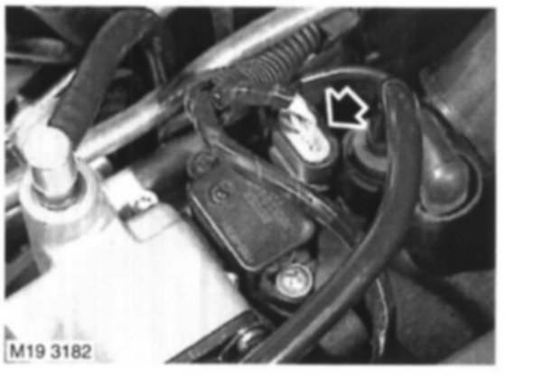

this is a classic problem with the MAP sensor. What happens is the sensor becomes contaminated which hinders its ability to read correctly. Here is a diagram (below) that will show you what you are in for when replacing this sensor along with the guide on general misfires.
https://www.2carpros.com/articles/engine-misfires-or-runs-rough
Please let us know what you find.
