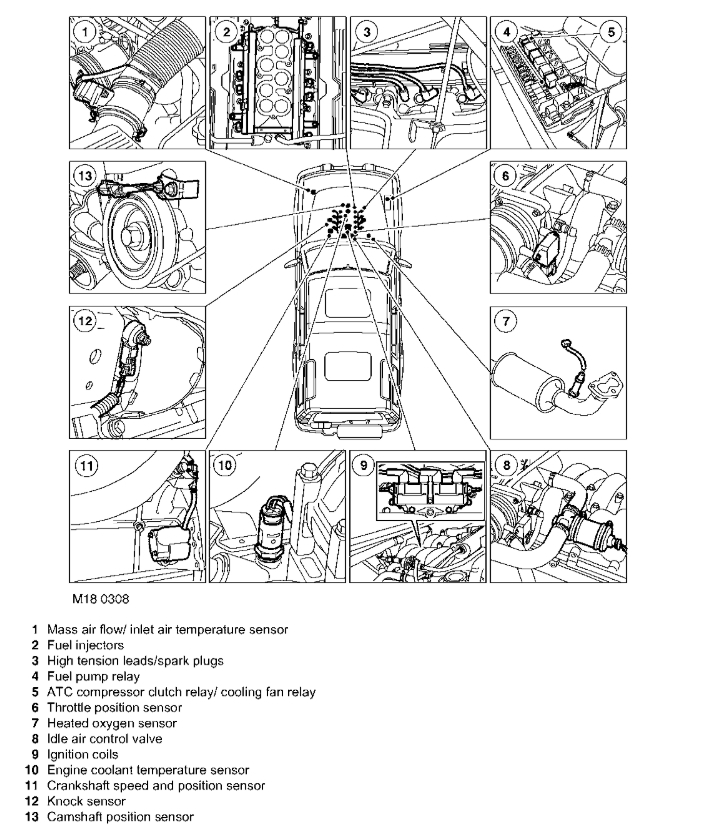

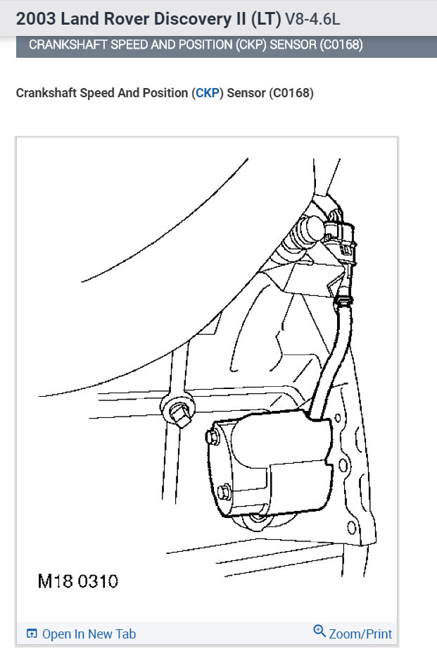

When you turn the key to the on position without cranking the engine over can you hear the fuel pump run in the tank for 5 seconds? If so it sounds like you have a crankshaft angle sensor that is not working correctly. Here is the location so you can check it out in the diagrams below. Check out the diagrams (Below). Please let us know what you find. We are interested to see what it is.
Jan 5, 2010 at 3:19 AM
TOMMY468
Yep, the crankshaft sensor connector was shot! I had to get a new pigtail and I get a new sensor since I was doing the job anyway.
