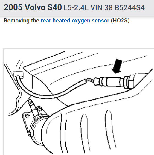

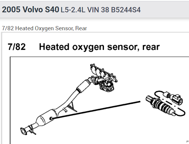

Hi looking location for rear lambda sensor on my car. Got a diagnostic done told me lambda probe two bank one.
Got this confirmed as rear sensor not the first one on the manifold. Is it on the exhaust after the catalytic converter or before?
Many thanks
