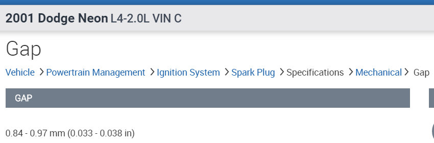

Hello again,
Okay, can you confirm the spark gap for me on your spark plugs? And does your vehicle have a coil pack/spark plug wires, or does it have Coil On Plug (COP) coils(each cylinder has it's own coil)? I have included the correct spark plug gap in the diagrams below.
Thanks,
Alex
