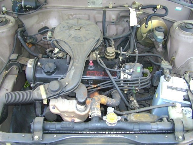

Does this look like your engine? If yes and it has the same air cleaner housing, check to be sure the temperature flap is opening fully, If it still has the tube going to the fender liner, check all of that for blockage.
