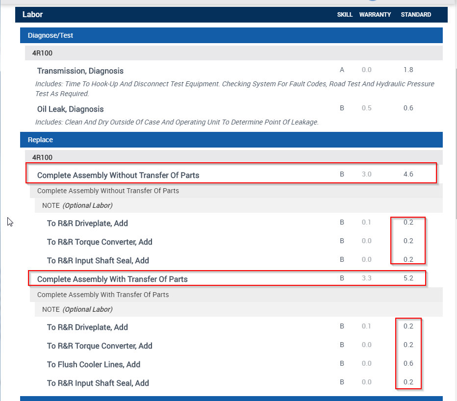

I have a 2001 Ford E450 Super duty retired ambulance that needs the transmission replaced. How many labor hours should it take to do this? Thanks.
Aug 8, 2020 at 6:07 PM
I attached the info for this as requested. Basically it looks to be around 5.5 hours, all in.
Let me know if you have more questions.
Aug 8, 2020 at 6:12 PM

Thank you. That is extremely helpful.
