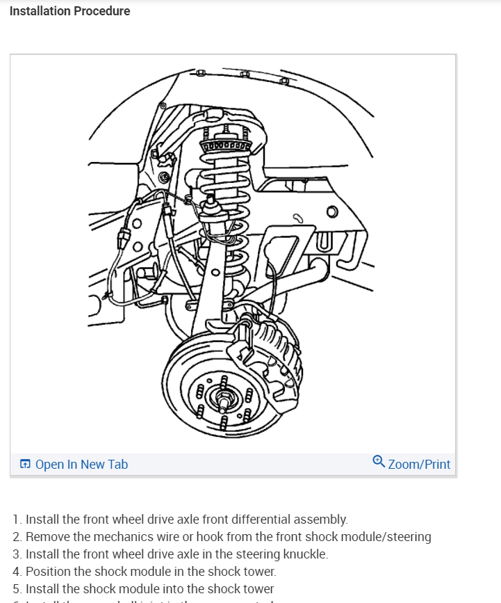

How many hours would it take to remove/replace front axle assembly. Can I get instructions?
Mar 13, 2022 at 12:51 PM
CERTIFIED EXPERT
53,854 POSTS

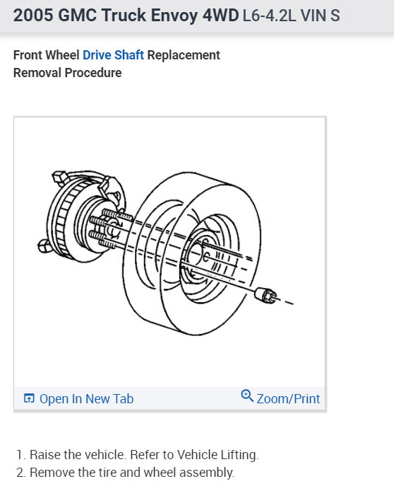

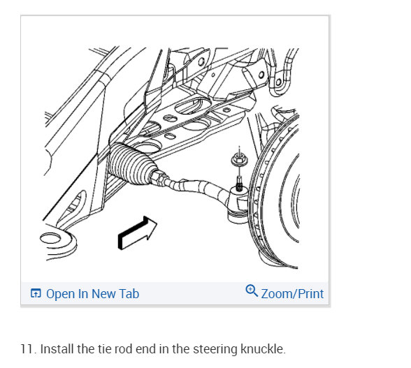

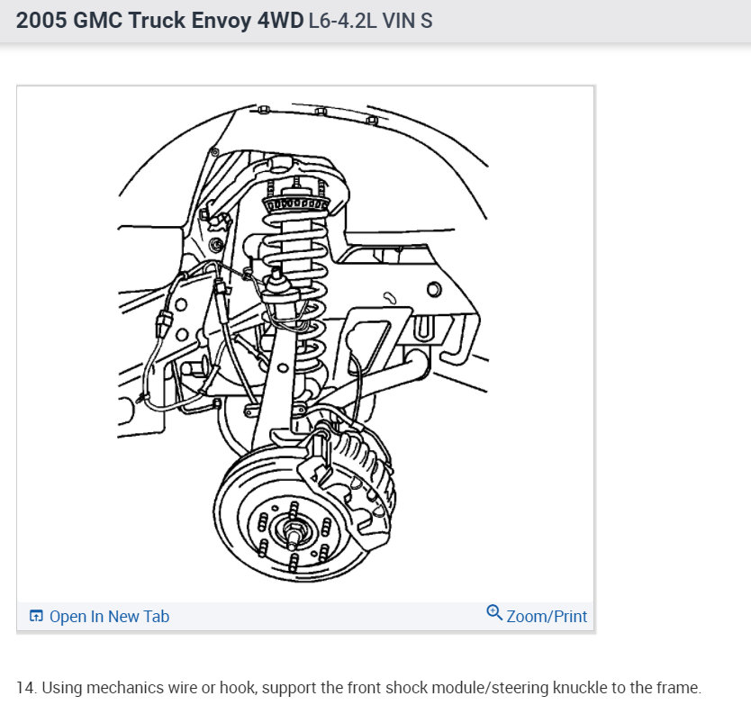

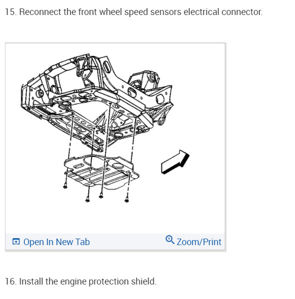

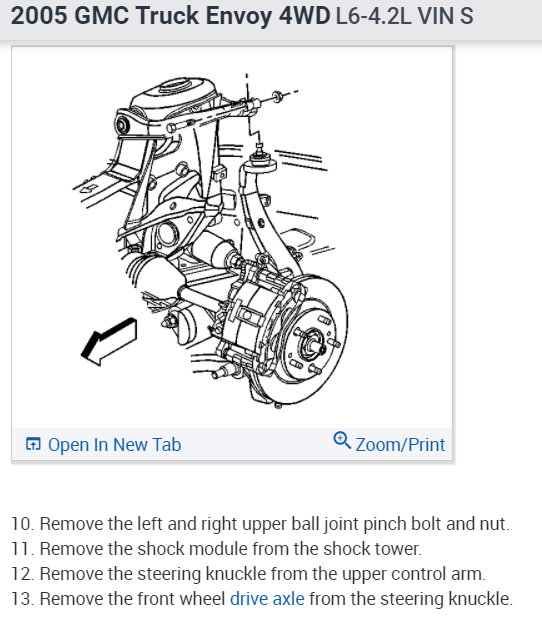

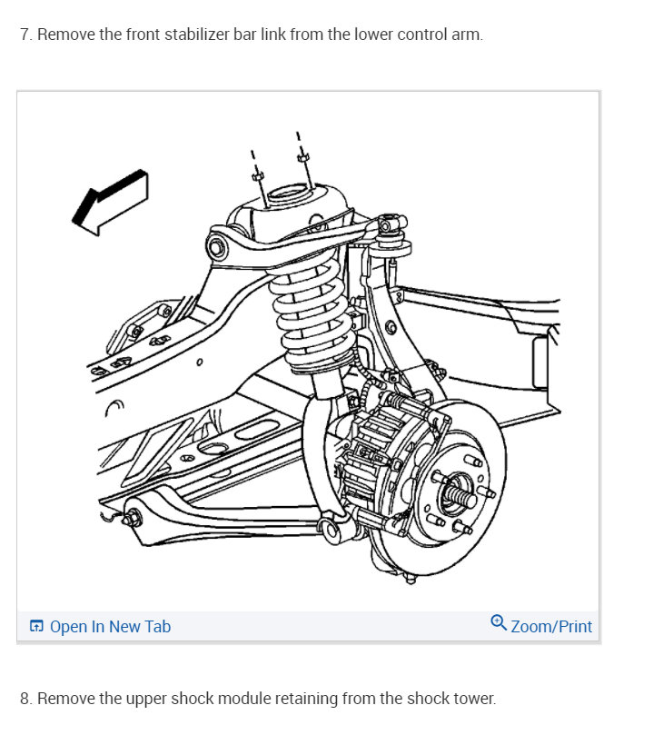

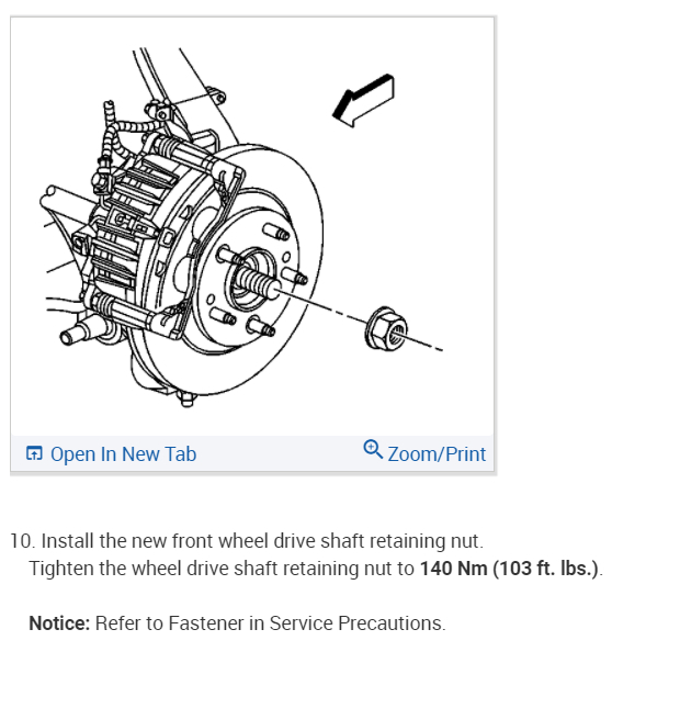

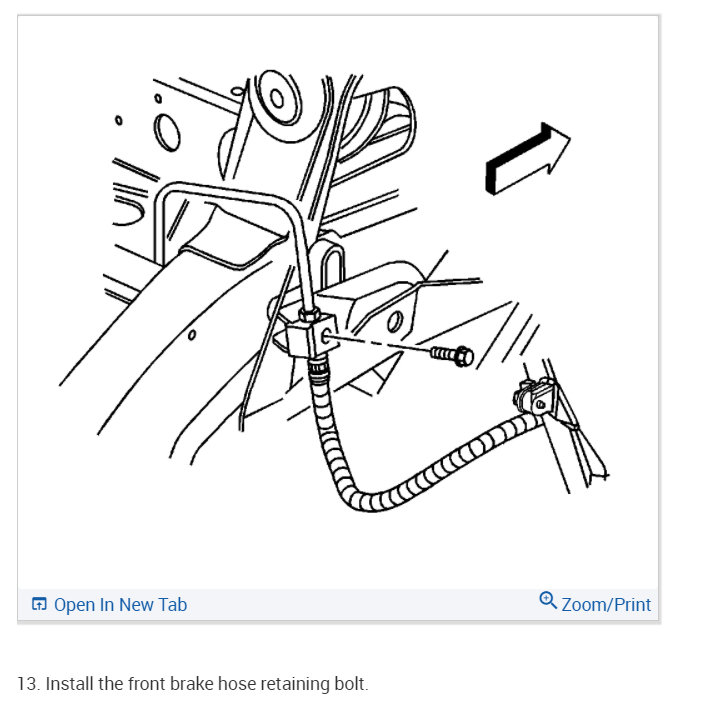

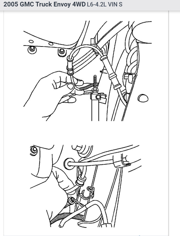

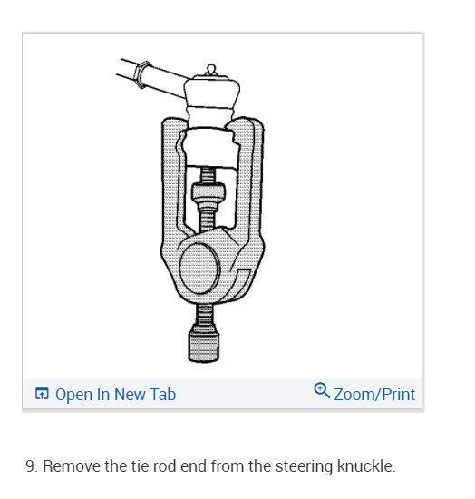

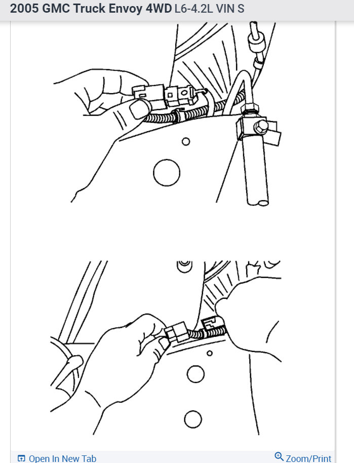

Here are the labor costs and the directions to do the job:
One Side 1.3
Both Sides 2.3
You will need to jack the car up here is a guide for that
